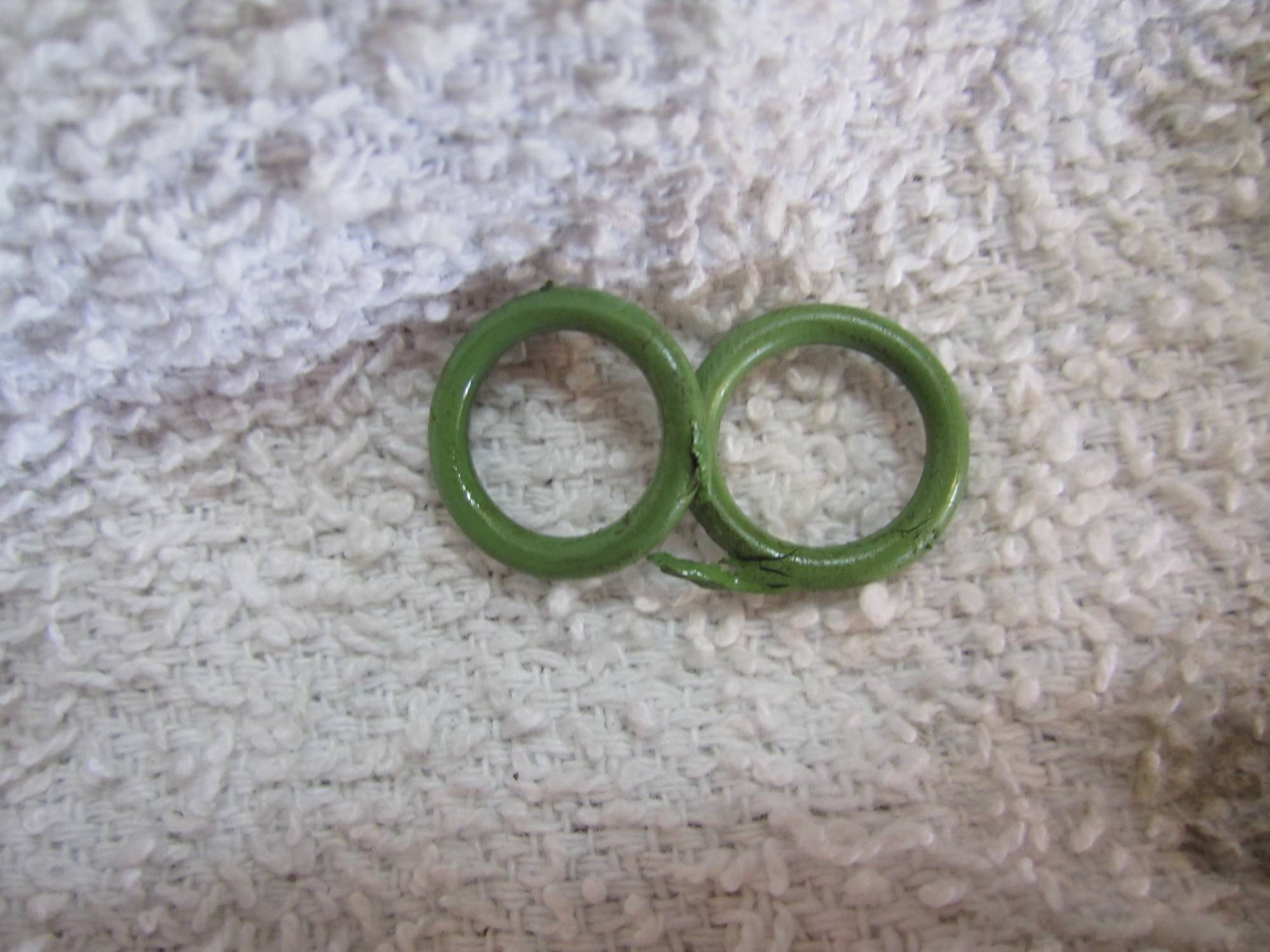

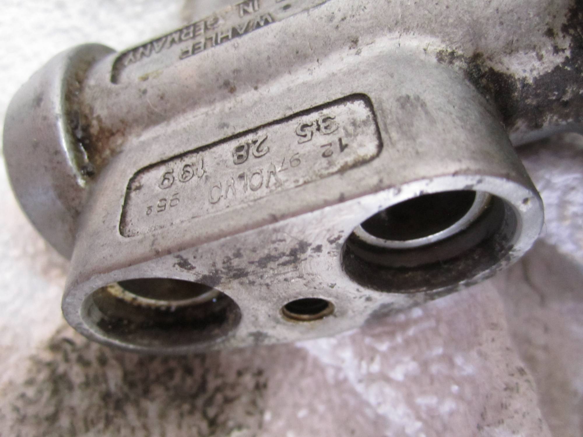

I found some pictures of the oil cooler thermostat issue I had. Not great pictures but will give you and idea of the issue:
Engine Oil cooler pipe seals at thermostat
These were brand new 2nd set of oil cooler pipe seals fitted by the dealer. They were shredded by hard old oil deposits
Dried hard oil residue
Not a great picture, but you can see the hardened ring of old oil that was shredding the new seals.
I removed the oil thermostat and carefully scrapped the old oil deposits out with a sharp metal edge taking care to not score the seats for the seals.
Also reversed the clamp after straightening with a hammer.
