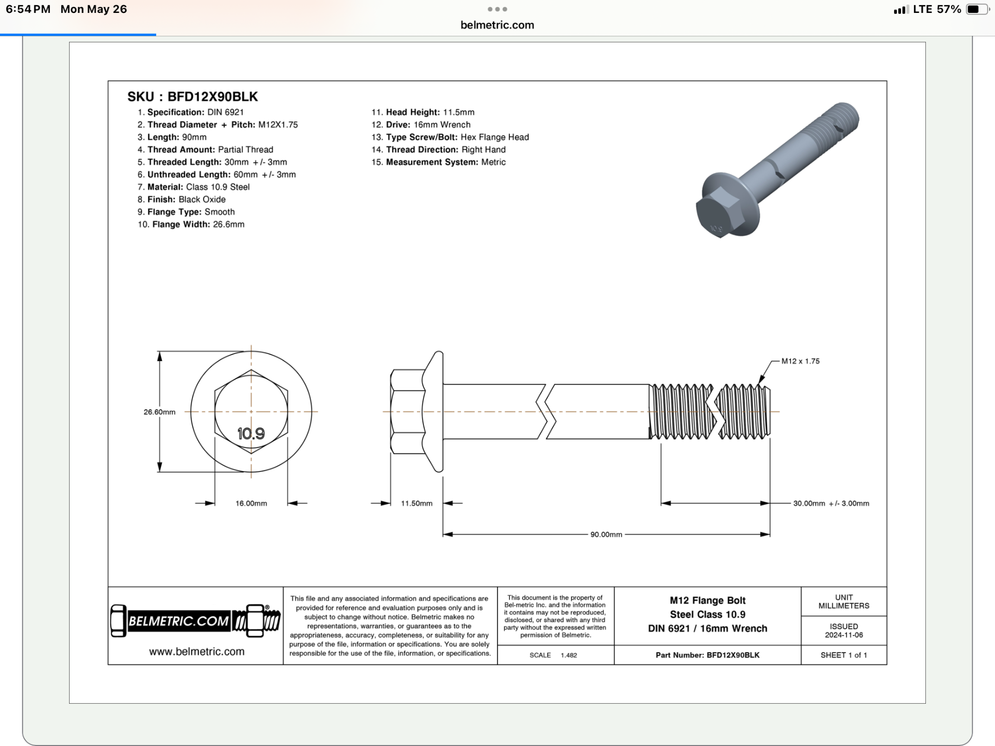

If someone has a spare eccentric bolt for the P80 AWD panhard strut please put the M12 x (length) measurement in this thread...

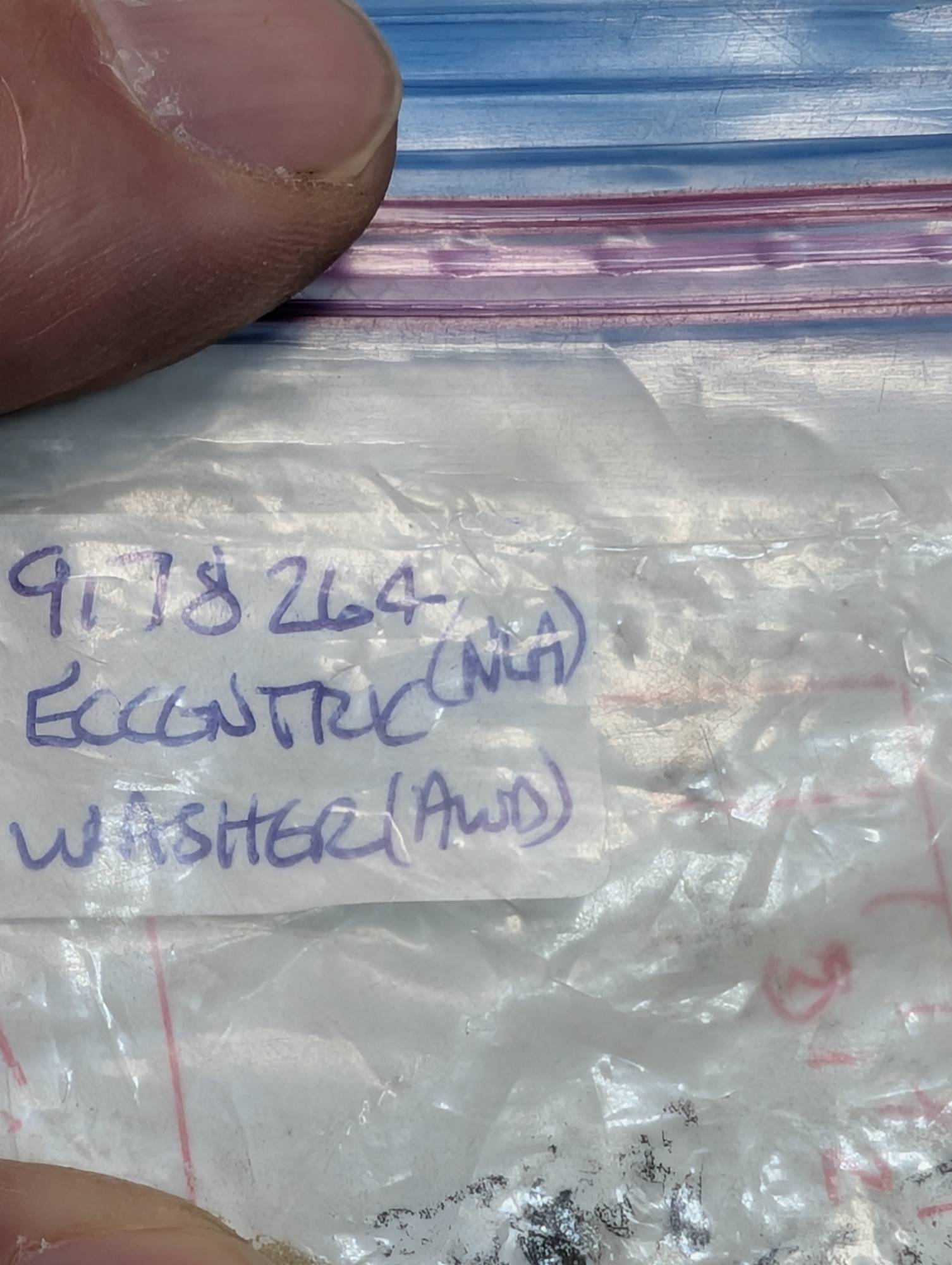

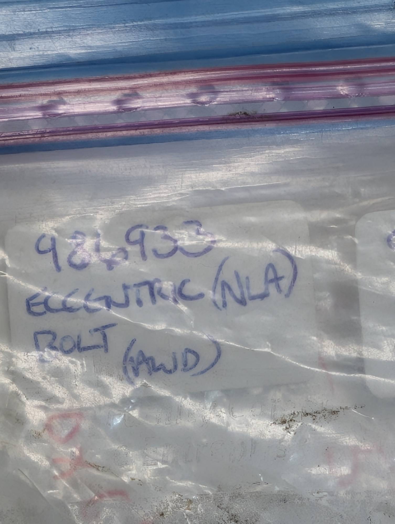

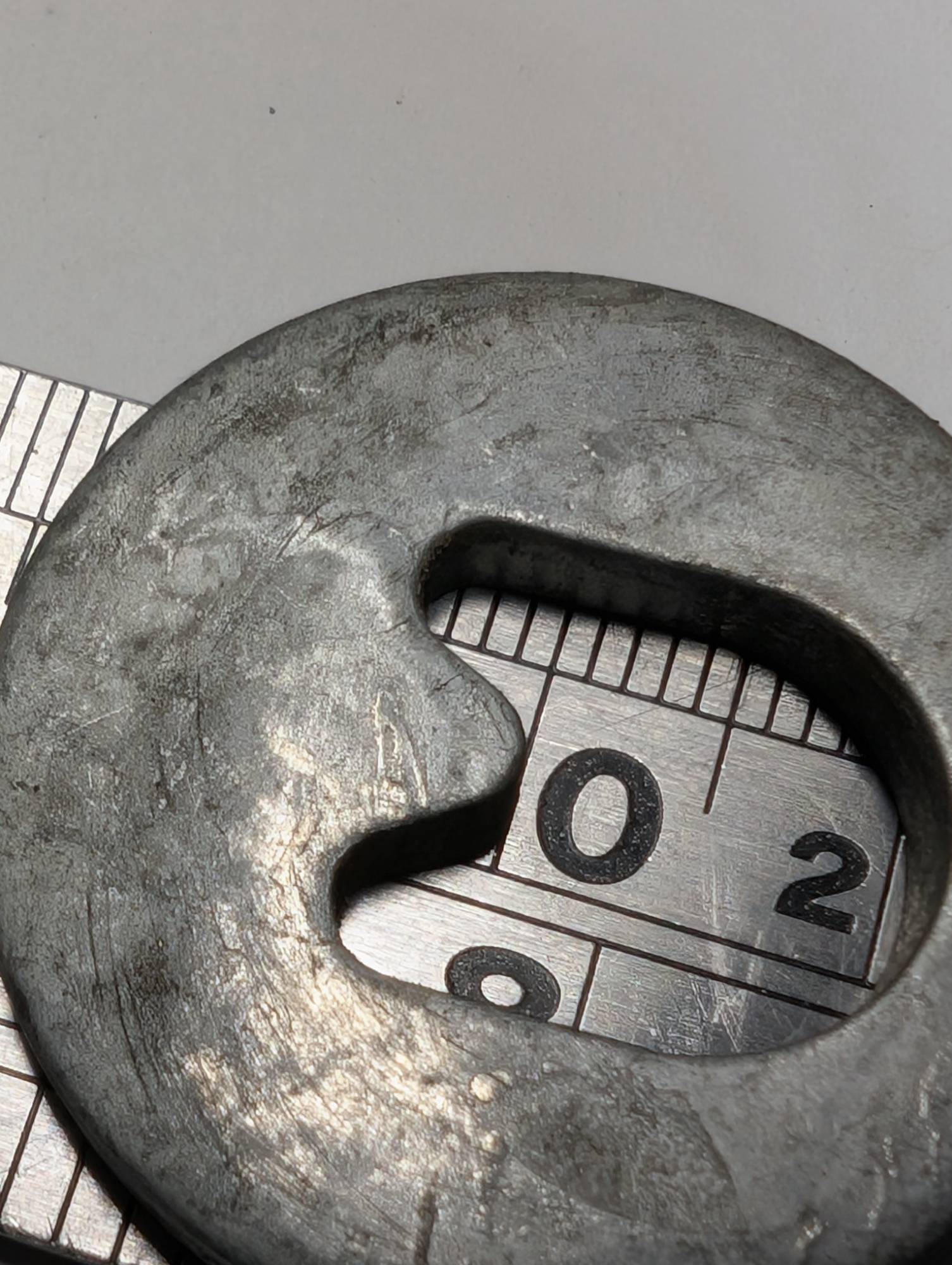

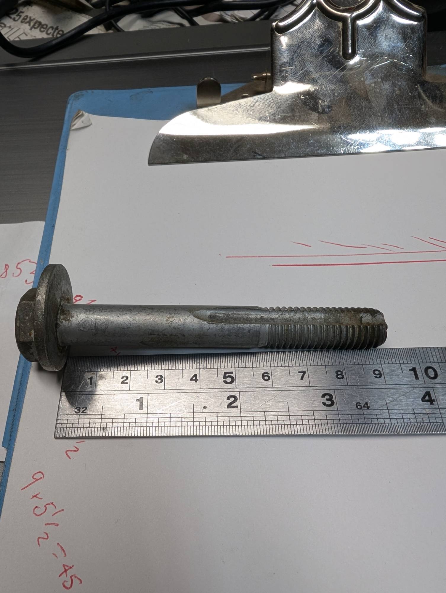

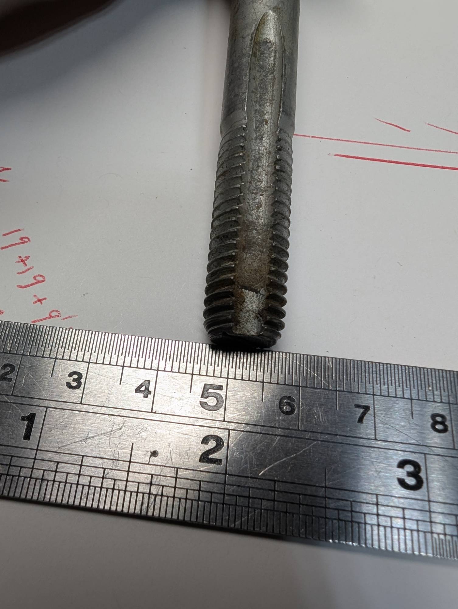

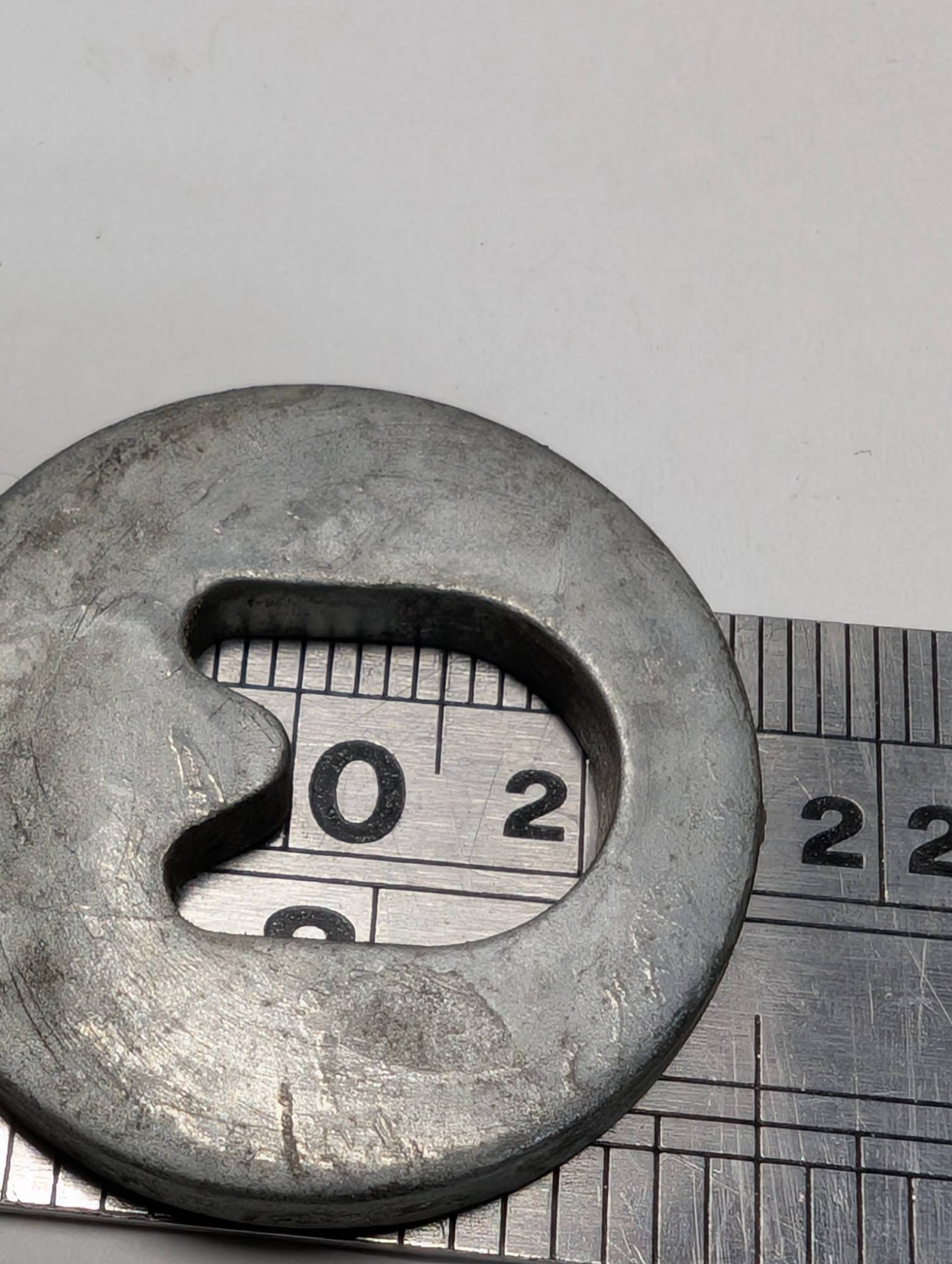

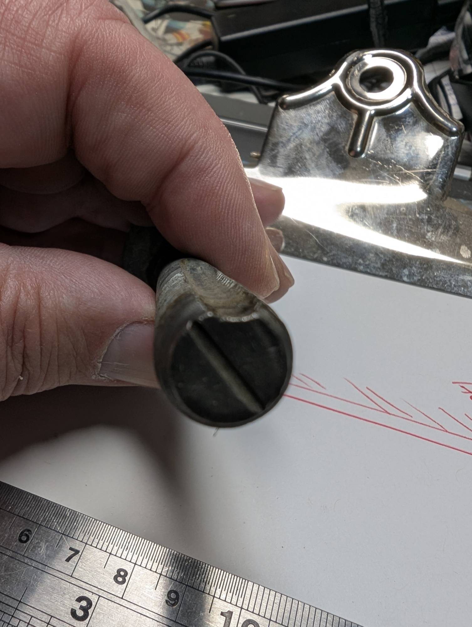

Apologies for the delay in getting this info. I have a parts inventory spread sheet. This only works when you put parts back in the correct place after a previous conversation on this issue!
This was also thwarted by my back up plan of bolts being in the panhard rods I had spare. These have gone to my mechanic buddy for his 850 AWD due to seized bolts!
Parts now located, pictures taken and returned to correct location!
Pictures below and hopefully of help for this project. If you need any more help, let me know!
Note, 90mm to the bottom of the washer, NOT the underside of the head!
Tried to show slot width for the washer 'tooth'. Approximately 3.5mm, but best figured out with a washer.
Slot profile.
Trying to give a reference for the washer dimensions
Tooth height
Bolt part number : 986933
washer part # : 9178264
Hope this helps the project!
Slot profile.
Tooth height

Okay, I’m thinking by this bolt and notch it for the toothed washer.
Epoxy washer to top flange, and use regulation washer and nut on bottom
