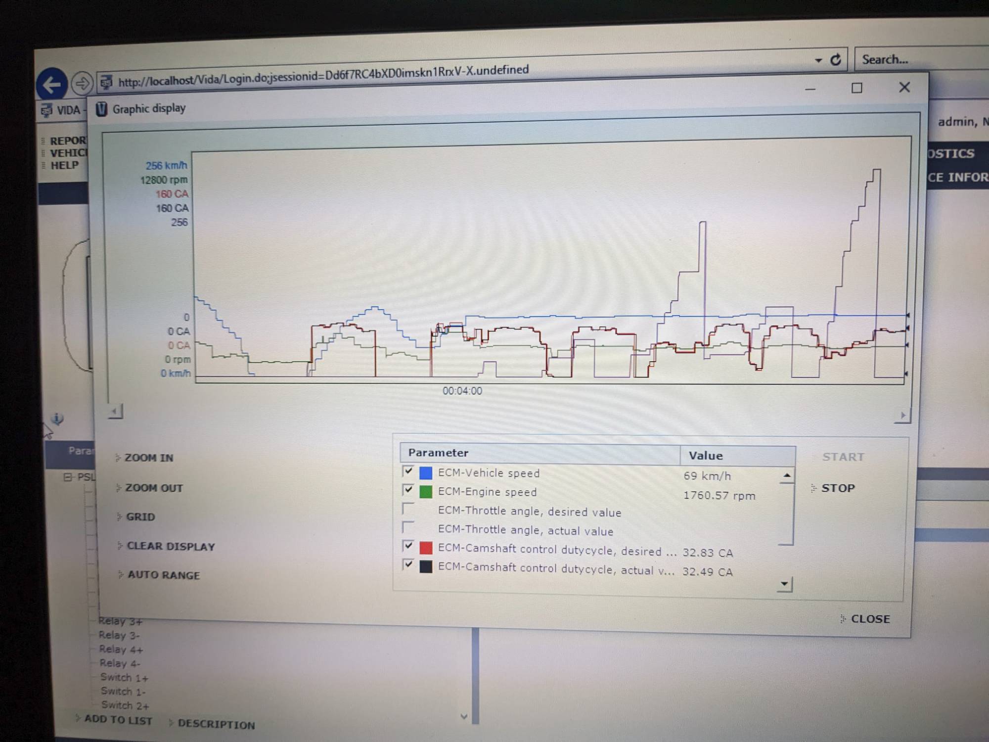

I finally replaced my VVT solenoid. The car now cold starts in three cranks instead of five or six with the bad solenoid. The hard start wasn't a fuel delivery issue.
The car is still misfiring on cylinder 1 and has a lack of performance. The misfire happens always at idle and rarely when driving with very light throttle applied via cruise control.
I've attached a VIDA graph showing vehicle speed (blue) on cruise at 45 and misfire count (purple) occasionally increasing. Weirdly, the graph doesn't show the misfire when stopped though I felt the rough idle. It looks like misfires happen right when the camshaft angle is set low.
Could there be a problem inside cylinder 1 such as the valves, piston, rings, head gasket, etc? How can I know which internal parts to buy for replacement before opening the engine? The engine block has oil baked on below the cylinder 1 intake port and alternator which suggests a leak.

You are stretching the collective brainpower here!
How about a sticking valve in cylinder one ? A bit scary but if it were going to be damaged thst would have happened by now.
Try putting a vacuum gauge on it and watch for a downward flick as you transition down from 2000 rom to idle.
If that shows up , you might be able to unstick with some Marvel mystery oil or like product
Sticking compression ring? I’m not sure how that looks on vacuum gauge
