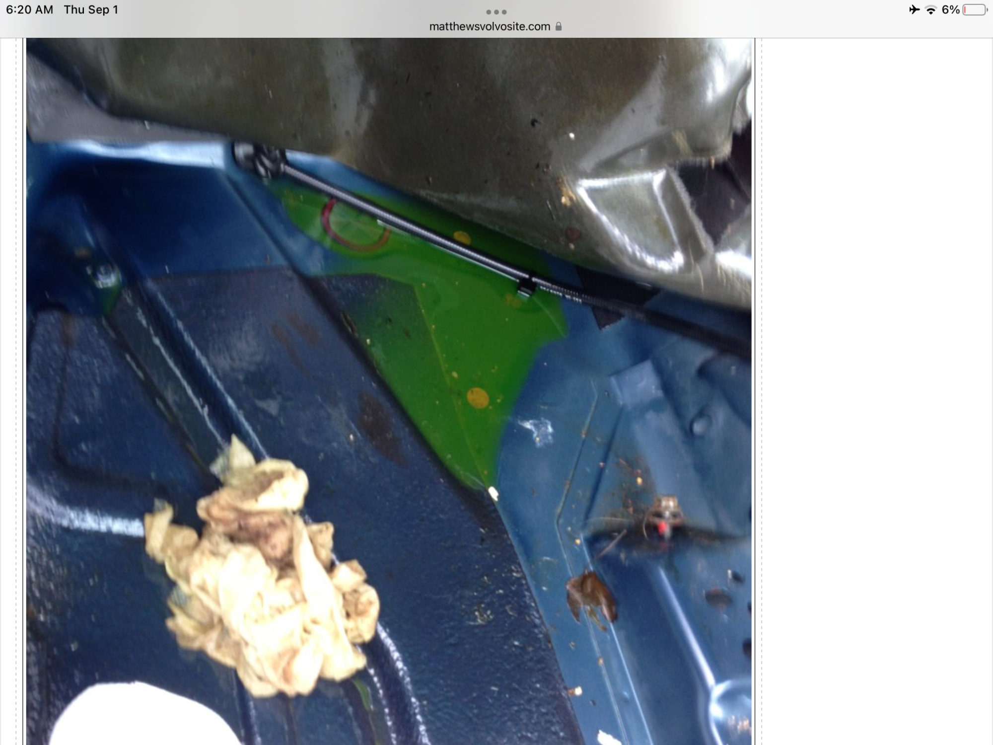

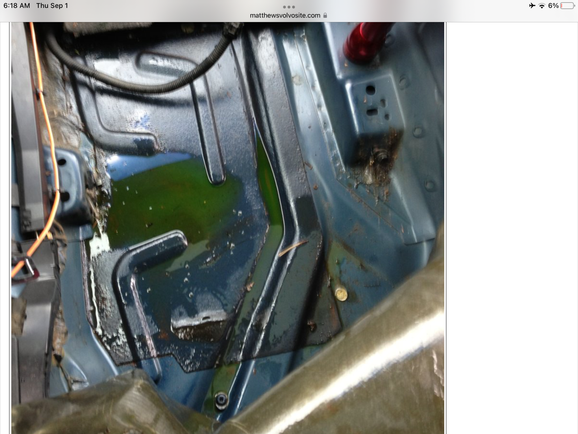

It was the heater core. It didn't seem like it was leaking that much, so at first, I thought it was something else. Until I lifted the passenger floor mat...
2002 v70 X/C 288k miles
- Posts: 36147
Way back from when I first found MVS in 2013. What a horrible sticky mess of heater core leak throughout car…
I literally filled the interior tub of the car with three, 2-3 gallon rinses of water to get the coolant out.
The thick foam underlay keeps the coolant from soaking the carpet so you don’t know it’s there unless you can smell
