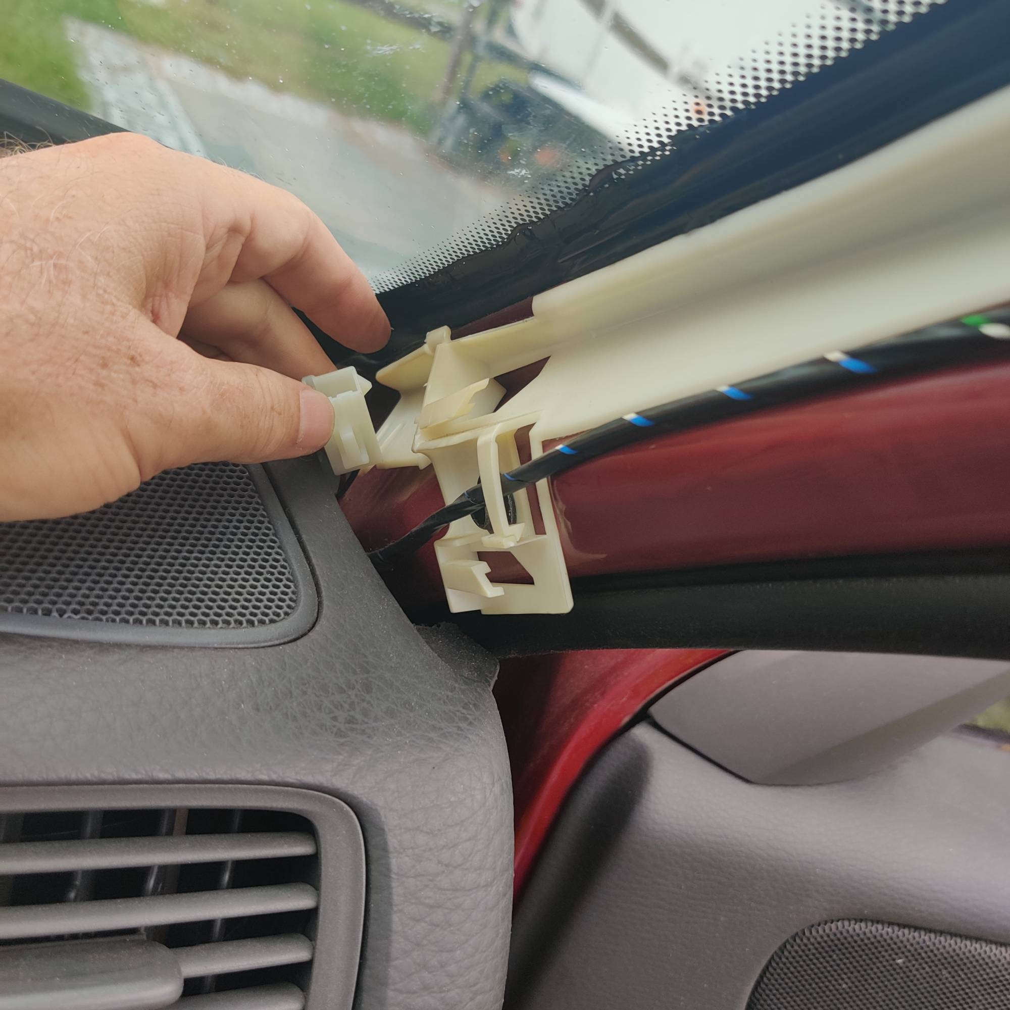

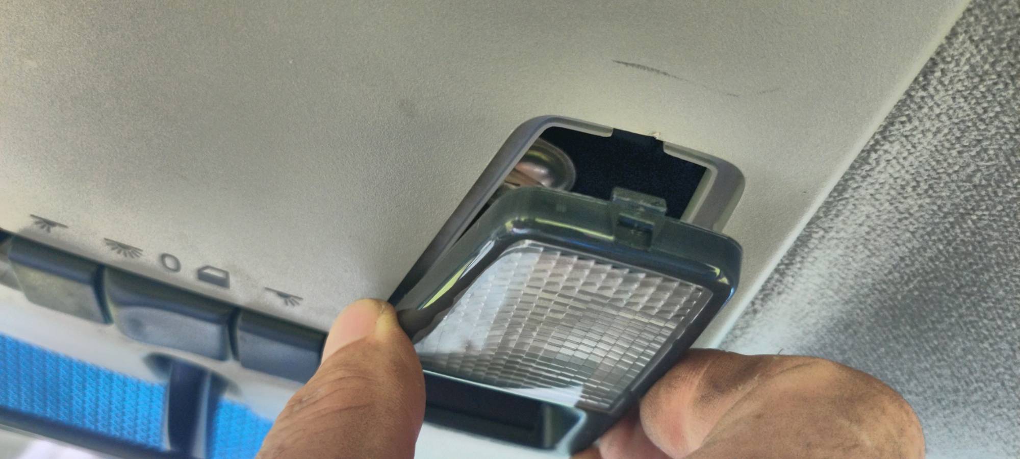

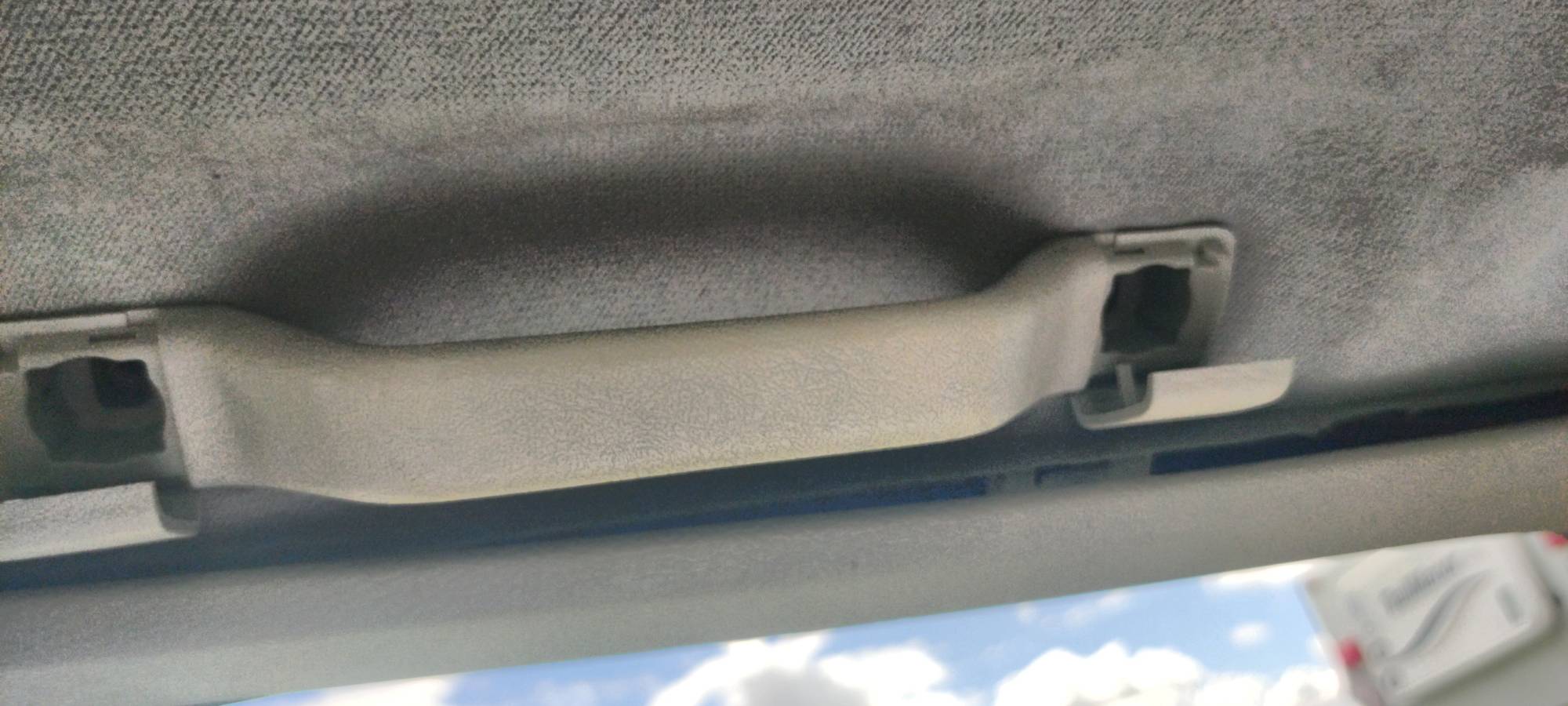

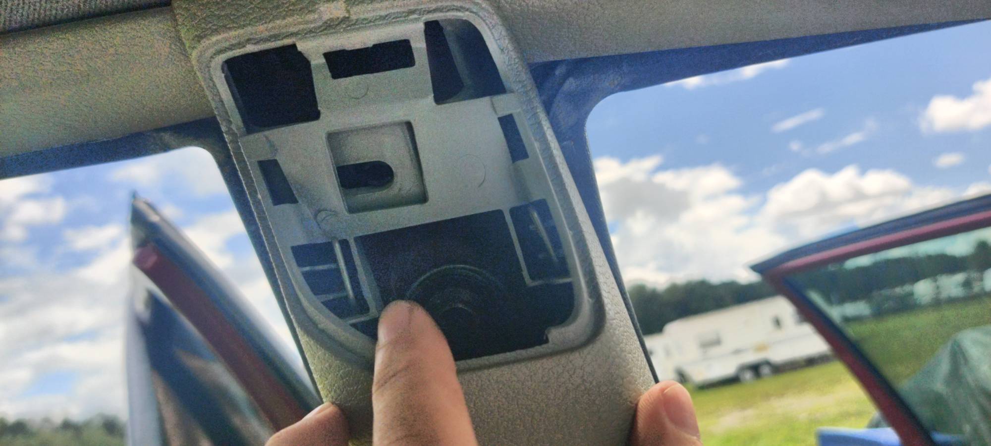

Post by surfbug1 »
Firefox! Thanks!

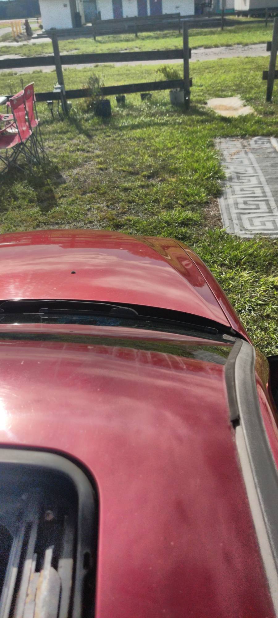

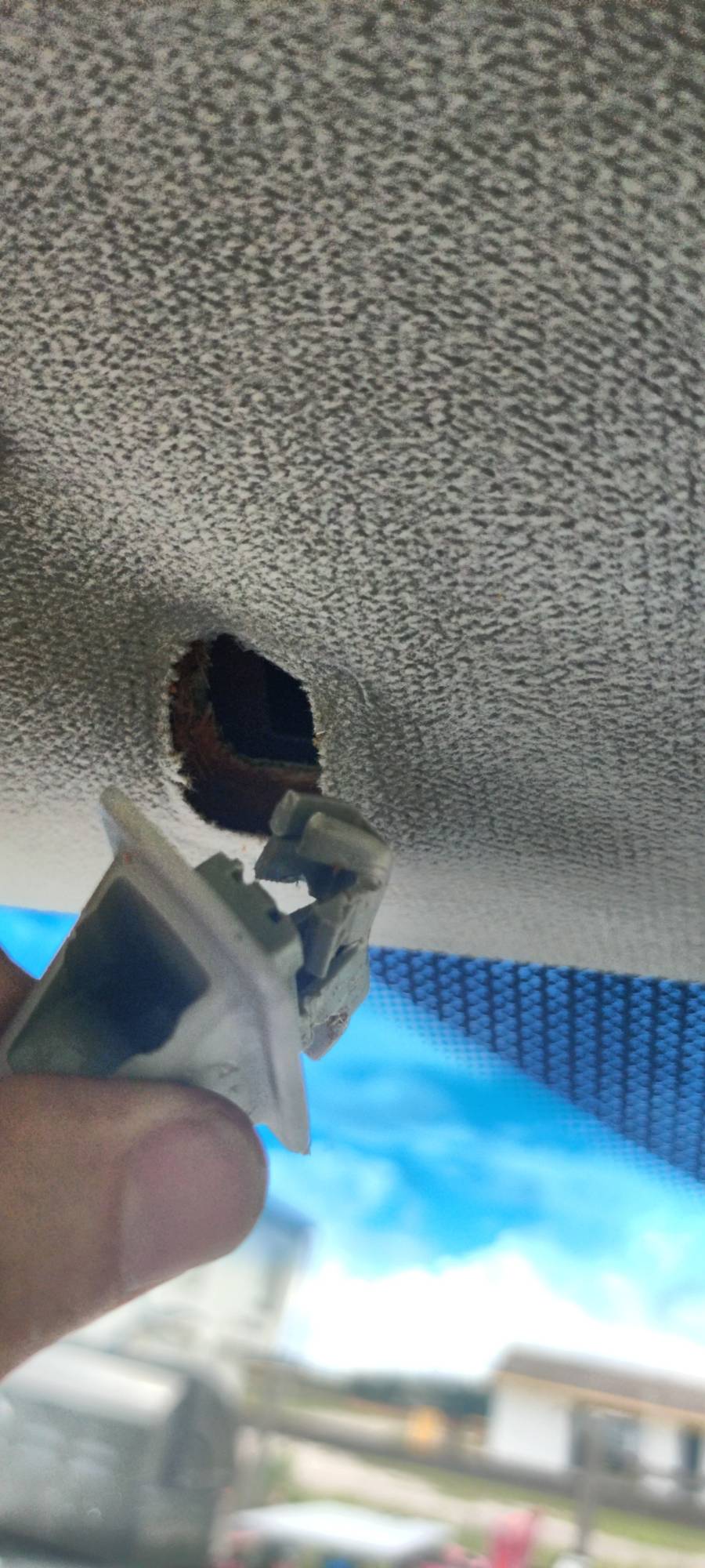

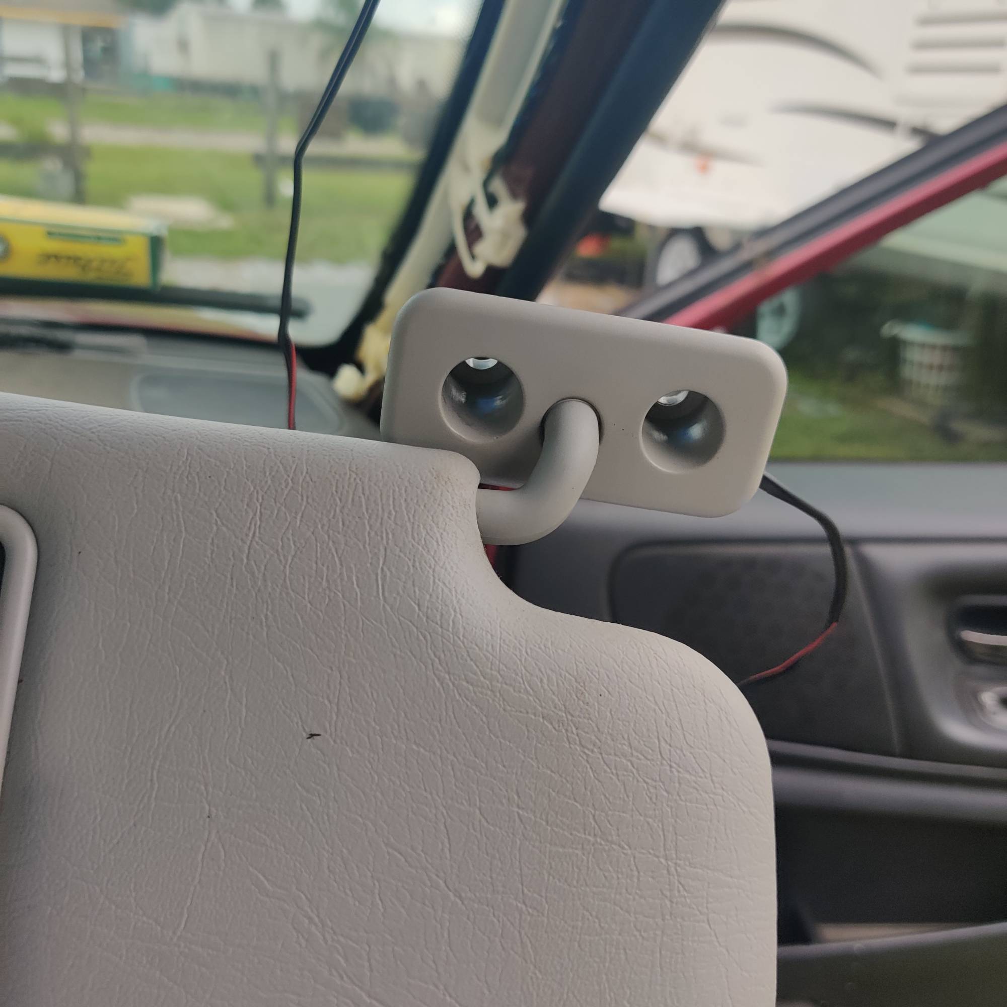

Here are some pics so far
Almost have the headliner out.
Have been using the ROBERT YouTube video...

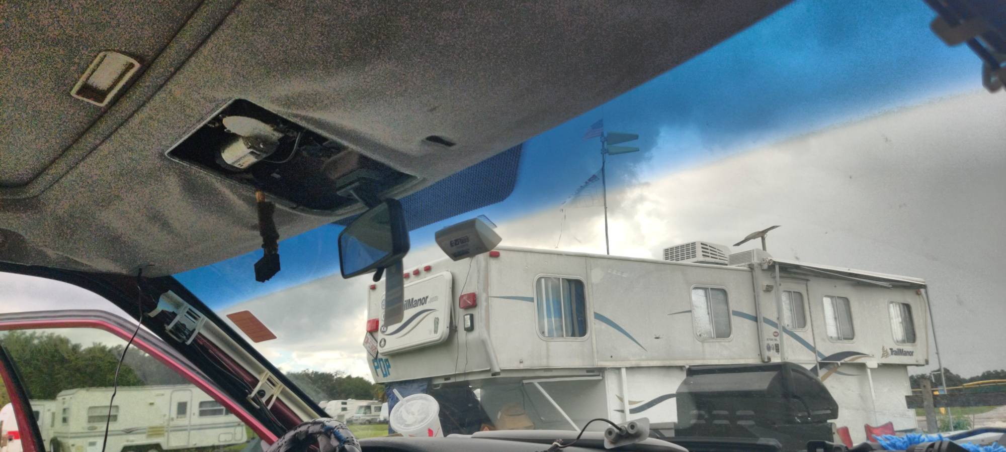

surfbug1
Posts: 195
Joined: 13 September 2006
Year and Model: 1998 V70, 2006 S80
Location: Tysons Corner VA
Has thanked: 41 times
Been thanked: 9 times

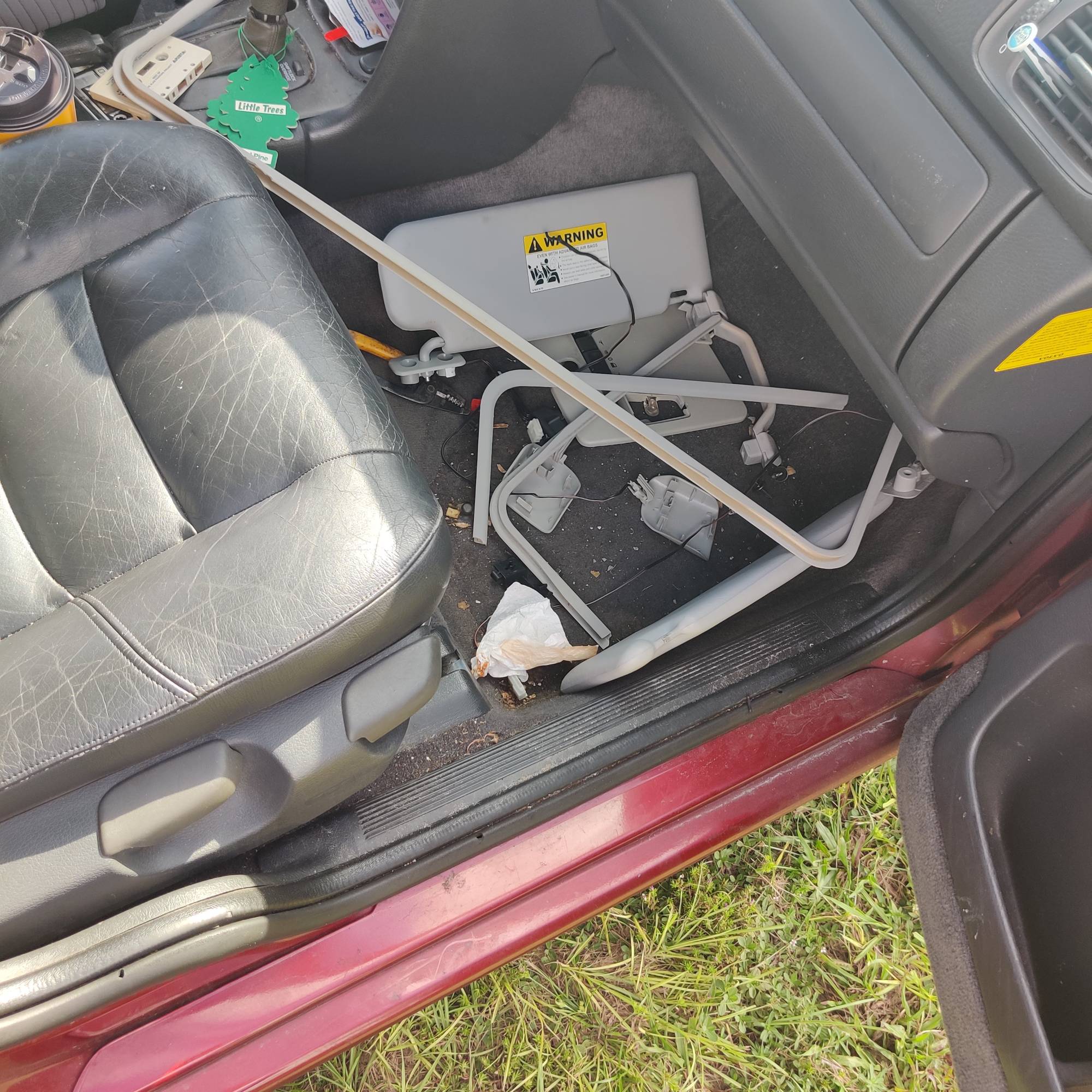

Post by surfbug1 »

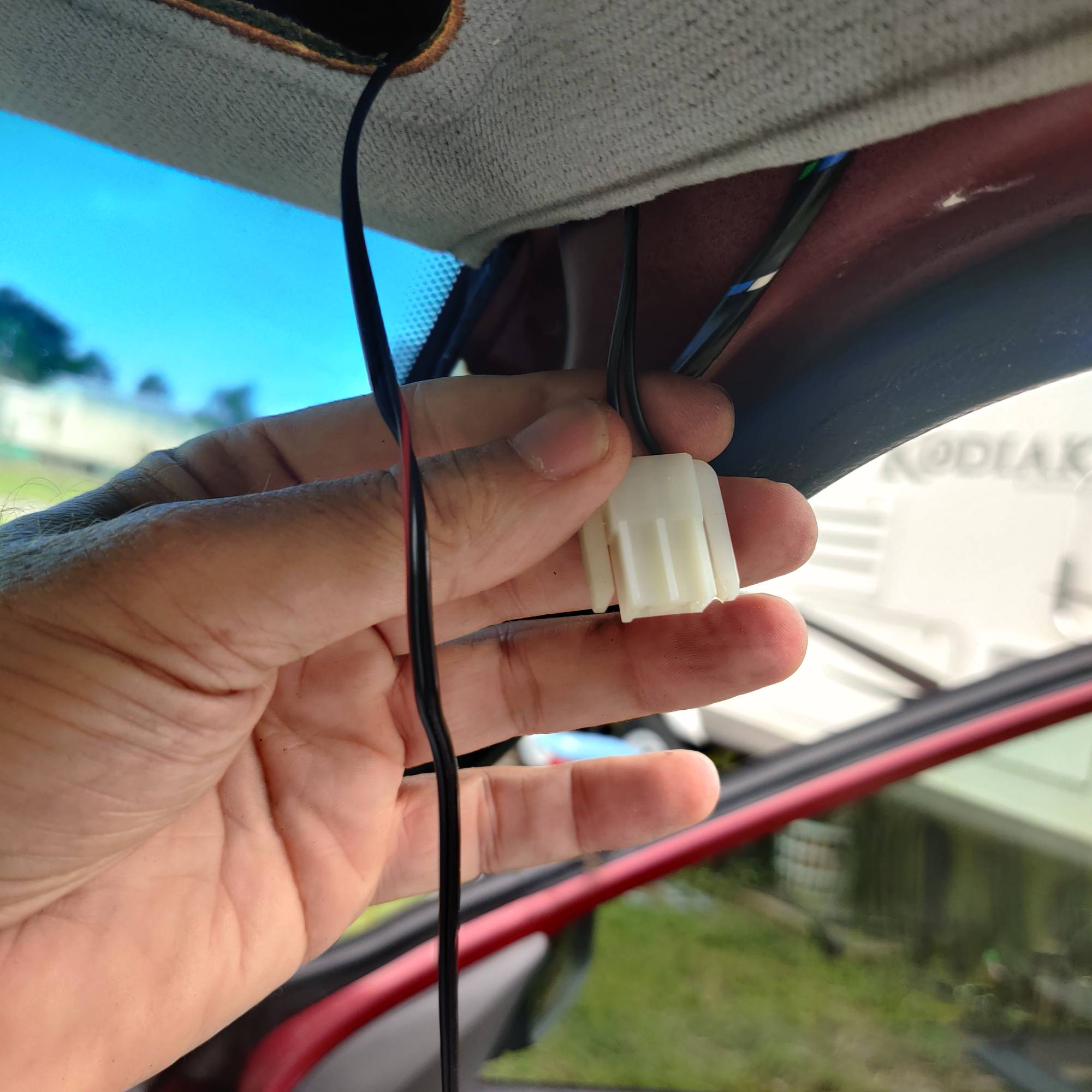

And more pics ...
Almost ready to remove the headliner....or just lower it.

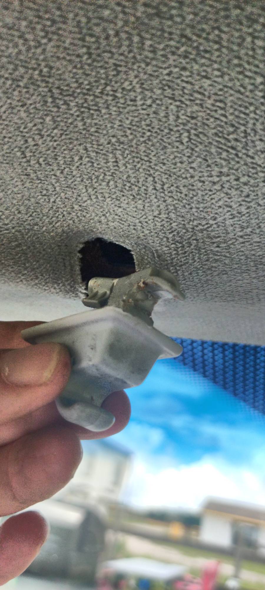

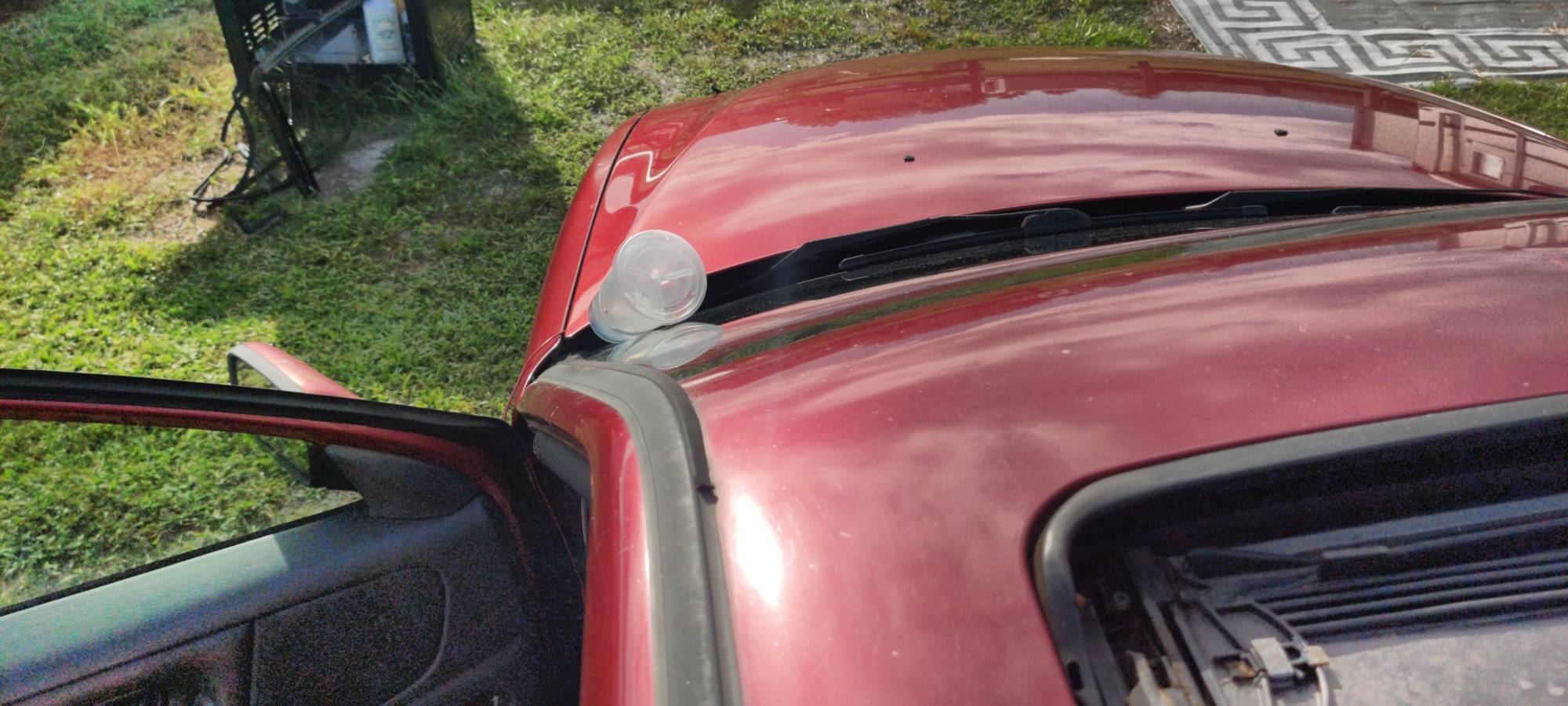

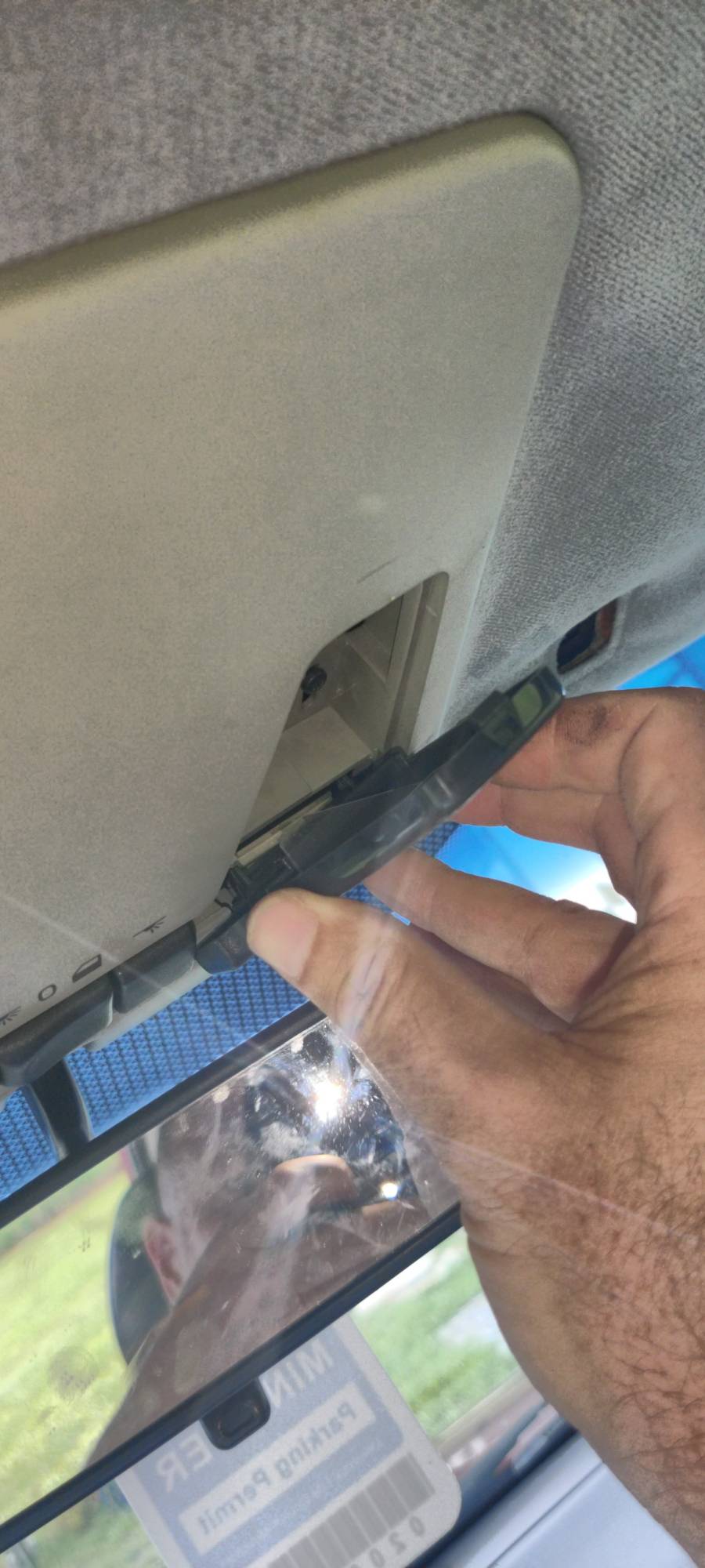

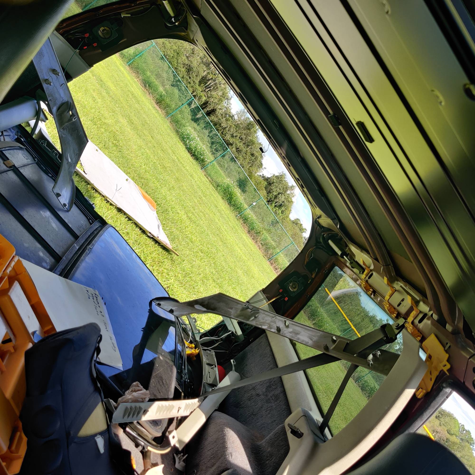

Post by surfbug1 »

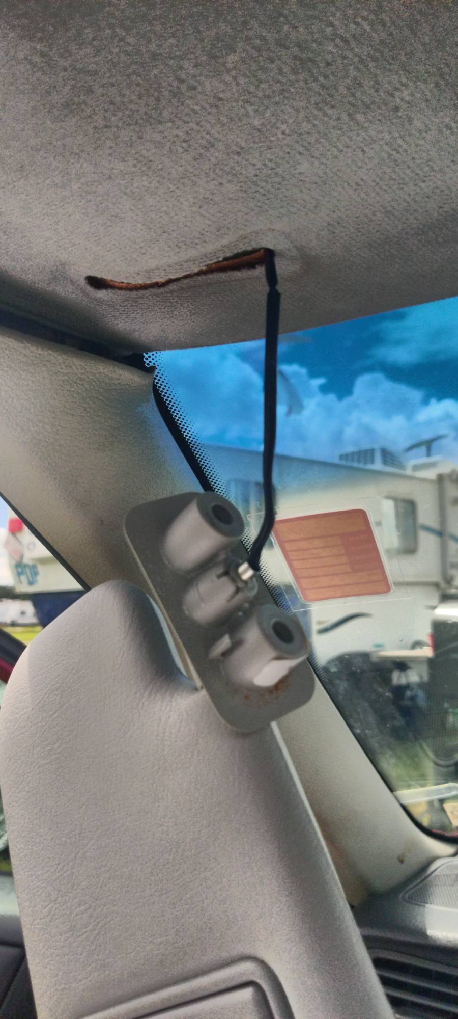

And it's out.
The ring around the sunroof, the plastic trim part, will break.
Best is to take a screwdriver , a flat blade, and bang it on the contact points, to break the snaps free.
I missed that and it broke. Oh well
Here are more pics. Now to get the sunroof out before the Florida afternoon rains!
Al

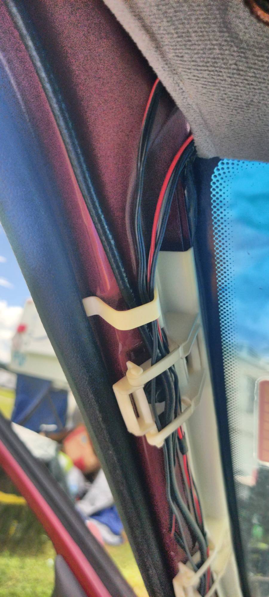

Post by surfbug1 »

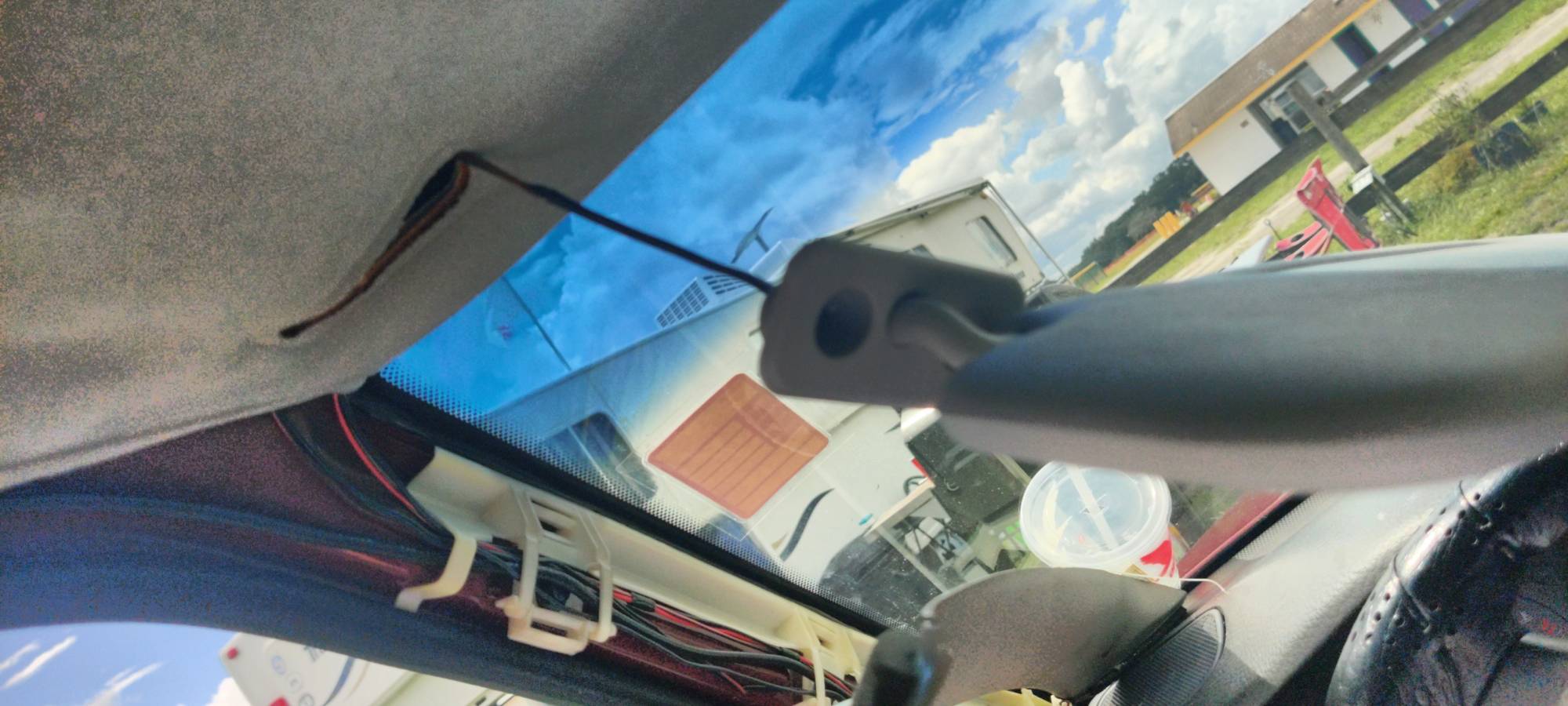

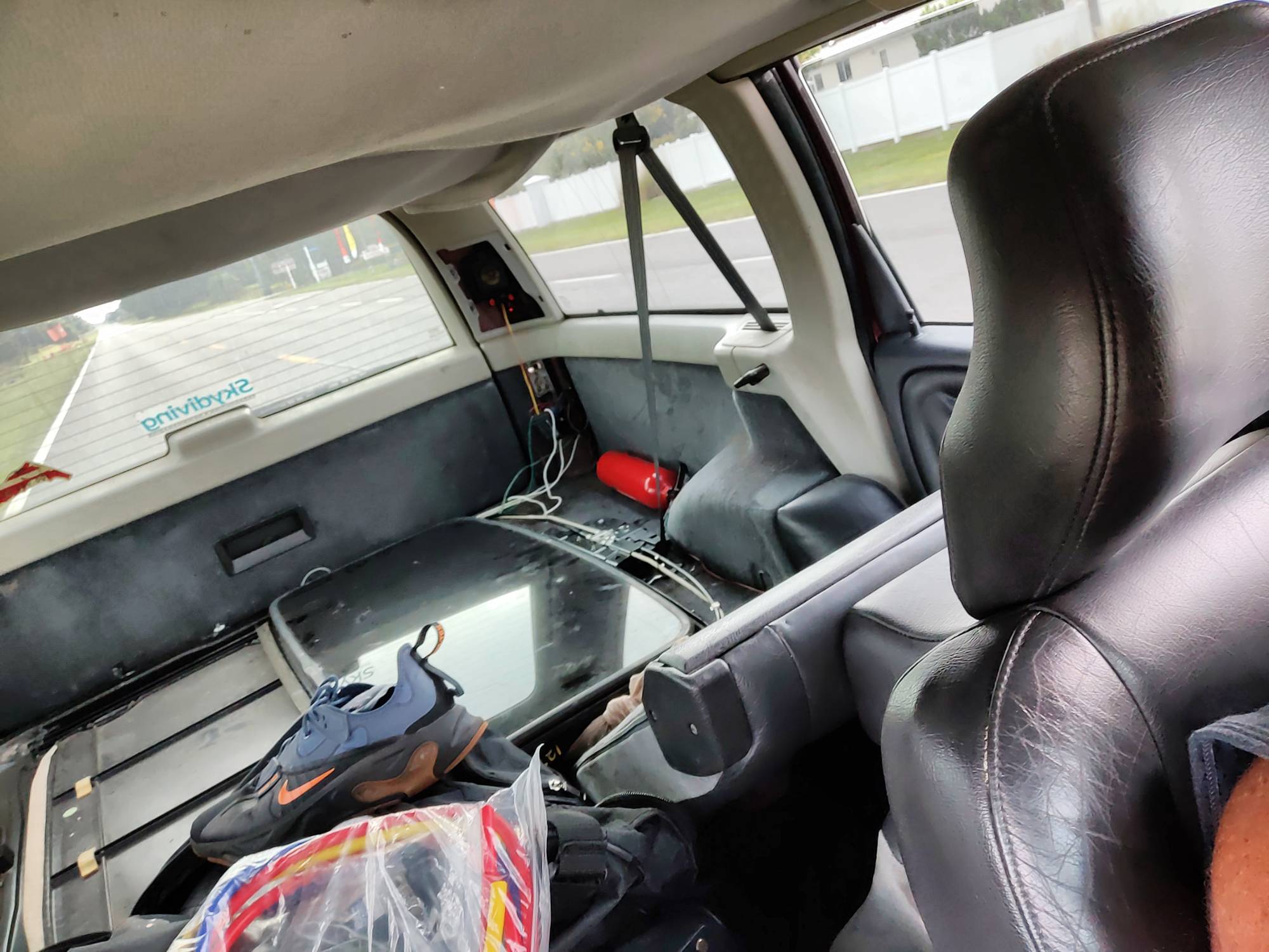

Pics of headliner removed.
Looks alot worse than it is .....

Post by Sveedy »

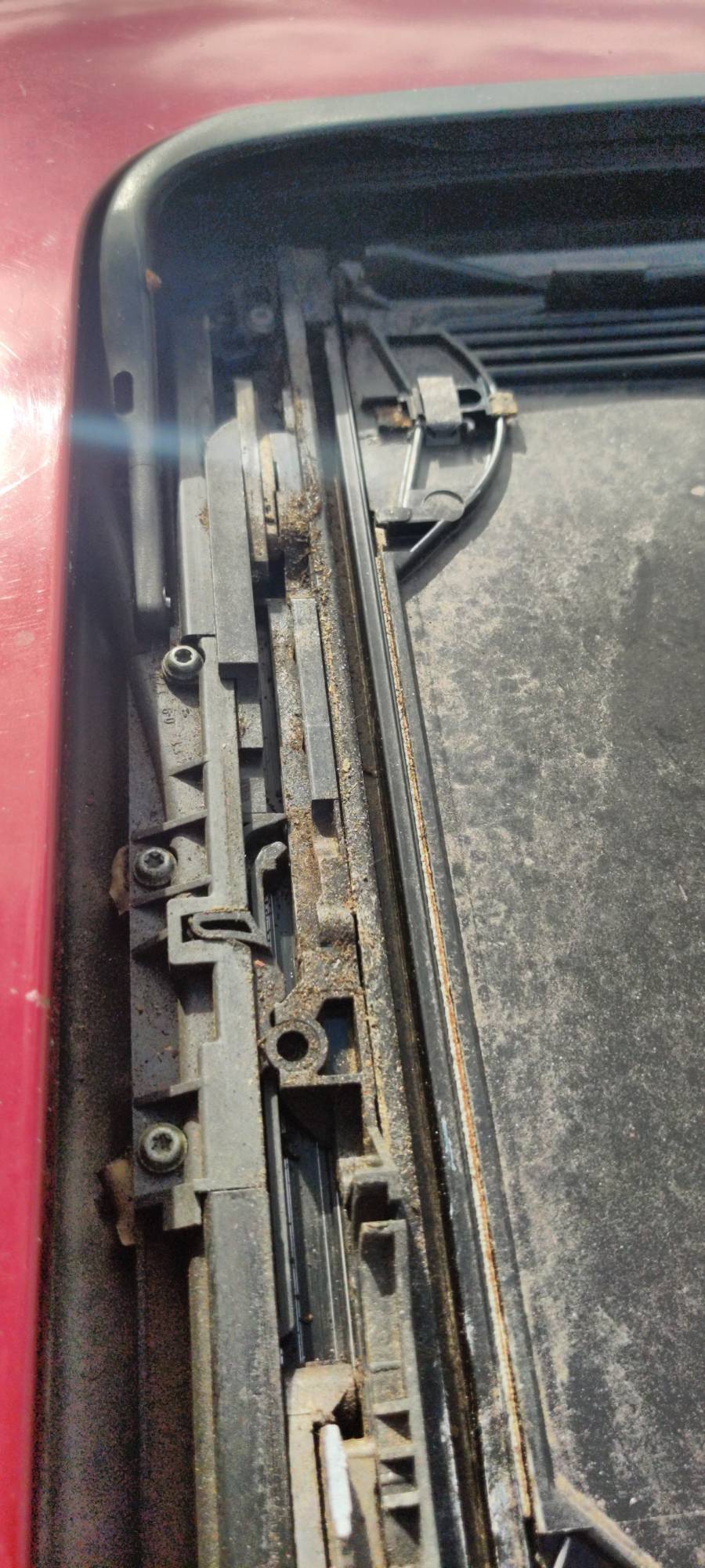

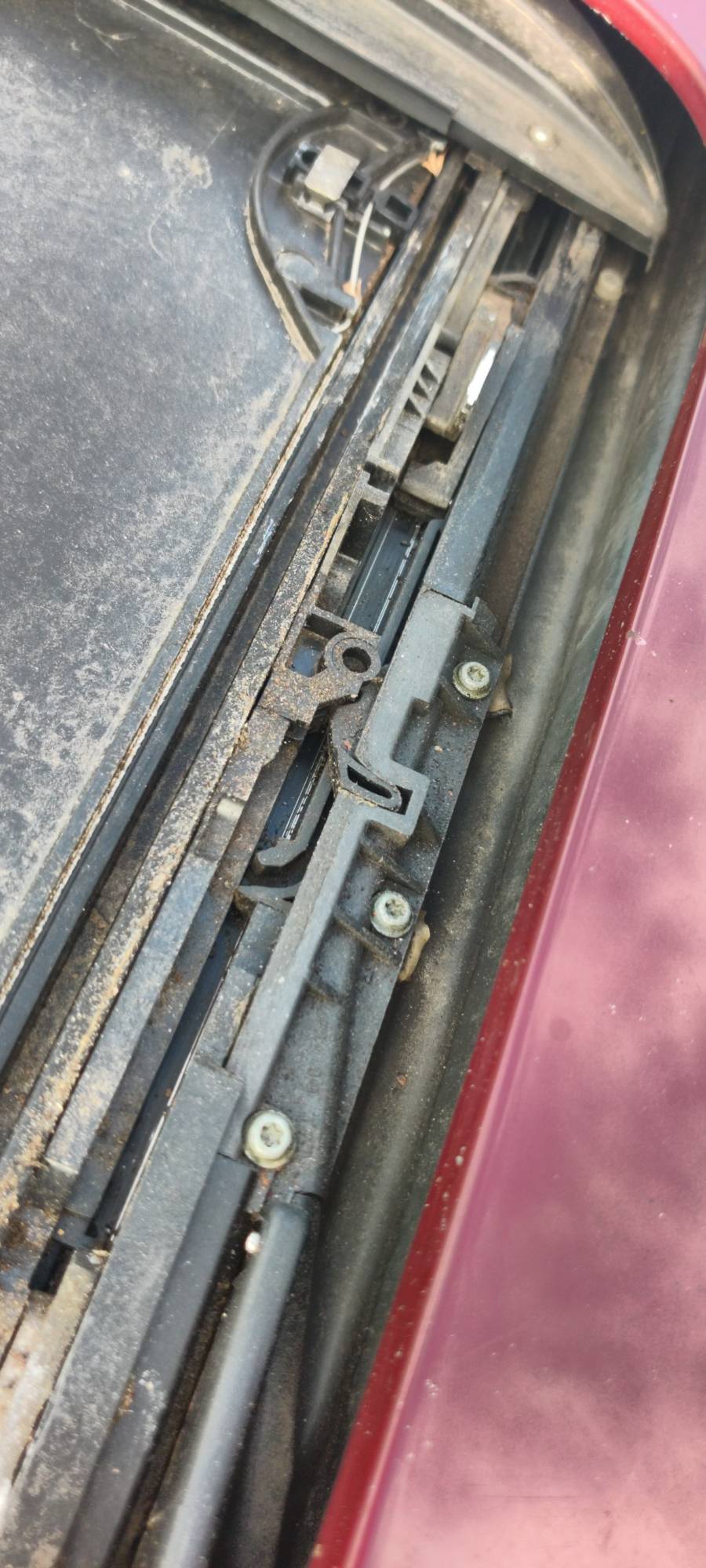

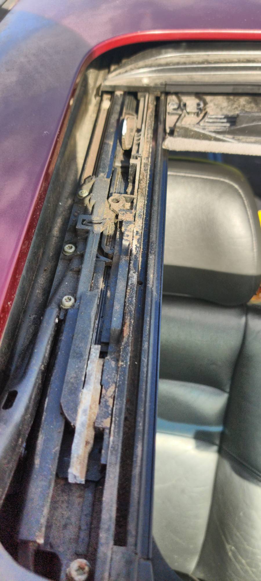

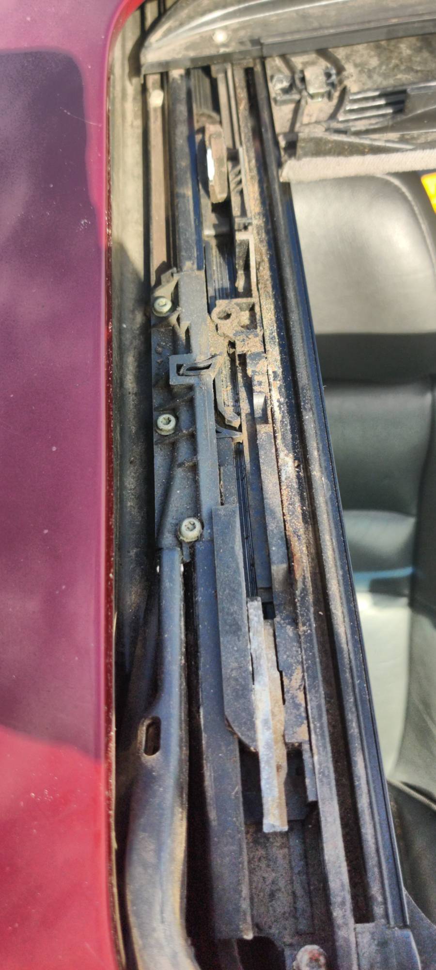

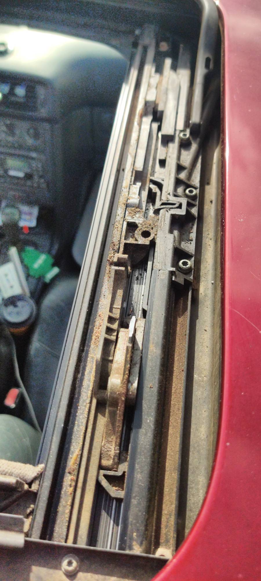

Thanks for the pics. I'm going to have to deal with my sunroof at some point ( starts to tilt, and stops. Starts to open, and stops ), and these help to see whats behind the headliner. If you can, snap a couple of the track assembly near the opening, as I think something is broken there on mine.
1999 V70 GLT
surfbug1
Posts: 195

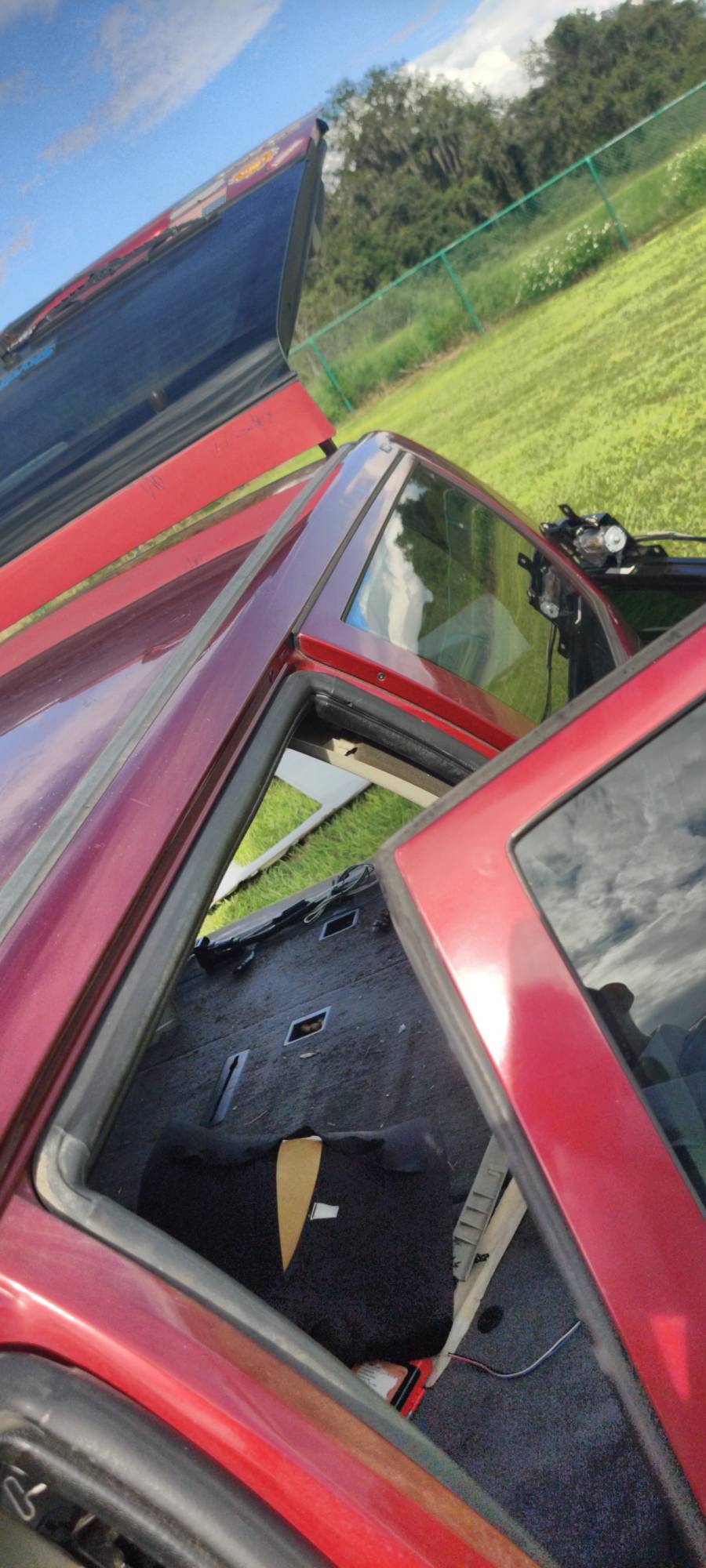

Post by surfbug1 »
Sveedy wrote: 21 Sep 2022, 14:20 Thanks for the pics. I'm going to have to deal with my sunroof at some point ( starts to tilt, and stops. Starts to open, and stops ), and these help to see whats behind the headliner. If you can, snap a couple of the track assembly near the opening, as I think something is broken there on mine.
Ok will do.
I can take pics of the sunroof installed. My broken one I'm removing
And the new junk yard new one I am installing.
And feel free to pm me, I can give u my number I am good to chat anytime.
I have a bunch of Volvo wackos in my phone that I call in a pinch
Al

Post by surfbug1 »

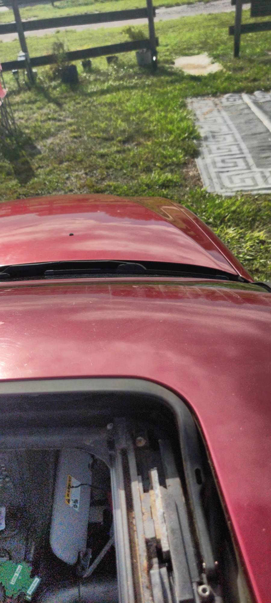

Here are pics of the sunroof installed my old broken sunroof. I am about to remove it

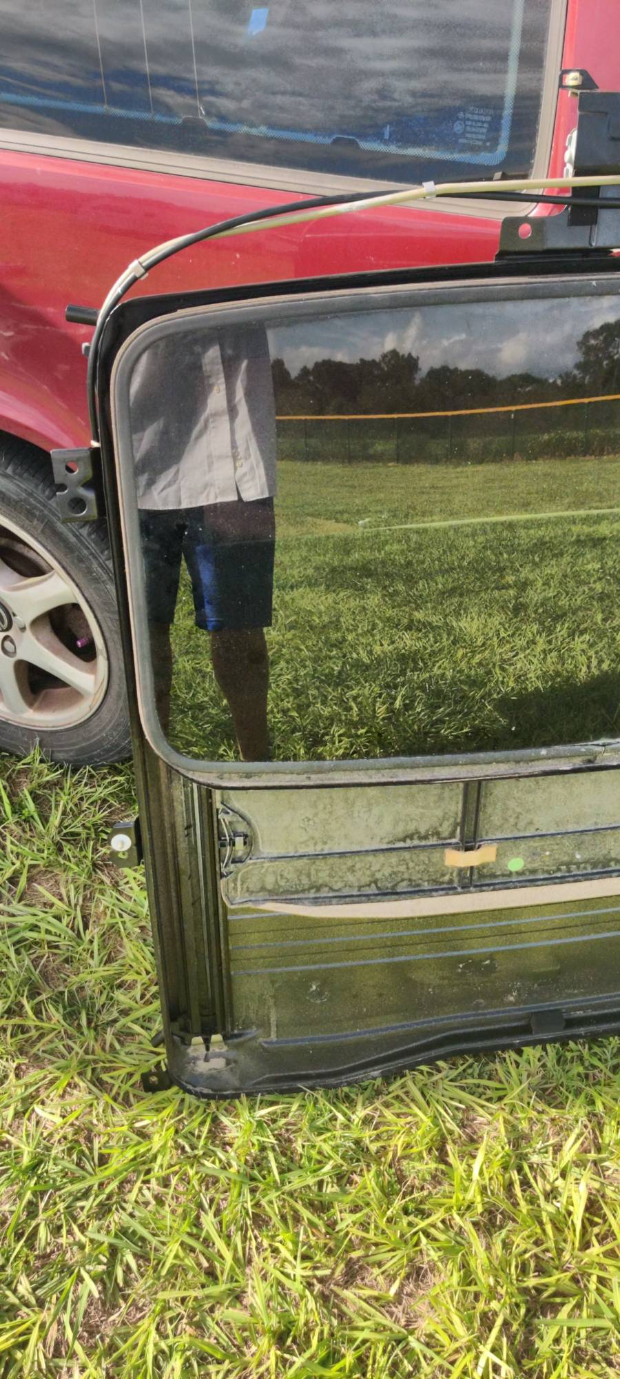

surfbug1
Posts: 195

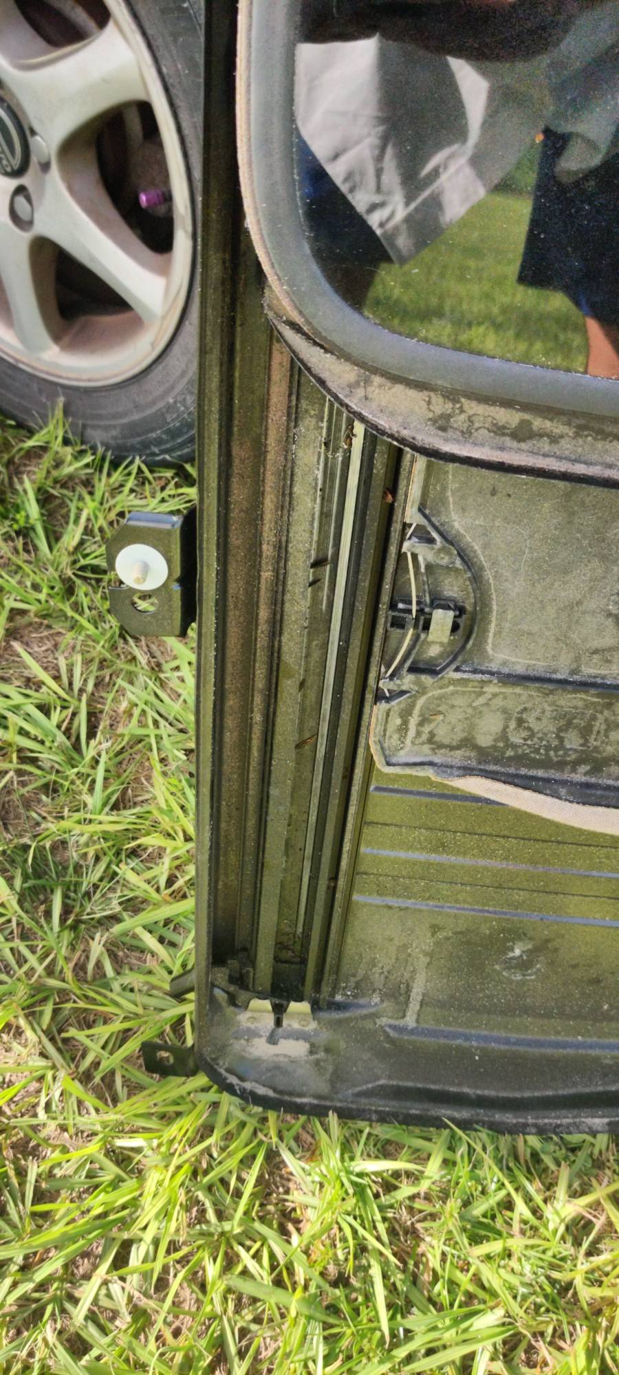

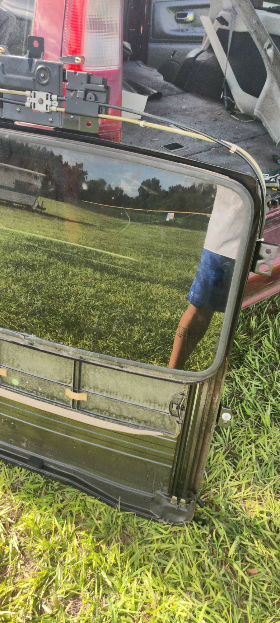

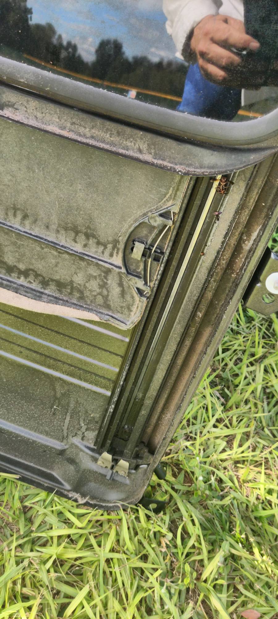

Post by surfbug1 »
And here is the new junk yard new unit. But the roof is closed.
I can take more pics when this new unit is installed.
