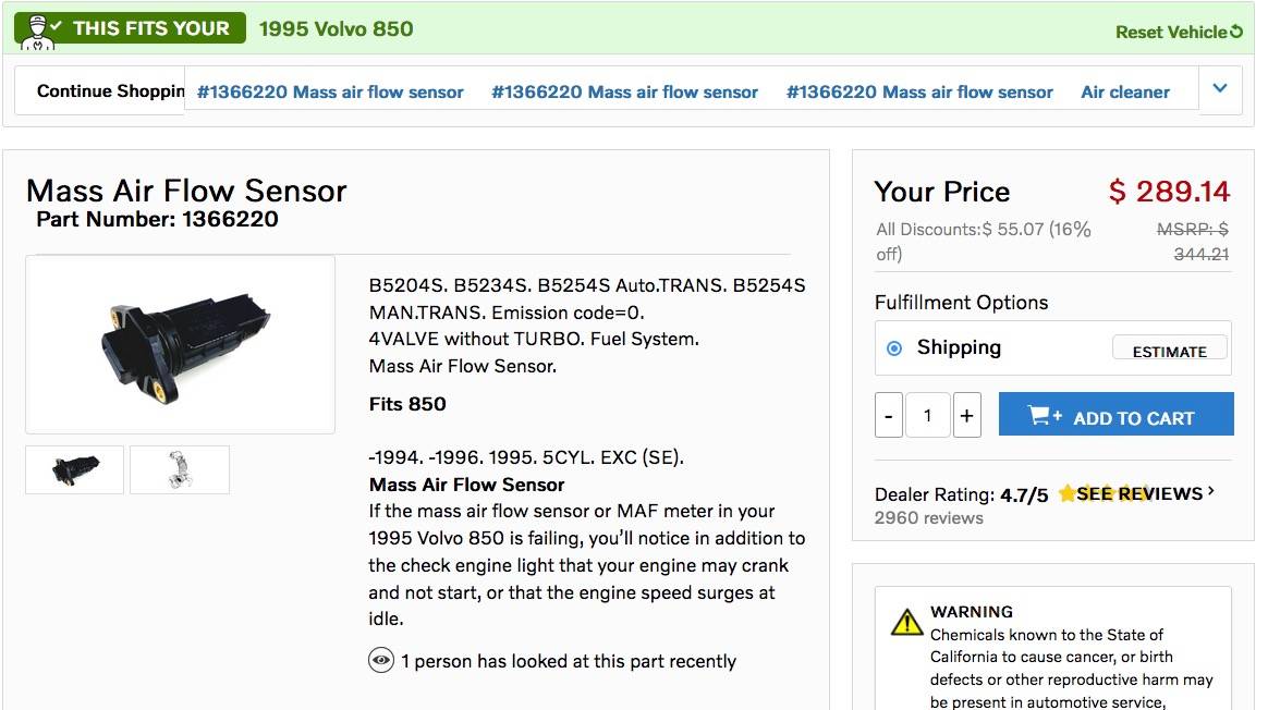

Capture d’écran 2022-12-03 à 21.44.11.jpg (100.5 KiB) Viewed 356 times
I ask the seller to control the serial number of the insert... Could it be possible that the sensor fits to my engine ?

manovlov wrote: 03 Dec 2022, 13:24 Capture d’écran 2022-12-03 à 21.44.11.jpgI ask the seller to control the serial number of the insert... Could it be possible that the sensor fits to my engine ?
Mea culpa, I forgot your car is non-turbo.

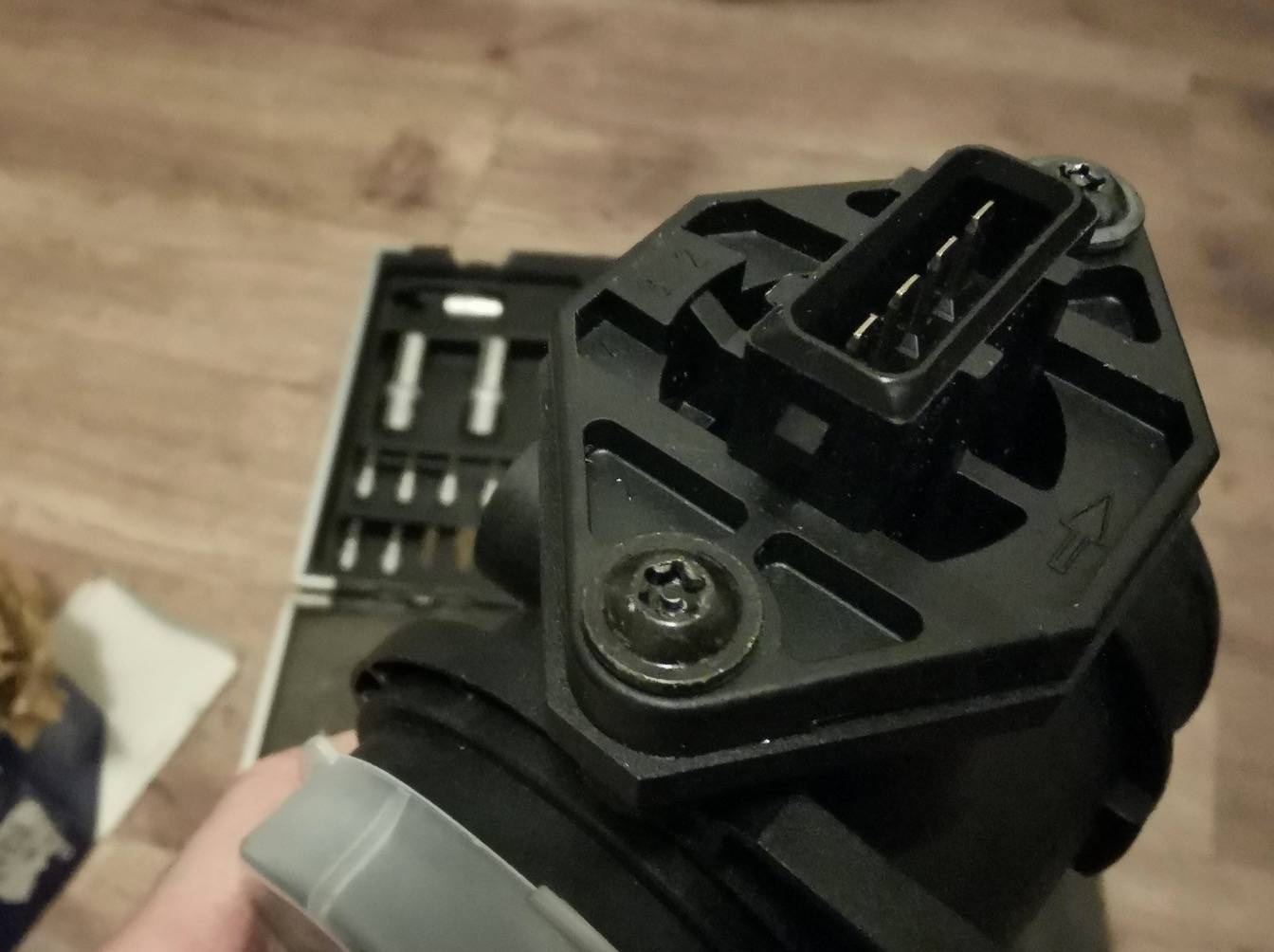

Don't worry, the seller cancelled the sale, he doesn't have the right tool to remove the sensor... I have no other way than to go to Volvo or Skandix.. I was near the goal...

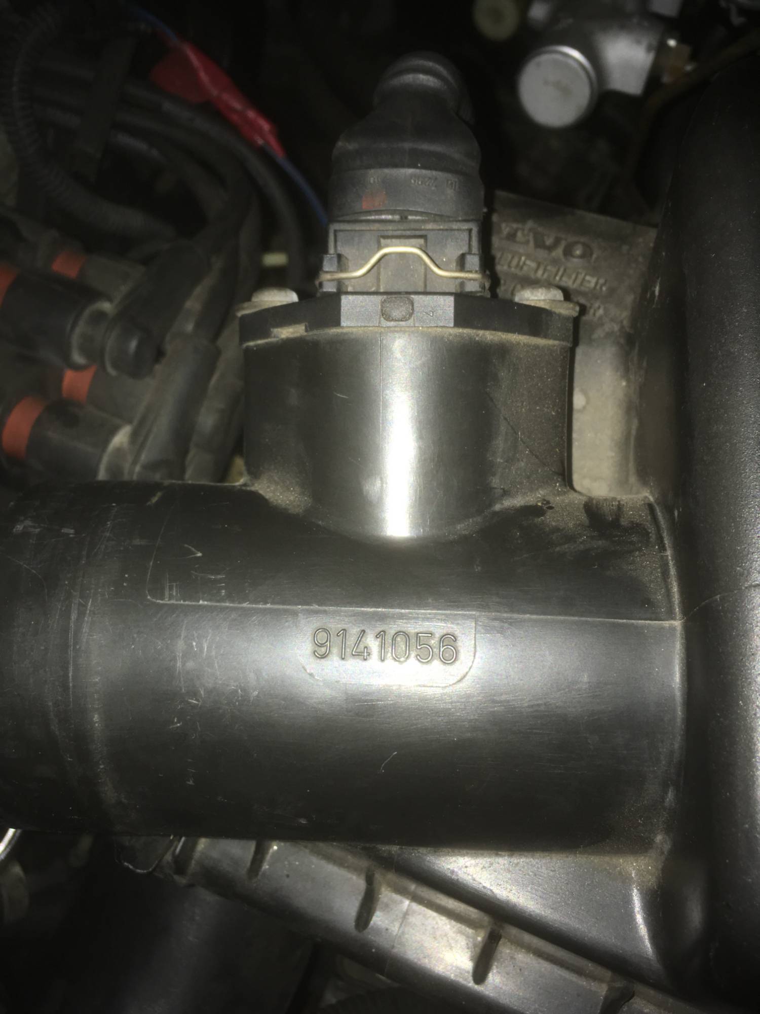

Capture d’écran 2022-12-04 à 00.03.09.jpg (90.64 KiB) Viewed 322 times

Sensors are not interchangeable.
They use different method to measure the air flow...hot film vs.thermistor if i recall correctly.
Different voltage output.

Looking closely at the insert...it could be possible that inserts are the same...but you will need to compare part# from the inserts itself...not housings.
However...the chances are pretty low.

You remove those security torx with a bit with a small home in it, or a ViceGrip !
You can also Dremel the pin off in 17 seconds

abscate wrote: 04 Dec 2022, 04:28 You remove those security torx with a bit with a small home in it, or a ViceGrip !
I prefer to use the right tool.
