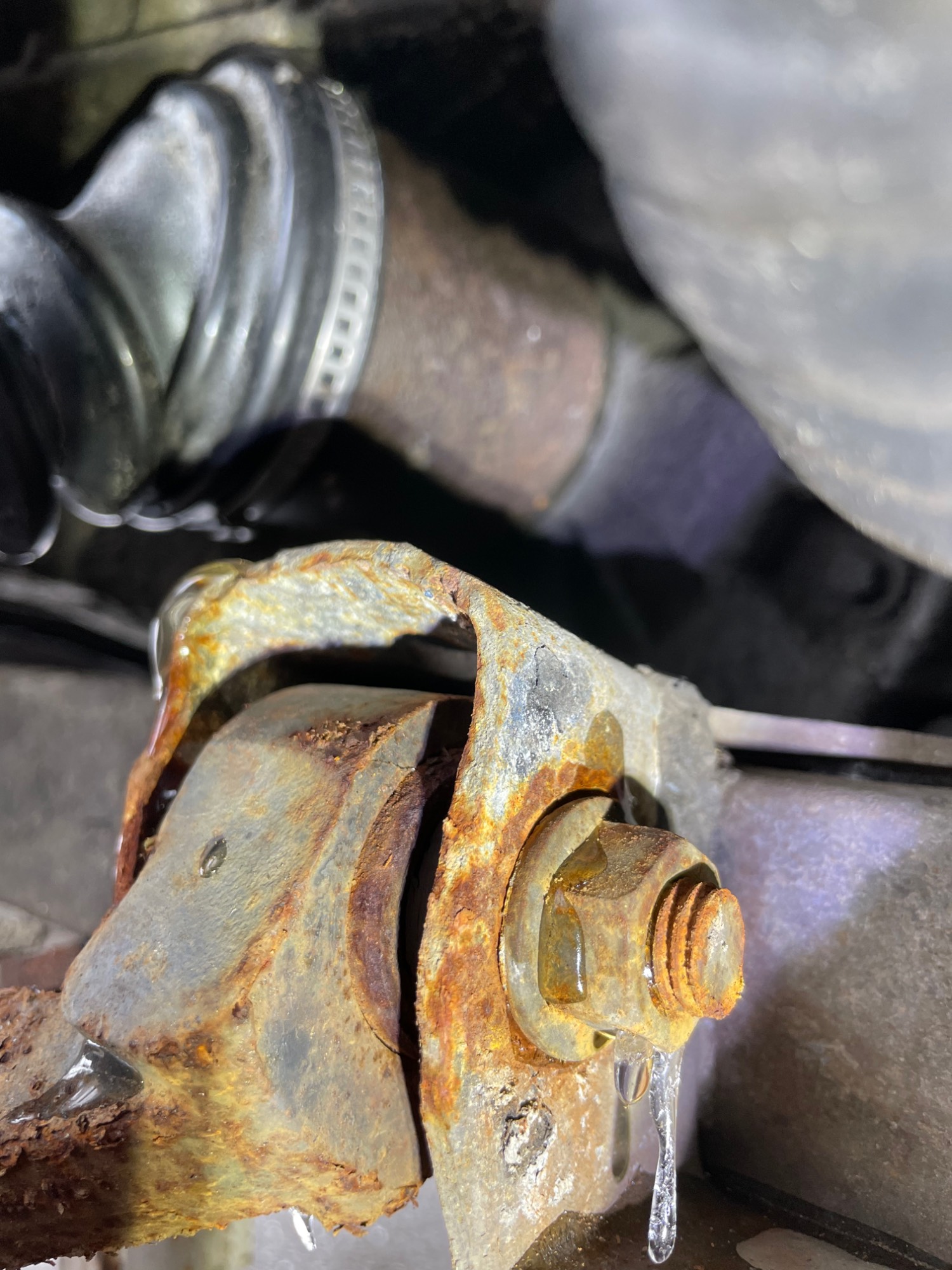

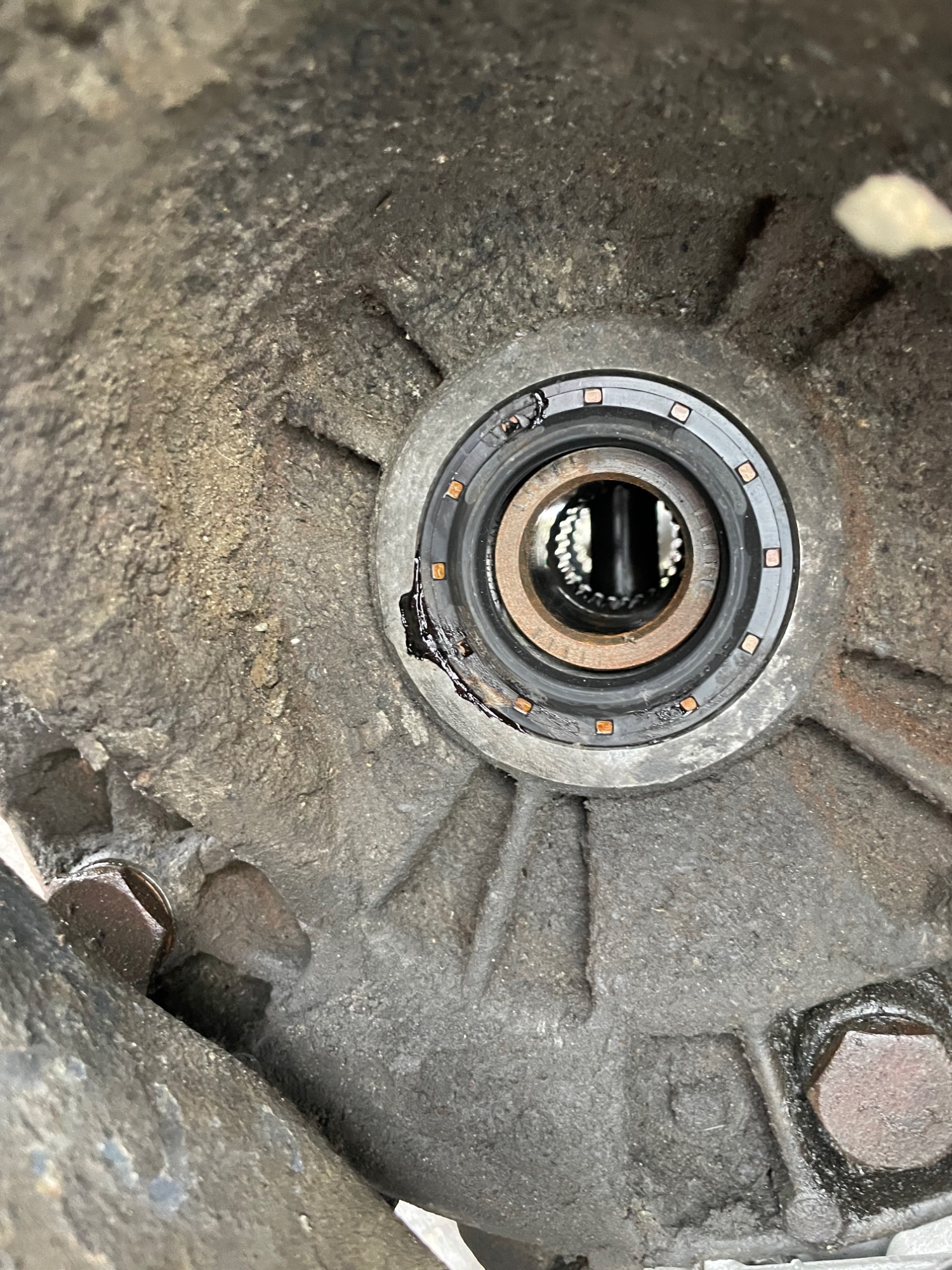

Managed to beat back winter to get the shafts installed and car back in her feet.
Got bitten by two things
An hour wasted looking for one of the three 36 mm sockets I own, unsuccessfully
The new circlip in the shaft bit me in the BEE hind by not popping in. I’ll have to redo that side
On the M56 at least , you could punch out a stuck axle from the other side
Fighting winter ……
Fighting winter ……

Are you re-using the same axles, the ones with the new boots fitted, or are you using other axles? If you are using the originals, did you change the circlip or are you re-using the old ones? I have had issues over the years with clips, especially aftermarket ones. I only use Volvo clips which I believe you can still get. Also, try using a little trans oil on the splines especially when it is cold to try to get momentum on the cold steel.
