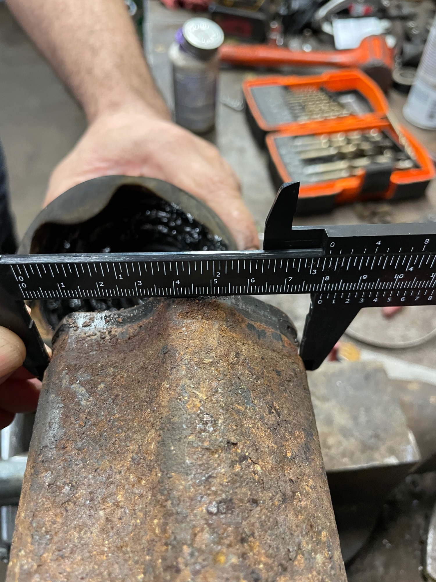

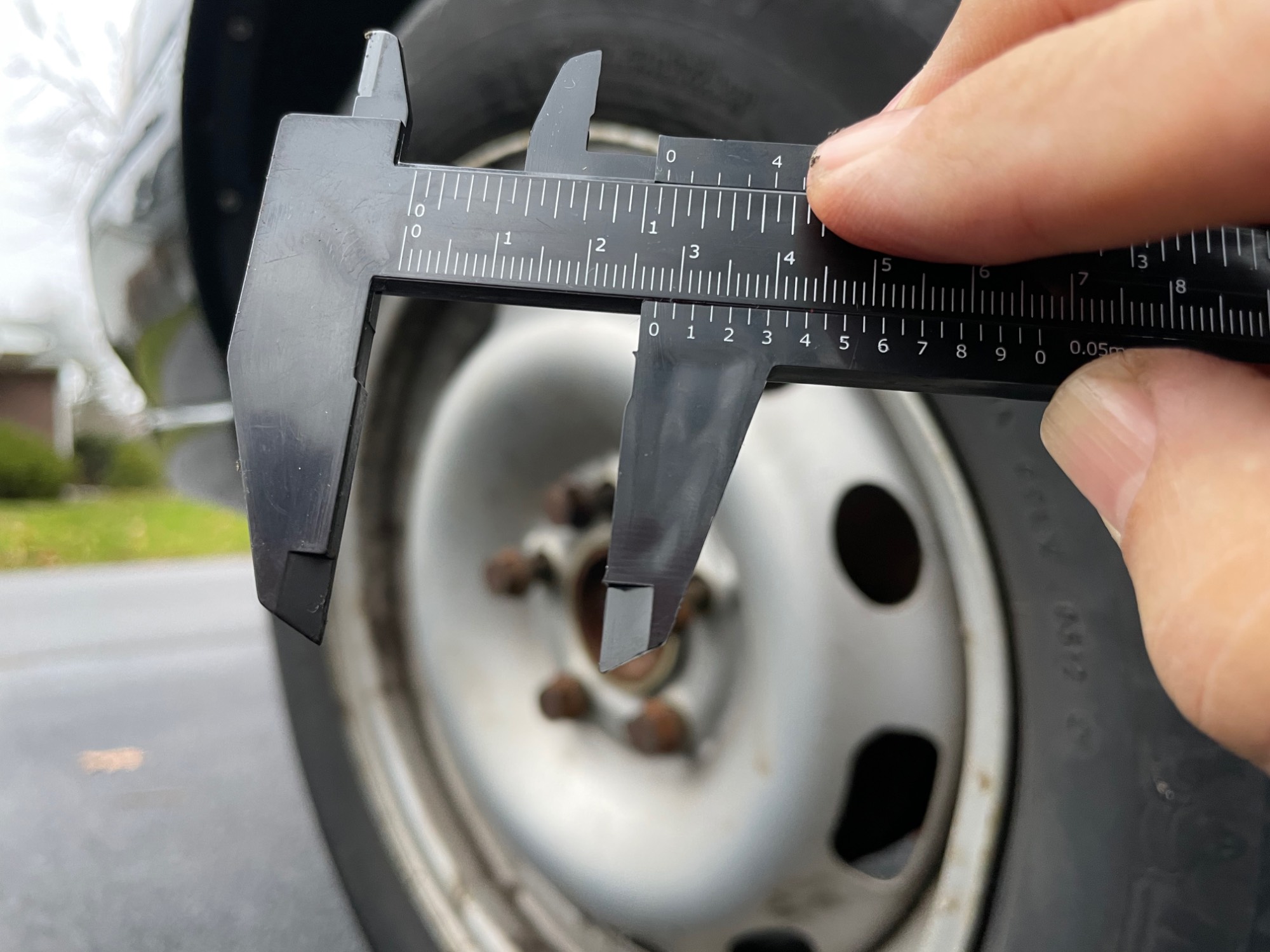

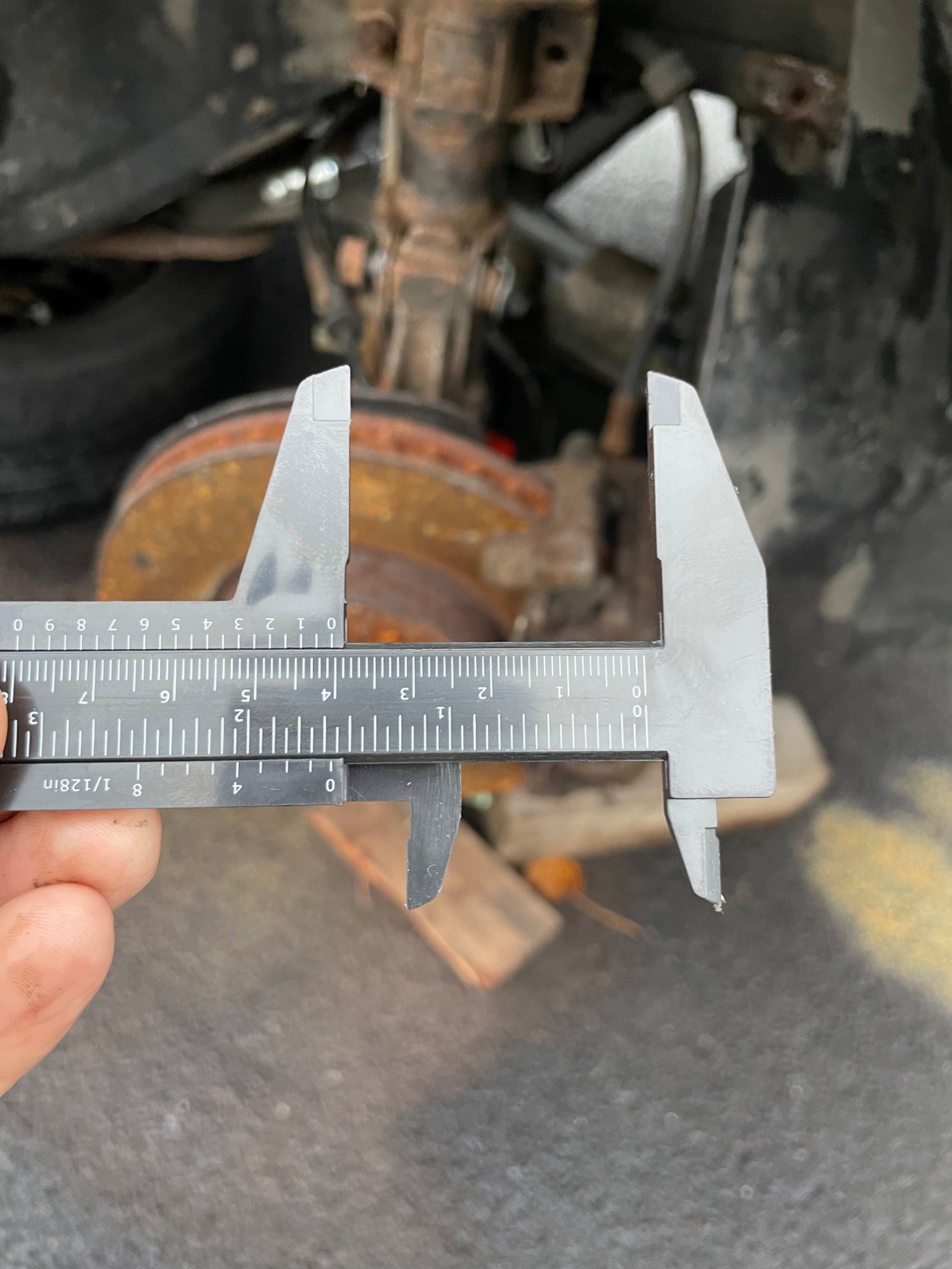

Inner boots.
Driver side takes a 28 mm shaft diameter , roughly 90 mm CV diameter. The boot is just round inside
Passenger side has tripod style with 80 mm across and 40mm axle diameter. The boot is complex with inner ears to seal the complex shape of the bearing cup

Shaft diameters quoted above are wrong. I was measuring stub axle diameter
