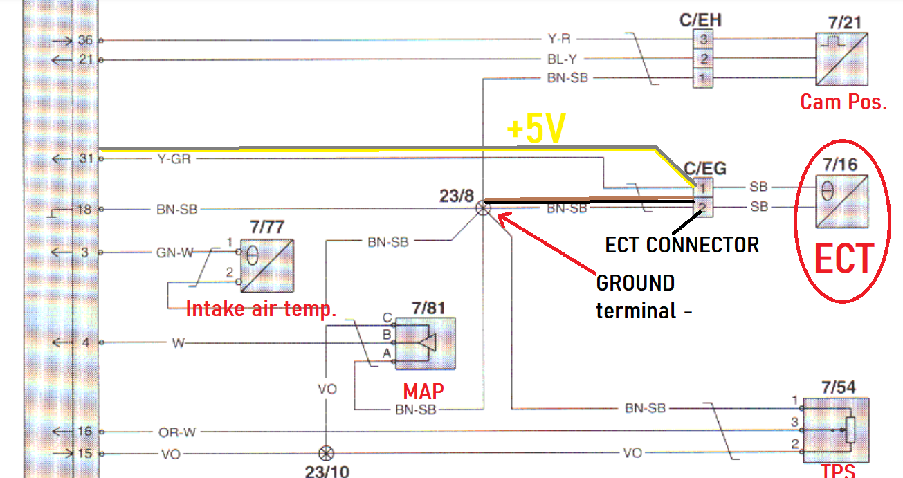

I do have a wiring doc for '97 that has Fenix in it, I will attach it, maybe it helps.

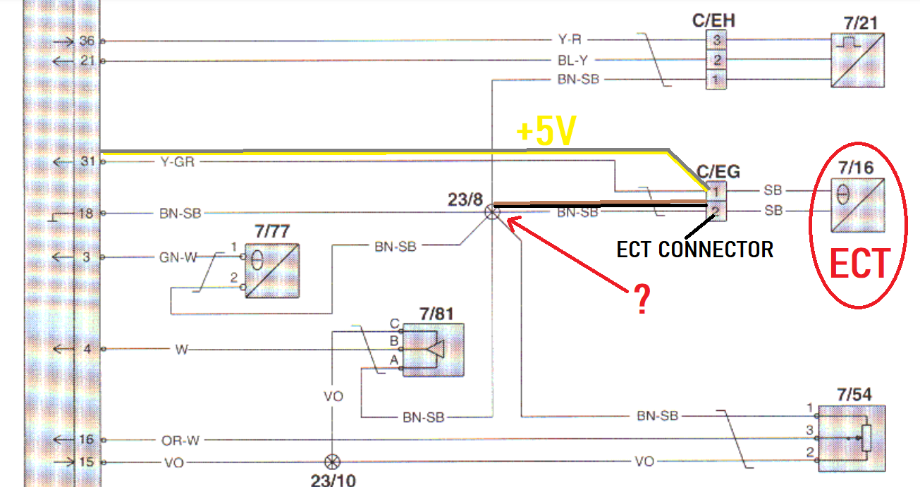

Thank you, hausmeister, this is it! I will check this schema and figure out what is going on under that hood
But I have no idea where actually is that junction point on the schema

I am not really good with reading these diagrams, but, looking at the other stuff this is connected to it seems to related sensors, and seems to be ground (18). So some kind of shared ground? Not sure if that really is your problem.Kokonradus wrote: 08 Jan 2023, 09:28 But I have no idea where actually is that junction point on the schemaMaybe there is something bad.

I have studied this circuits for a while and find out that no continuity on ECT ground wire is definitely a fault! It have no continuity to ECU ground, vehicle ground, the wire is leading nowhere and that can´t be...
The ECU don´t measure the actual resistance between ECT wires! It measures the changes in input voltage like many other sensors in the car (like TPS does by potentiometer). Input voltage 5V is going through yellow wire to sensor thermistor (resistor that changes resistance according to its temperature) and from the thermistor the voltage it´s grounded to ECU ground like in the schema above. When the resistance of thermistor changes, the amount of voltage conducted through sensor to ground changes.
Propably wire or connection is damaged and ECT has due to it too high resistance to ground and ECU thinks I am just stucked somwhere in sweden winter blizzard!
Tomorrow I will take a look on it and let you know. Planning to jump the ECT ground to another sensor ground that is on the schema and has continuity.

Ect doesn't send voltage like tps...it sends resistance to ecu like IAT on air box on 10v cars.
Maybe ecu is at fault.
Also...'95 could be different than '96 or '97(later cars).

On the schema IAT, ECT MAP, Cam position and has the same second wire (ground wire). If the ecu measures resistance between two wires of each sensor it would need separate input and separate ground pin for every sensor. On this schema it has one collective ground. The 23/8 is an ground terminal, propably situated somwhere on the engine.
I will check ground connections on chasis or engine and brush them all. I will try to find it from this scheme
