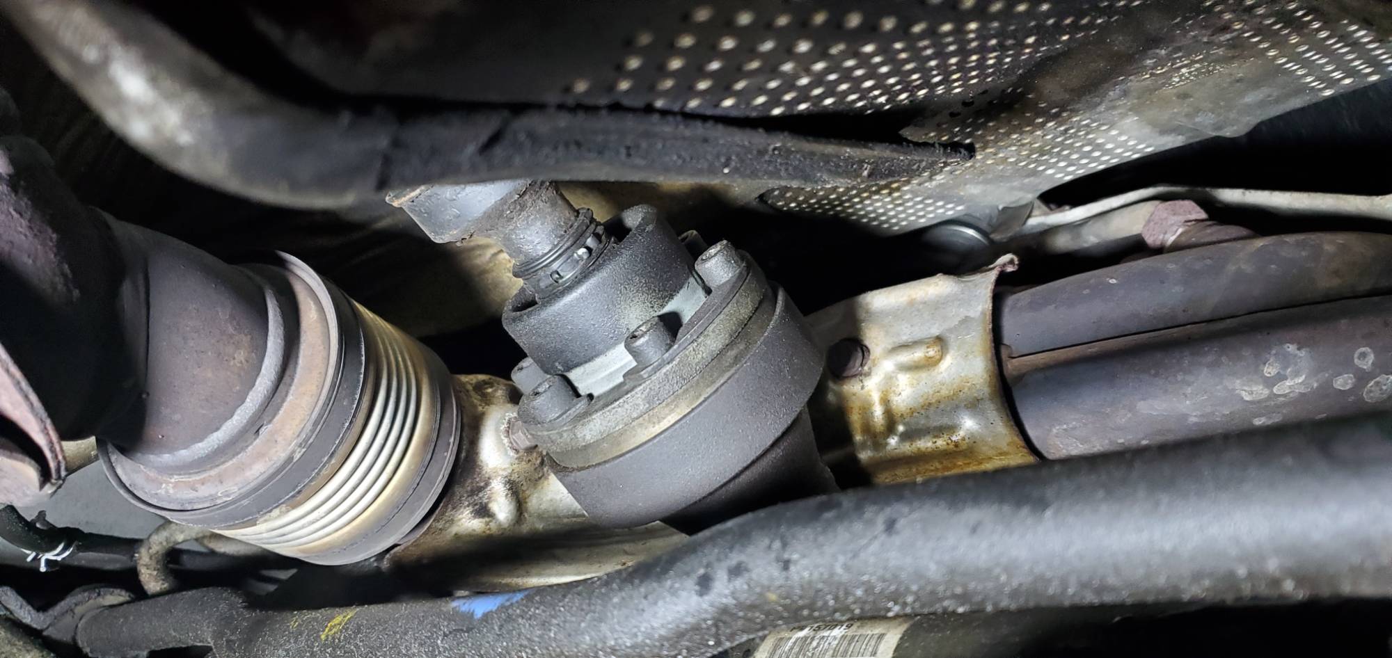

I found this heat shield had a bolt hole corroded away, but somehow it seems mounted there pretty well.
The front hydraulic mount, if it's in place with the weight of the engine, is the braided cable around it supposed to be a bit loose? Doesn't seem likely that that's the noise, but just something I noticed.
Giving the catalytic converter a good thump, no rattles, no play in the hangers. Heat shield directly above the cat is secure.

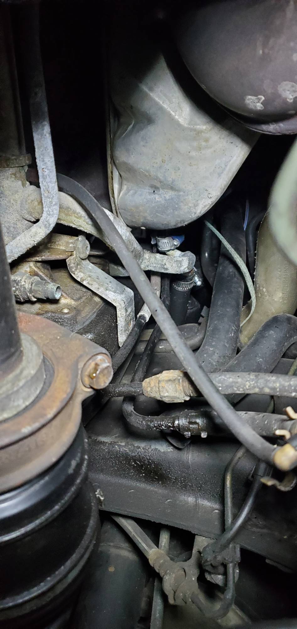

I did notice this, the fuel line bracket is missing. I'm am pretty sure I remember taking that off when I took the head out, but have no idea where that piece would have went. Shaking the lines around as much as you'd want to be shaking fuel lines, when they tap the bracket, it's more of a knocking sound, but maybe when the engine is ~1500rpm its a resonating vibration.

Put a piece of thick padding between fuel lines and bracket, then zip tie them through the hole. Old piece of radiator hose would work , too.
