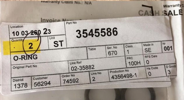

I have one!
Heater core to heater core pipes. Volvo part number 3545586.
It's actually an inch size, not metric! Officially defined as 20.78mm x 15.54mm x 2.62mm, this corresponds to a -114 (dash size) or 5/8 x 13/16 x 3/32 inch nominal size, or 0.612 x 0.818 inch actual size.
Buna-N and EPDM are pretty equal for coolant applications, having equal resistance to ethylene glycol and both tolerating temperatures the coolant is likely to reach. A generic hardware store o-ring will suffice for this job. Hopefully this should get someone out of a pinch (literally, perhaps, if they pinch the o-ring!).
I did a ton of research about this because I had a leak at a newly-installed heater core where it joined the pipes. It was a MTC brand heater core from IPD. Turned out it was defective, one of the o-ring bosses was misshapen and would never seal!

Can you help me confirm if this kit has the o-ring I need? I think A114 is the part number.
https://www.harborfreight.com/180-piece ... G4QAvD_BwE
If yes, then I'm banging this out tonight before we set off to Michigan (well, first Ohio, as that's our overnight stop).

I don’t think that Harbor Fright kit will fit. See sizes above
