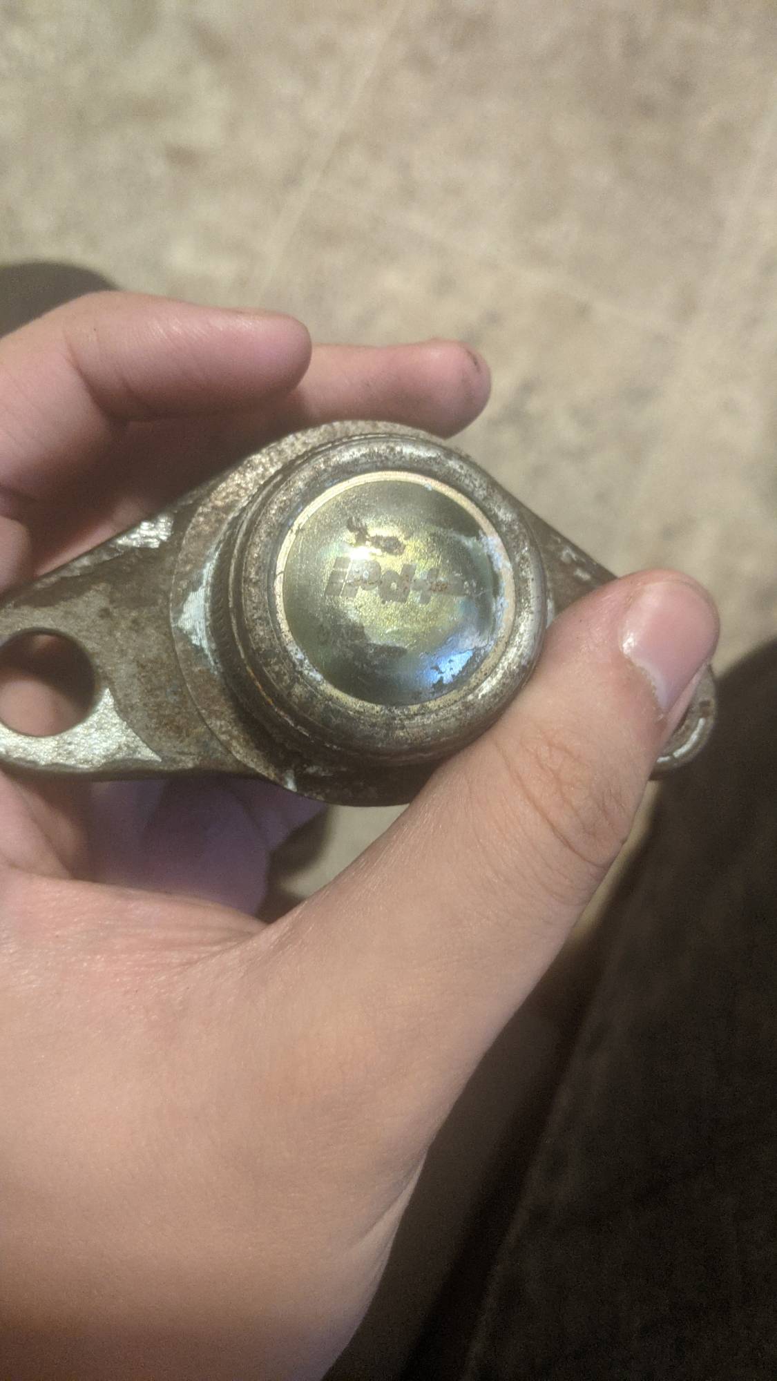

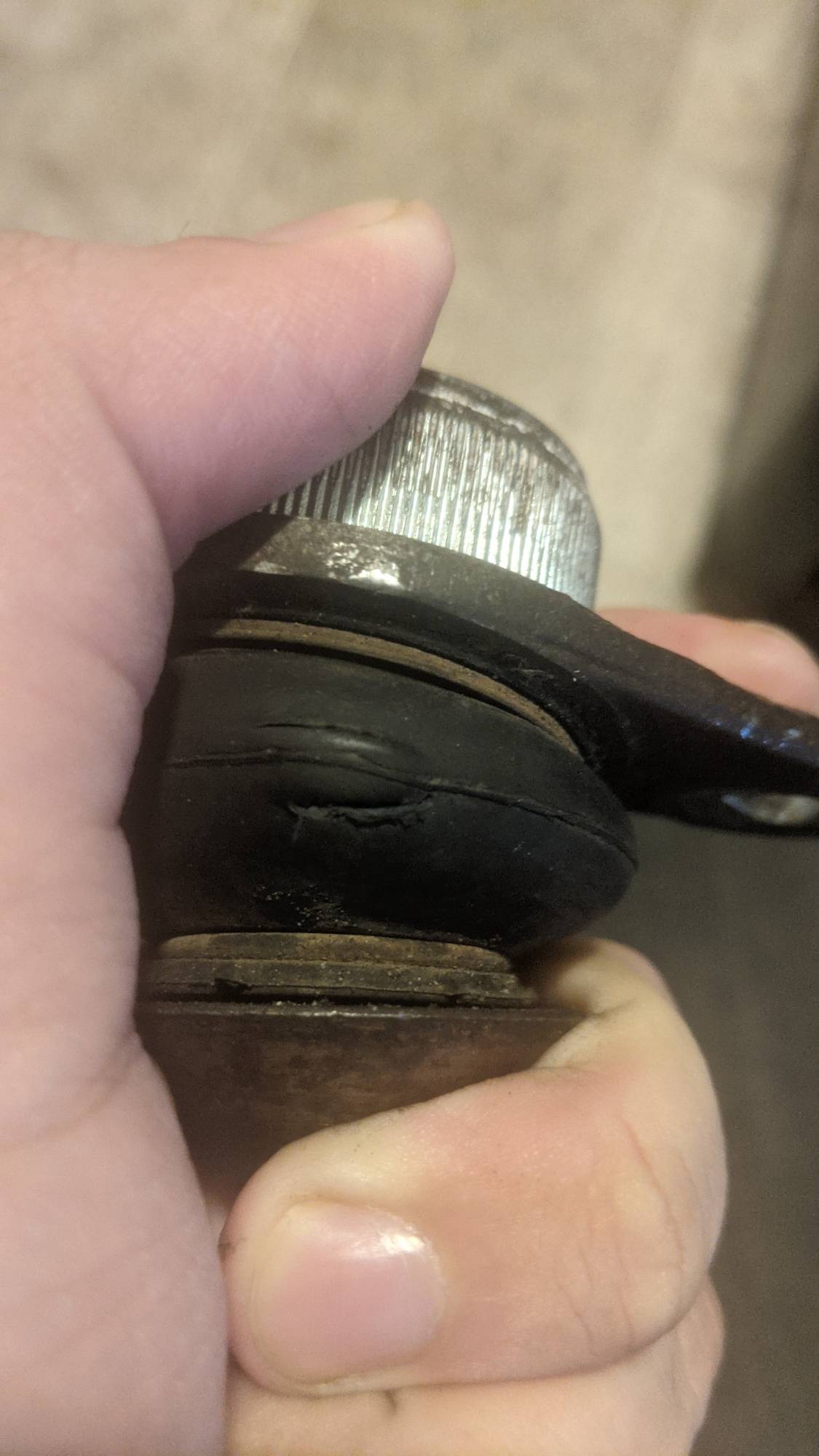

My 2 ipd ball joint didn't last 2 years, as well as the silicone top engine mount.
I'd 100% be ready for those ball joints to fail. Silicone boots is the entire point for selling this thing and it doesn't hold up to new england seasons.

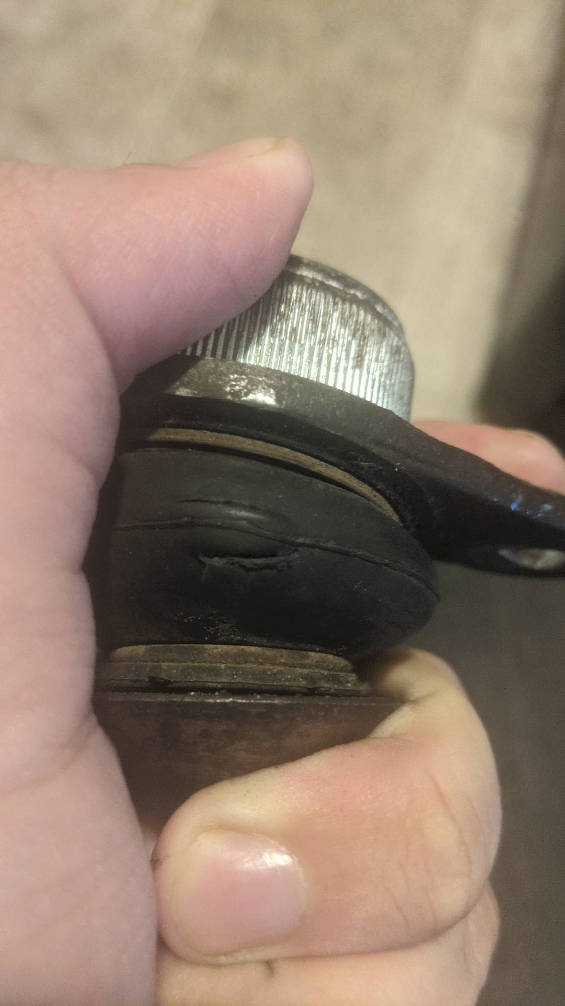

Yes they actually failed 1.5 years in. I heard very loud squeaking while turning late fall, but I just couldn't get to it until the spring.Mike98 wrote: 23 Mar 2023, 13:06
Did the blue silicone boots fail on your IPD HD ball joints ? So far my boots look OK after 10K miles but the winter climate in Va is mild compared to New England.
I'd say I almost got to 10k so I think you should give it an inspection, but the only way to get a full 360 view on the boots is to remove the knuckle off and see whats going on. Also, I actually thought it was only one boot, but one was squeaking while the other I could see it broken.
And then there was this weird corrosion coming off the boot. Made the entire knuckle somehow glued to the control arm.

The ball joint boot in your pictures looks black. The IPD HD ball joints that I bought directly from IPD in August 2021 have blue boots. Did IPD change the boot color or material ?chris11211 wrote: 23 Mar 2023, 19:55

I got it indigo just like what's on their picture on the website. Also it's just darkened due to just where it's at.Mike98 wrote: 23 Mar 2023, 22:13 The ball joint boot in your pictures looks black. The IPD HD ball joints that I bought directly from IPD in August 2021 have blue boots. Did IPD change the boot color or material ?
Mines is older, and I think they just tend to buy the cheapest blues at whatever time they order it from Taiwan.

As for the photo I didn't read the entire post thoroughly but to be fair the IPD ball joint boot was pinched / mechanical damaged and not from failure.
