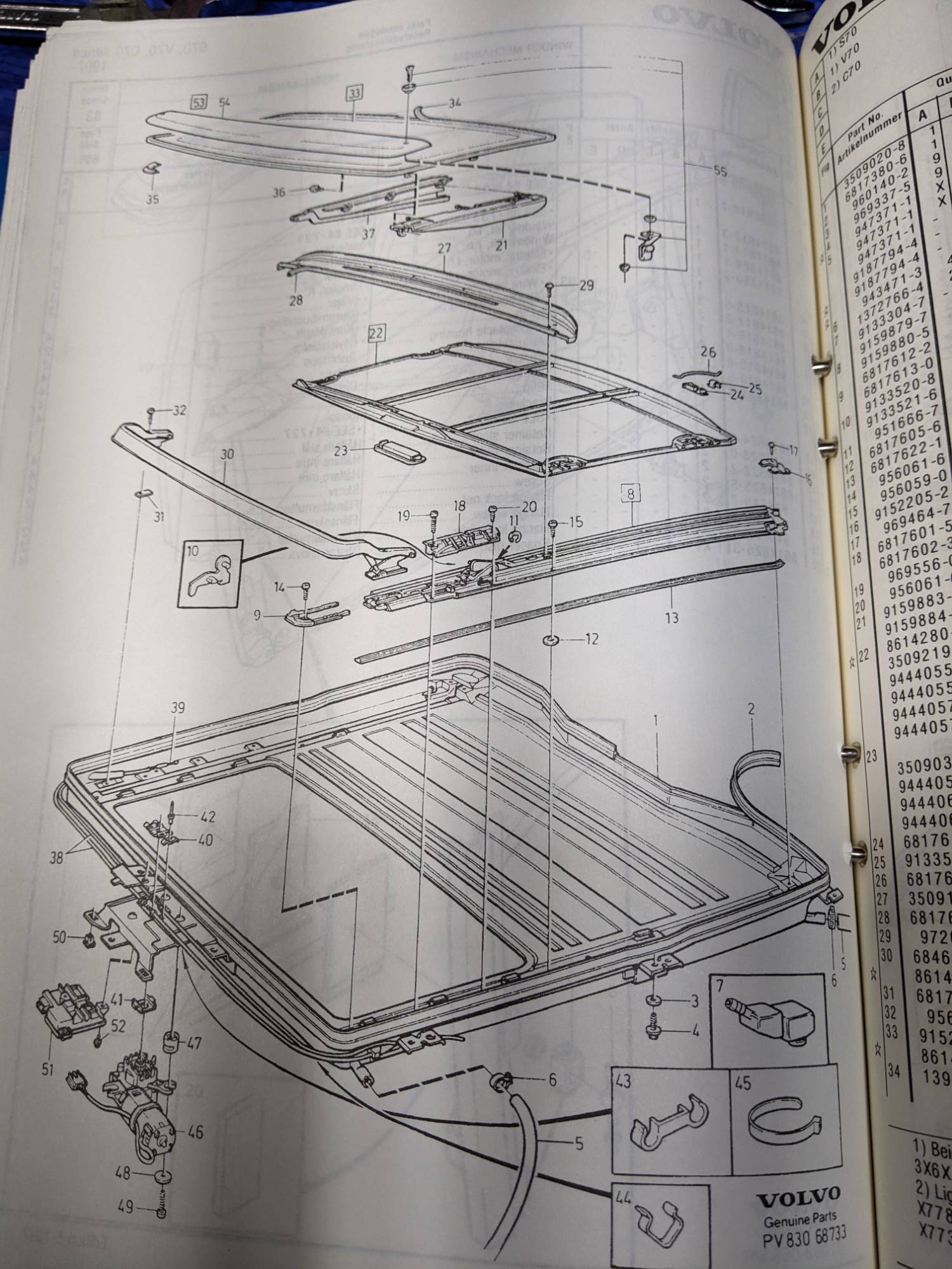

Just discovered the same issue, front passenger's track arm sheared on my '99 V70 XC. Do we have any good instructions laying around for removing just the cassette if possible without having to pull the headliner out? In my case I may be able to get away with some Dremel and epoxy action as it's the pot metal portion that broke.

Looking at the parts drawing, I don't see a way to remove much other than the glass without taking the cassette out which unfortunately means the headliner too.
If you go onto the Volvo OE parts sites with their parts layout you can see what I mean. Not great but you can see from this drawing from a 98 Volvo hard copy parts book:
Hope this helps.
Hope this helps.
