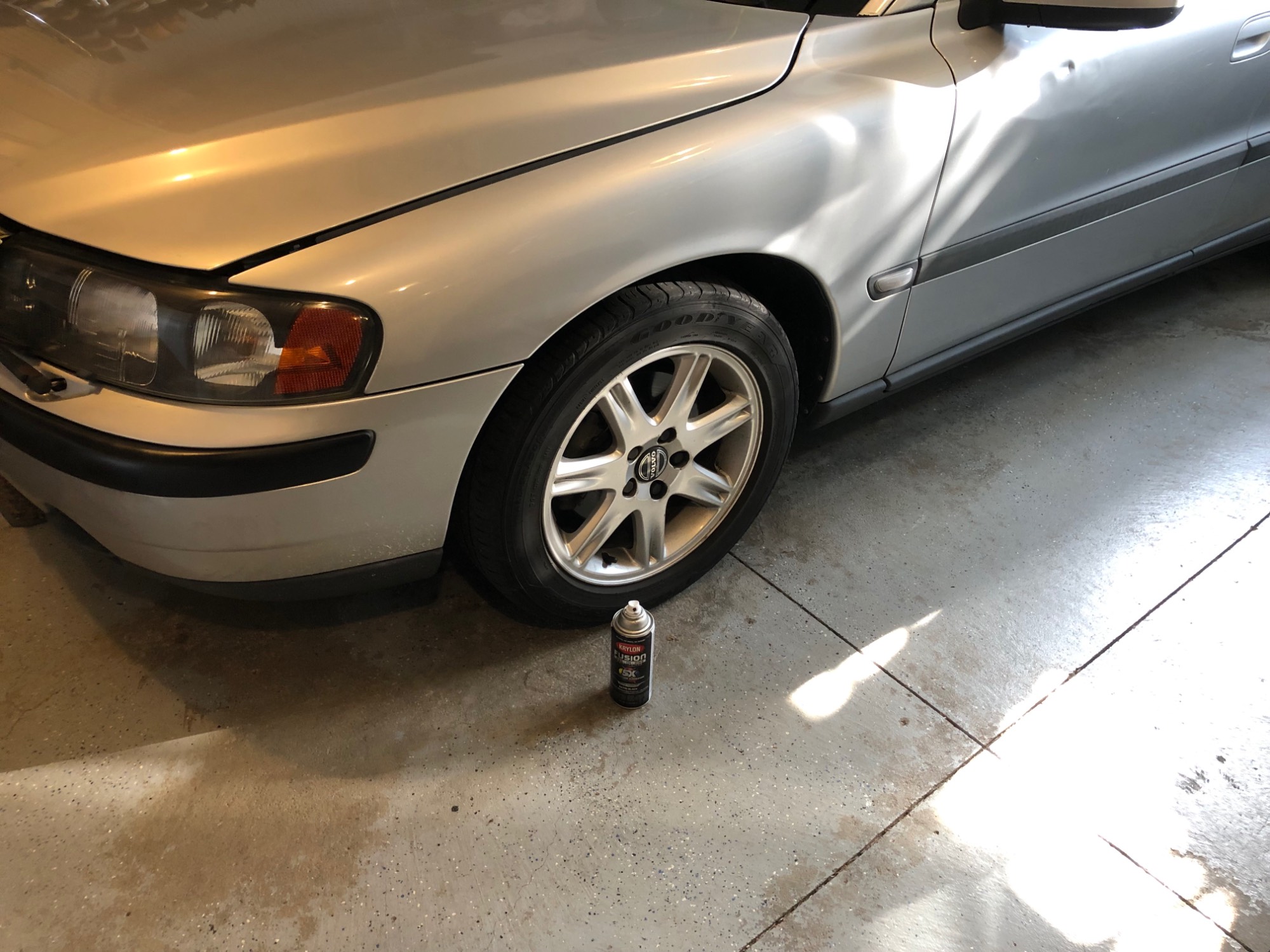

Krylon Fusion (plastic compatible)in Satin on front bumper, wish I would have done flat as it still has more shine than I’d like. Still debating whether to switch to matte on the rest.deano1 wrote: 07 Jun 2023, 04:34 Hey there

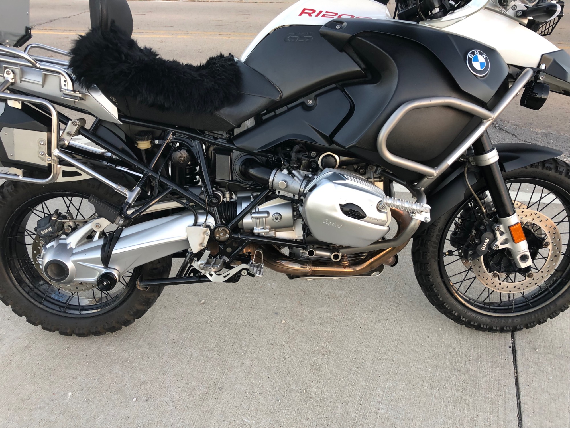

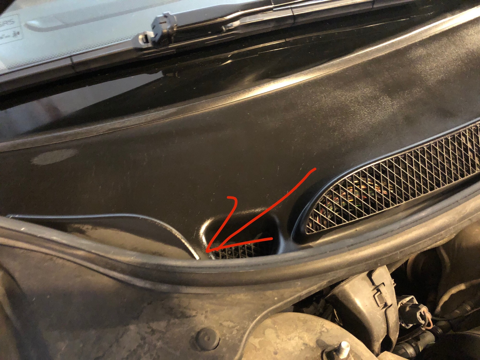

Update on another solution for faded plastics. For winter riding this year I’m coating my motorcycles with ACF-50. ACF is ‘anti-corrosion formula’ originally developed for the aircraft industry.
Anyway, I was so impressed with the results on brightening/darkening the black plastic on my old BMW I thought I’d try it on my windshield sill tray on the S60 that was a quite faded gray. Wow what a result. I’m a couple weeks after doing my bike but still holding up, hopefully this will be my go-to. Not cheap but the best product I’ve found before resorting to paint.
It is an oil based product so after a soak need to wipe to attract less dust. They say on metals it provides up to 12 months of rust protection (if not soaped off, have to rinse only w/ cold water for salt protection. Hopefully it’ll moisturize the plastics a good long while.
Some photos after 24hrs, arrow indicating parts I missed: After first ride after applying ACF-50:
