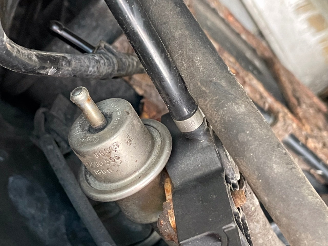

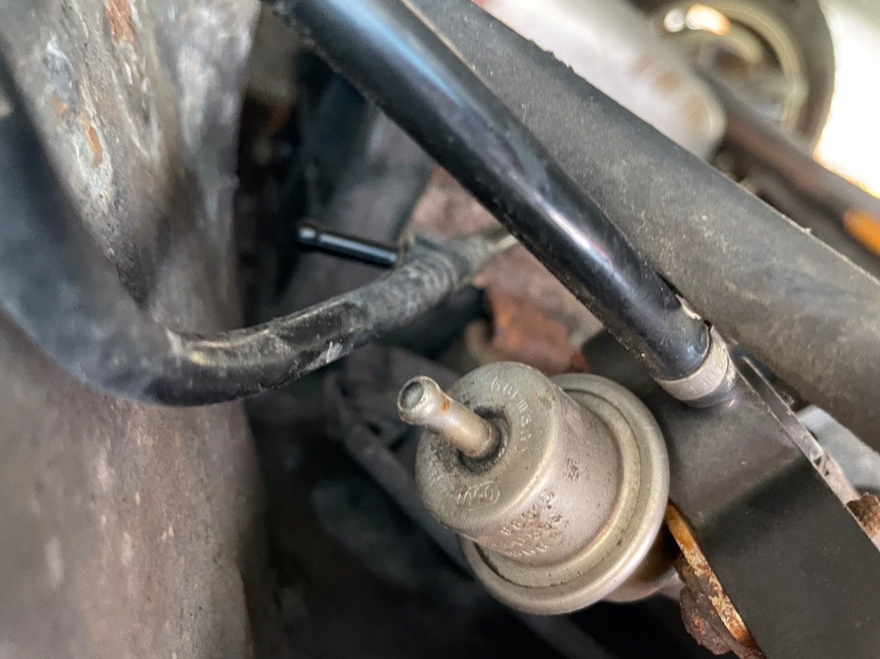

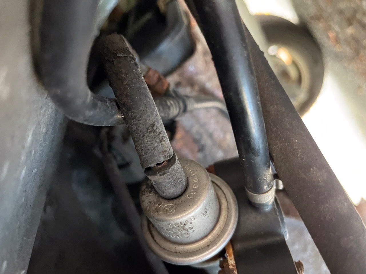

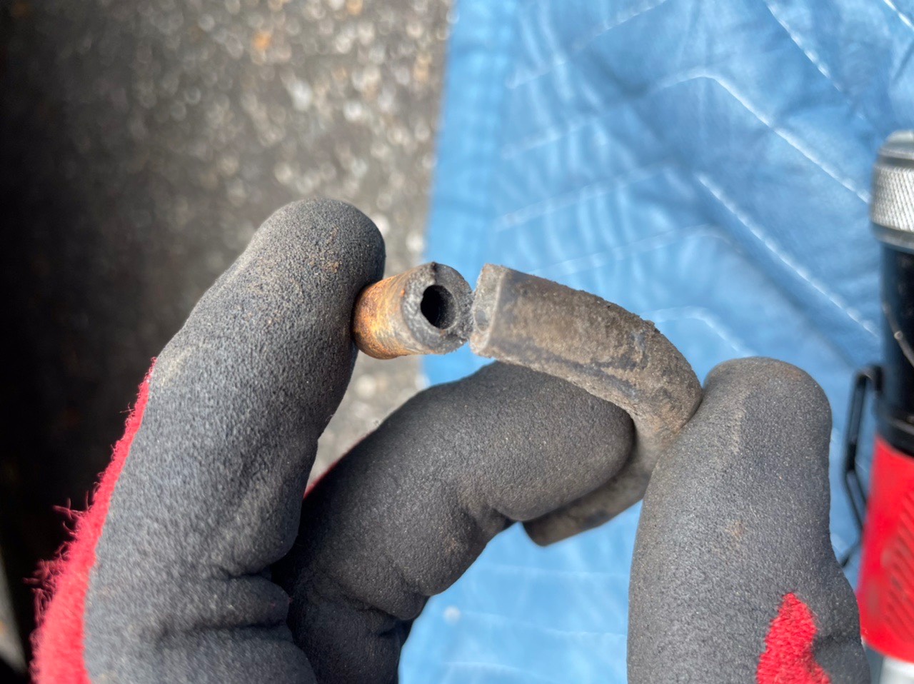

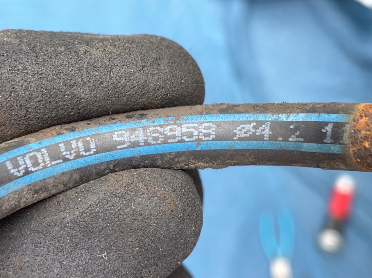

I took a quick roll underneath to check the integrity of the canister hoses and found the little guy teeing off the evap line to the fuel pressure regulator was broken, so did a quick fix with silicone hose. 4.2 mm is the listed size
Volvo part 946958 for purists

With my New fresh repair on my purge valve to FPR hose, EVAP and OXS monitors went ready in 30 miles. CAT monitor still not ready but I can inspect with two monitors Incomplete in NY

P440 for purge valve fault would occasionally show, on about 6 month intervals, often pend with no light. Classic case of the code pointing to wrong component.FireFox31 wrote: 17 Aug 2023, 20:40 What symptoms showed you that the purge valve failed and/or that the vacuum line cracked? Did you have a DTC code? This is a part I haven't thought about and, knowing old Geronimo, it's probably failed.
New found knowledge. If the evap monitor doesn’t set, the CAt and OXS monitors take a long time to set, like the 500 miles we see people report. Get the Evap to go, and things cascade to ready much quicker

*********be careful pulling hose off thst nylon nipple. Do not break me… major pain to bond a T into the purge vac yum line
