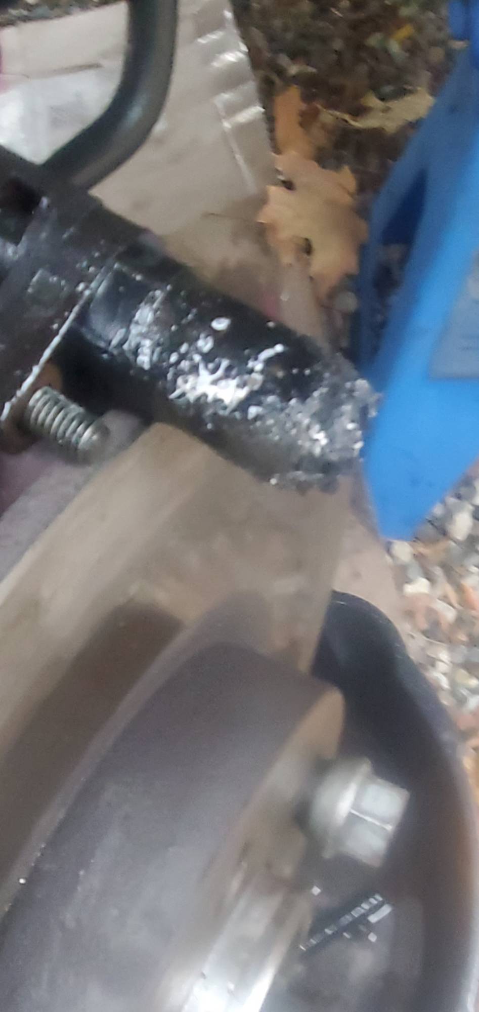

Let me update you guys, some good news and more bad....
1. Alignment is fixed, I took everything apart, and put it back together, but this time I only jacked up the driver's side and ensured the steering wheel was straight before tighting the control arm bolts. Before I had both sides jacked up, which I believe allowed the mis-alignment.
Regardless, it's now aligned.
The grinding noise is still there. ABS light comes on intermittently, and the braking is crazy, sometimes stiff, sometimes loose, often ABS pumping. The car veers right while braking, which has me thinking the left braking is not engaging. Visually everything looks fine. I even removed the caliper, and it looks fine. Thoughts on what to do next?
I'm thinking, check the ABS tone ring, clean the ABS sensor, and check the ABS wire connection? Retorque the CV axle? And check the control arm ball join.

The best way to diagnose those tone rings (ABS sensor wheels) is to use a wheel speed readout on a decent scanner. Often they fail with a noisy signal that fools the ABS module into thinking there is wheel slip

For the grinding, check the simplest things, like the brake dust shield being bent onto the rotor.

Neil, you're right, the dust sheild is touching on the left side, but not the right wheel.scot850 wrote: 29 Oct 2023, 08:30 For the grinding, check the simplest things, like the brake dust shield being bent onto the rotor.

Simple answer is no. It is easily bent back away from the rotor. Finger pressure is enough. You only need 5mm/ 1/4" of a gap or so. The dust shield is very thin so it doesn't take much to bend it out of position. No need to remove it or anything else. Just bending on that lower edge is all that is needed.
You are getting there! It is amazing how that simple touching of the rotor and backing plate makes it sound like the car is about it disintegrate!

Neil, I bent it back, I also cleaned the ABS sensor as it was very dirty. Possibly from the sheild /rotor dust.scot850 wrote: 29 Oct 2023, 12:34 Simple answer is no. It is easily bent back away from the rotor. Finger pressure is enough. You only need 5mm/ 1/4" of a gap or so. The dust shield is very thin so it doesn't take much to bend it out of position. No need to remove it or anything else. Just bending on that lower edge is all that is needed.

Certainly cleaning the ABS sensor is always a good idea when you can as it is amazing how dirty they can get.
Hopefully the grinding noise is now gone!?
