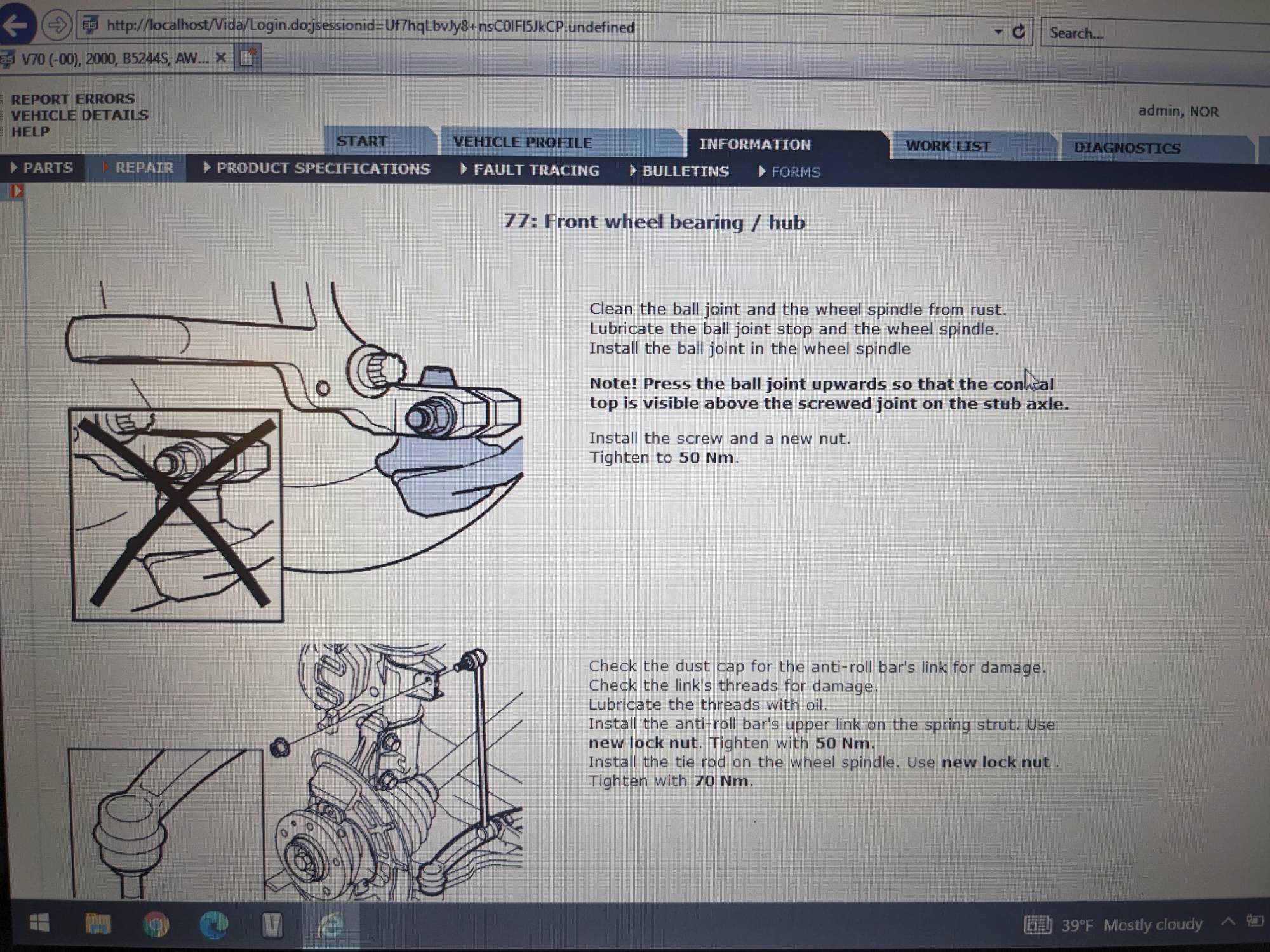

If you did remove the ball joint pinch bolt, make sure the ball joint is fully seated before installing the pinch bolt. It is possible to assemble it with the bolt over the ball joint shaft instead of through it. Compare it to the one on the other side of the car. You may need to use something like a scissors jack to hold the control arm up in the proper position.

Here's the official VIDA documentation showing what chrafael means.
And to correct scot850, you must replace the nut for the control arm ball joint to steering knuckle pinch connection. Haynes doesn't say it's single use and it doesn't require angle tightening (torque to yield), so I checked VIDA to be sure. I'll swap out my nuts on each side when I do my suspension since I've removed and replaced them a few times recently.

I disagree with this. Experience has shown several owners have had the bolt shear after re-use. Go ahead and re-use, that is your call.
- Posts: 36147
The ball joint nut has an elliptical exit port so that it self locks. Reusing the nut will mean it doesn’t lock. It’s not that tight as it holds the ball joint in by lateral shear, not bolt tension so you need the locking action of a new nut
