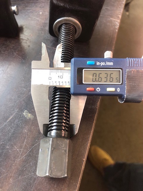

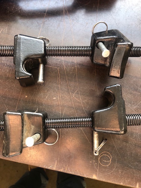

Here's the spring compressor, It's from Princess Auto here in Canada, made by Powerfist which is their house brand. It's very robust and unlikely to bend or break, I've used it on larger springs also. It has a 21mm bolt and locking pins and compact enough that you probably could get 3 maybe 4 on a spring if you're uneasy with the job.

I like the pins to contain the coils. When I was looking for this style years ago, there was nothing to be found like that.

.Blacklab467 wrote: 20 Nov 2023, 13:23 s.jpgsize.jpgSpring Compresser.jpg
That does look beefier than other compressors. I've Bookmarked it and hope to remember to compare it with the rental. Thanks.
