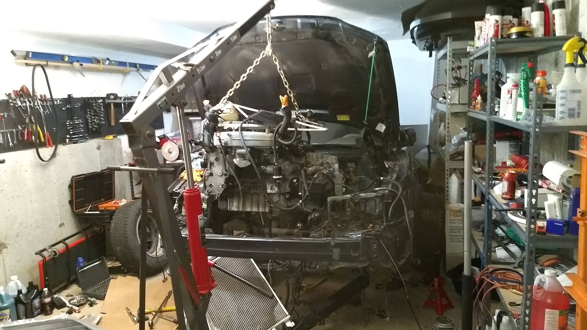

For sure take the transmission with it. Take angle gear as well, it may have less splines damage than yours. Perhaps steering rack, too, but pay attention if any wheel was forcibly moved - these racks don't like that.
Remove the front end. Cut off downpipe. Remove all cables from the engine. Support the engine/transmission on the hoist. Unbolt right engine pad (behind passenger wheel) and cut off front and rear pads. Oh, and unbolt transmission torque rods, or "lower" and "upper" pads as they are called sometimes, and upper cross bar. You need to decide what to do with A/C compressor. If the lines were ruptured and it sat like that for a long time then the whole system is FUBAR and you can simply cut the lines.
Then engine/transmission should go up as that, slightly tilted to passenger side to avoid ABS. Which you can unbolt and move aside a bit, or cut the lines.

When the engine is in new garage - do yourself a favor and replace the rear main seal and exhaust manifold gaskets. Everything else is accessible, but especially RMS is a pain to do when the engine is in the bay.

I did that without emptying the A/C. You can see A/C condenser laying on the garage floor on one picture posted above and A/C compressor still connected to the lines on another.VolvoDJ wrote: 28 Nov 2023, 15:12 AC is evacuated on the donor due to accident damage, but I'll have to work carefully with that on the recipient when I remove that engine. According to Haynes it can be done without disturbing the system...we shall see.
