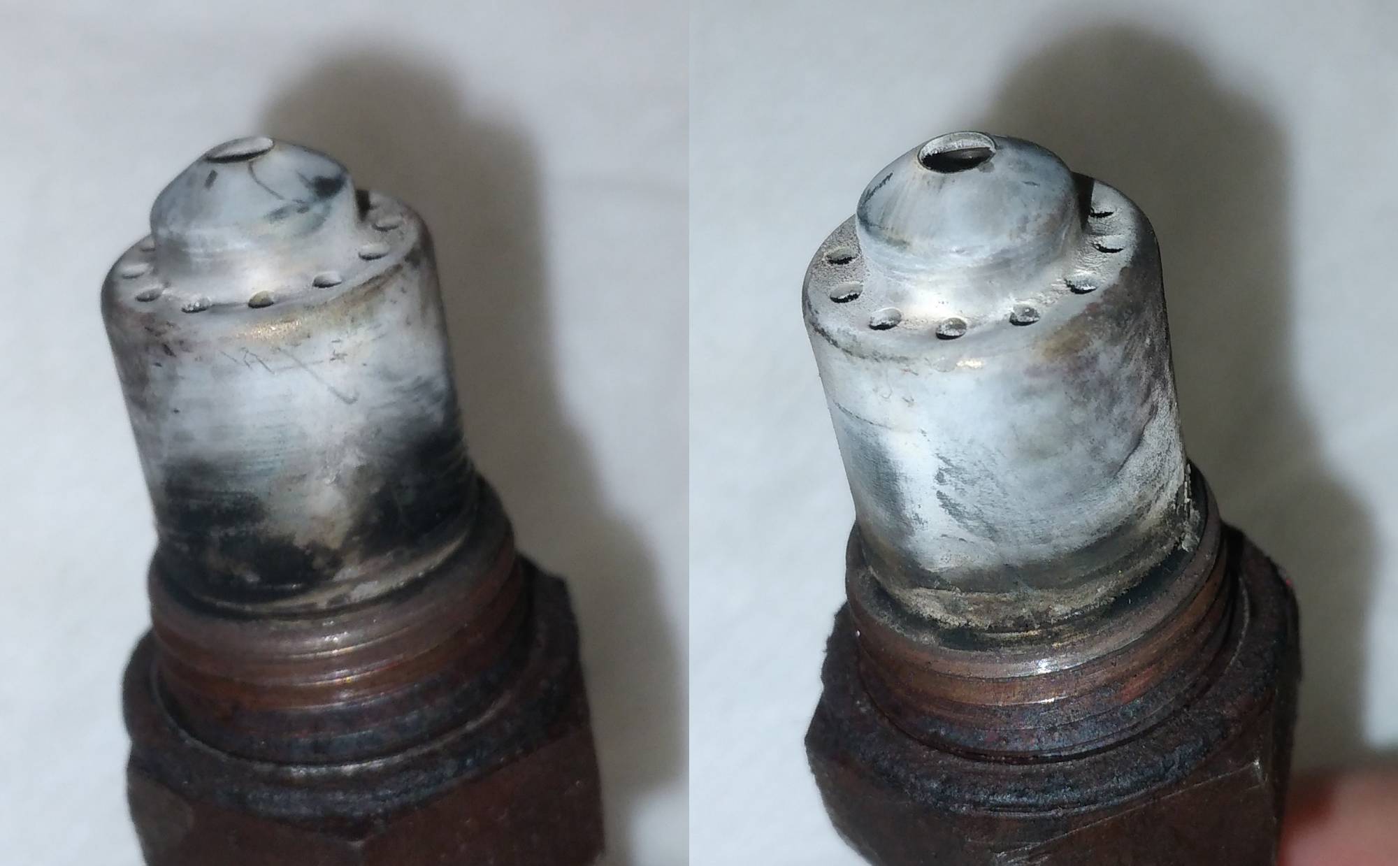

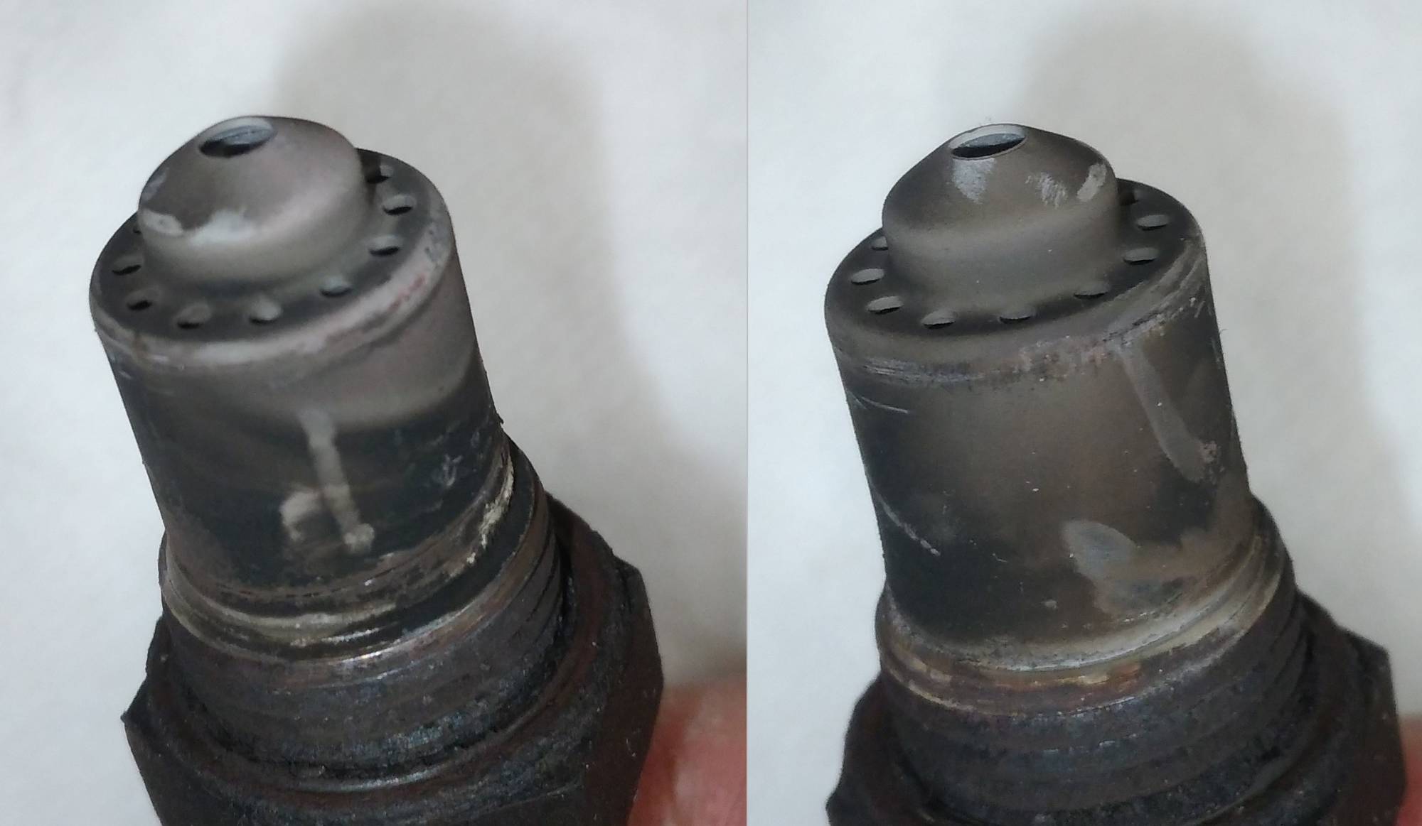

new O2 sensors in... Volvo sure knows how to make it difficult to access.
Signal is still same as before it seems. don't notice any real changes. Old sensors seem alright?
Double checked the hoses buttoning up after VVT seals, all seemed in place. Will check the hoses again in the morning.
old B1S1 sensor
old B1S2 sensor

The OXS get old and slow after 100,000 miles. Visual doesn’t really tell you anything.
