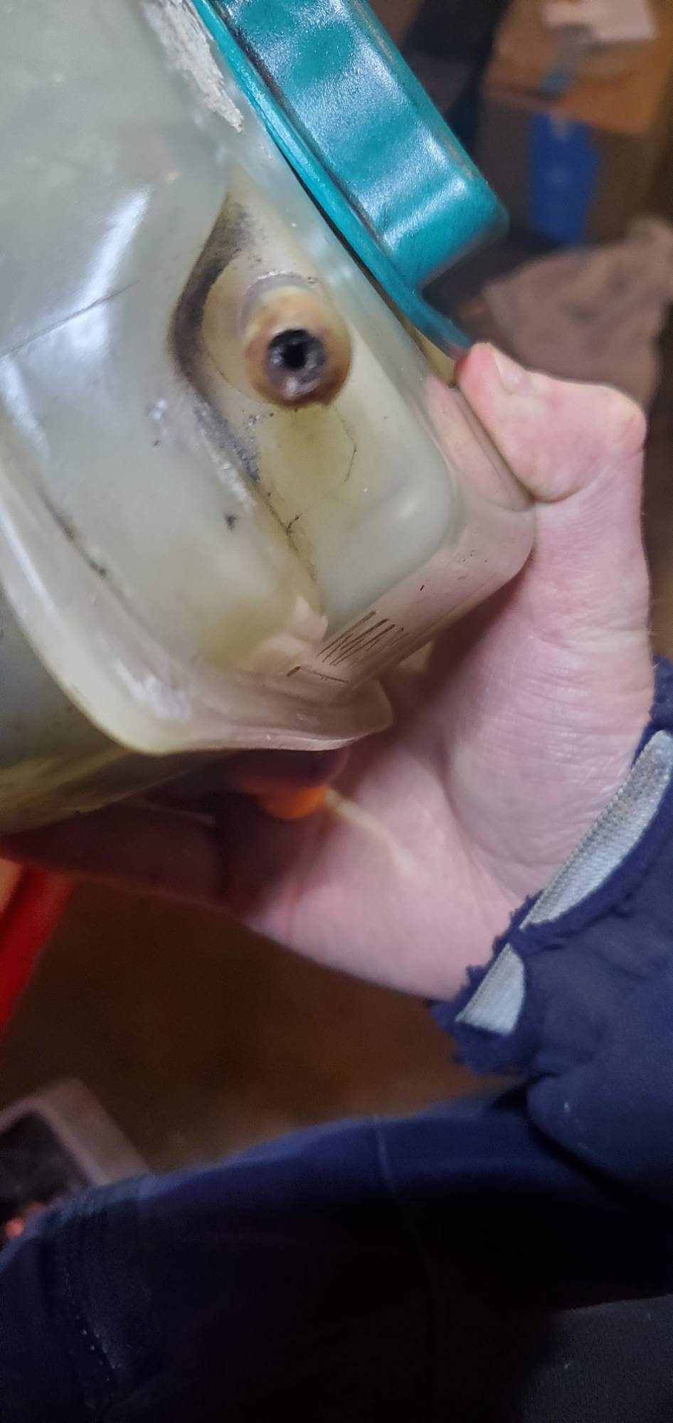

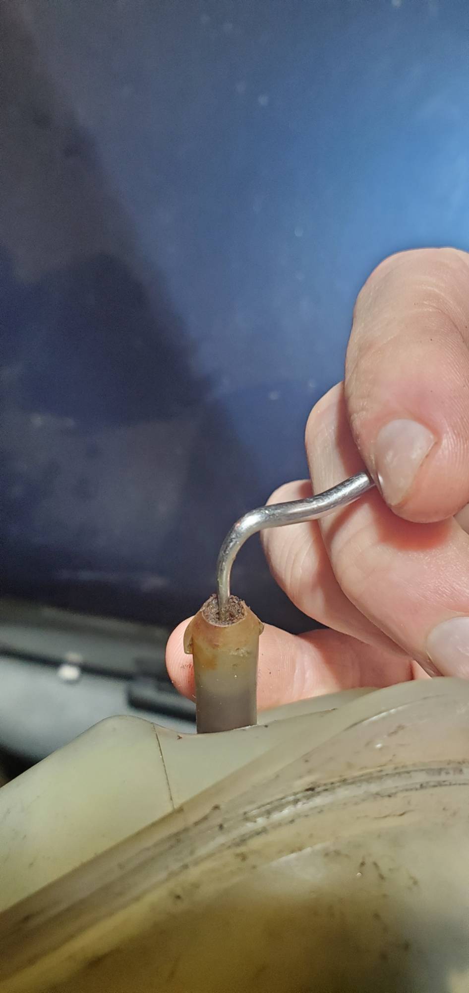

I finally got around to taking the heater core back out to replace the o-rings to solve the slow drip and found that I had overtightened the flange and flattened the o-rings when I replaced the heater core.
When I looked into my coolant bottle after drying up all the drips that my hose-pinch pliers didn't stop, I noticed a lot of crud in the neck at the bottom. The reinforcement tubes on the hose nipples were severely rusted, the one on the bottom had a lot of scale, and the one from the thermostat bleeder was actually rusted closed, I couldn't blow through it.
I didn't get a picture of all the scale before I tried to clean it up, but there was definitely the potential for that breaking off and entering the cooling system. When I turned the car on after filling the coolant, I still heard the water flowing sound once the core filled back up, but after some revs it went away, but it's yet to be seen if the sound comes back.
That's as deep as the pick went, and I couldn't blow through it either.
After replacing the radiator, I filled the car with zerex g05 coolant, but I can't honestly say if the coolant bottle was rusted before then or in the process of rusting. I filled it back up this time with Volvo coolant.

jsrnsis wrote: ↑01 Feb 2024, 08:01 I finally got around to taking the heater core back out to replace the o-rings to solve the slow drip and found that I had overtightened the flange and flattened the o-rings when I replaced the heater core.
I also replaced the serpentine belt idler, FCP said INA was the OE, the one that came off of the car said FAG. Either way $40 for a roller skate bearing pressed into a plastic pulley seems a bit steep.
I think some PO hit thst cooling group with stop leak product, probably several times

It lived the first 15 years of it's life in Georgia, maybe someone was using straight water with no corrosion inhibitors that accelerated this rusting, but with the goop in the bottom of the bottle and radiator side tank slow leak I fixed shortly after I bought it, the cooling system being full of stop leak is probable.
The car is driveable, but hearing a rambling brook every time I start the car or hit the gas is not as comforting as it would seem.

Returning the ability for the system to bleed itself seems to have worked, as well as new o-rings and using a gentle touch while tightening the heater core flange seems to have done a good enough job for me to put the front of the car back together. There is still a flowing sound when the car is turned on, but it goes away after the first time the accelerator is given a good press.
I guess in conclusion, check your coolant bottle and hose that runs from the thermostat housing to the coolant bottle for blockages.
