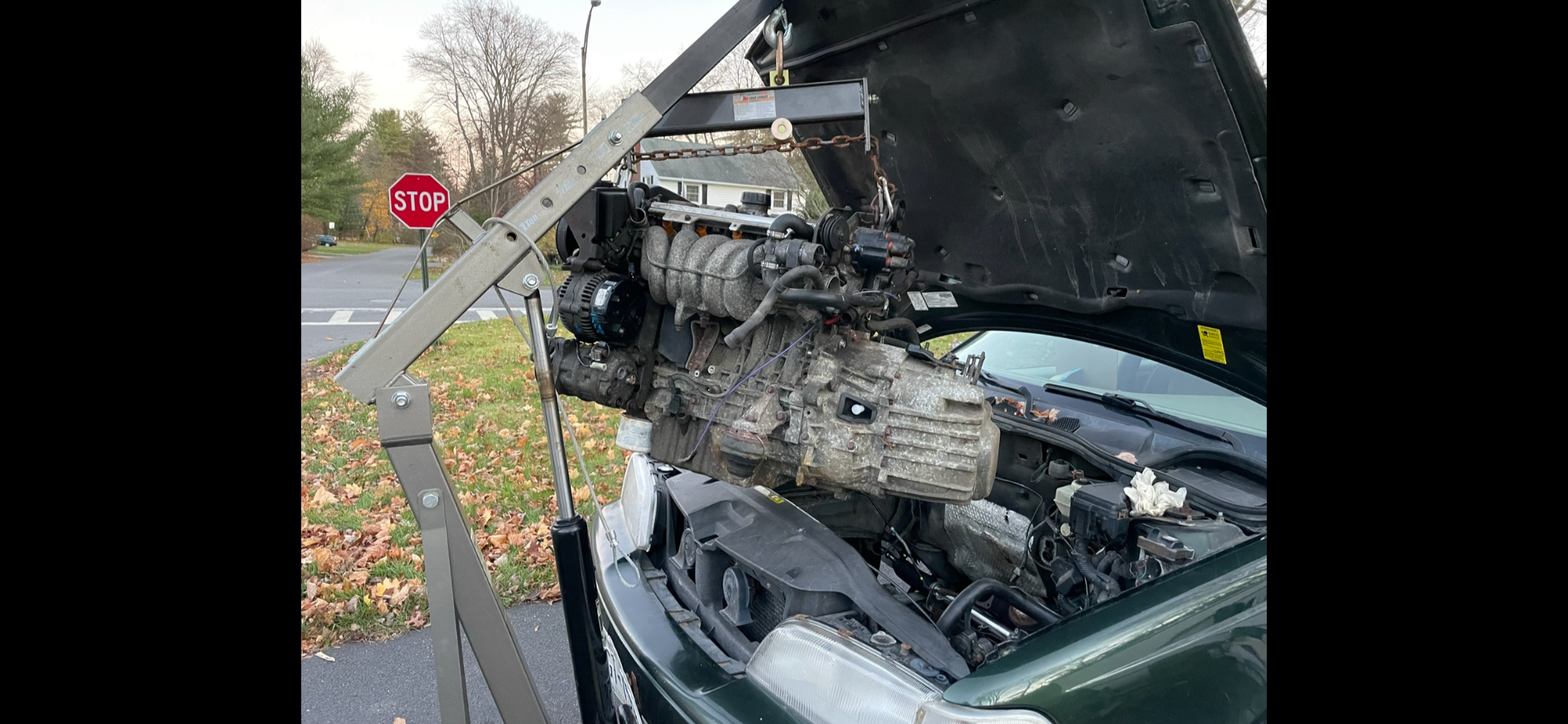

Simple, just unbolt and pull awaytjmartin317 wrote: ↑26 Feb 2024, 07:43 I’ll be seeing billy Joel at Madison square in May… if the Volvo is still having issues by then, I will most certainly be in touch… though, that offer concerns me that you think it’s a major “I’ve cooked the transmission” issue…
How easy was it to yank out? Asking in case I need to do the same…
Thats after pulling the engine of course …..
