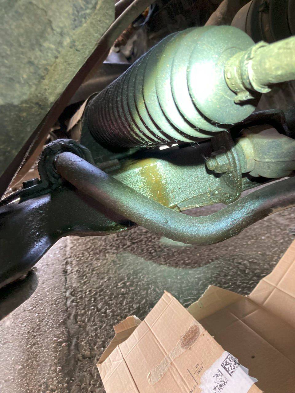

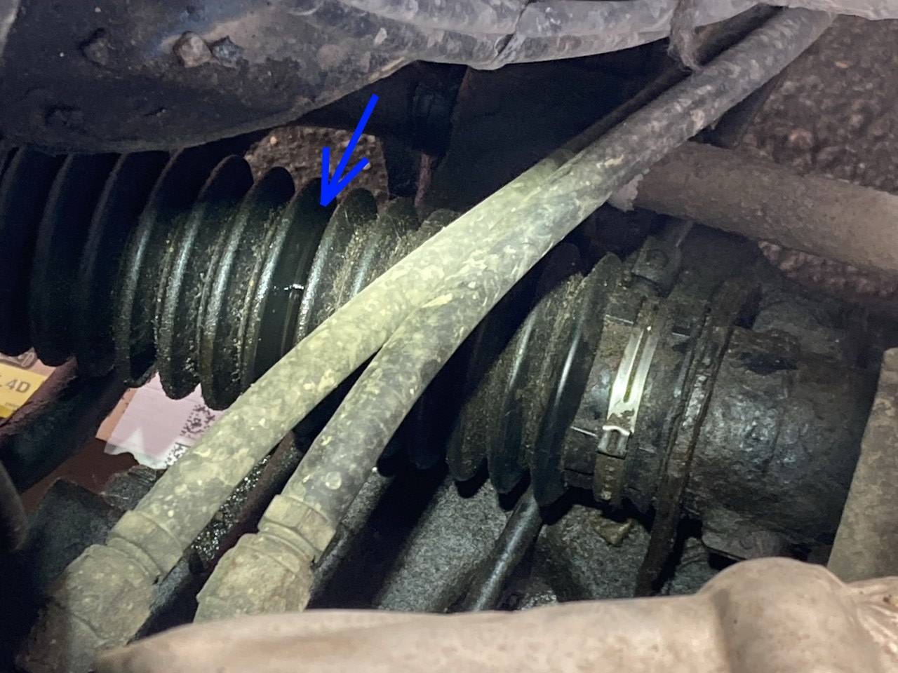

So today we finally found a moment to take a look into it. We put some steering fluid in the reservoir and moved the steering from side to side. The fluid is coming out through the dust cover on the right side (passenger side in Europe). The blue arrow in the attached picture indicates more exactly where the liquid is pouring; likely because the dust cover may be broken there.
Now the question is the following: should we straight away replace the rack or could we try to repair it with a gasket kit like the one sold by Skandix? I've watched some videos of people servicing racks and sure it is not an easy job, and it also requires taking the rack out, but that kit costs like 80€. Does any of you have experience with these kits?
In some other forums I've also read people suggesting the use of an oil thickener additive on the steering fluid as a common alternative, but this leak seems too big for that.
Additionally, I noticed a metallic sound coming from the steering pump. My friend said that this noise was gone when the workshop replaced the old one, but that it appeared again when the rack broke down. It is not the typical steering pump squeak, but more like a metallic vibration or a bad bearing on the pump. It sounds similar to when a car has bad valve lifters. This makes me think the new pump may be damaged from driving without fluid, or maybe it just sounds like this because the steering fluid reservoir is empty.

I think the LHS on LHD cars is fairly easy to do without removing the rack. The RHS is a rack out job from what I have read due to lack of good access.
Like you say, there are kits out there to repair them. In this case it looks like the RH main seal has blown out.
As to whether to repair or replace, that depends on if there is anywhere in Europe you can get a decent rebuilt unit and what it costs.
Replacing the seals may well work, it just depends on how confident you are to do it.
A replacement rack should have a warranty.
