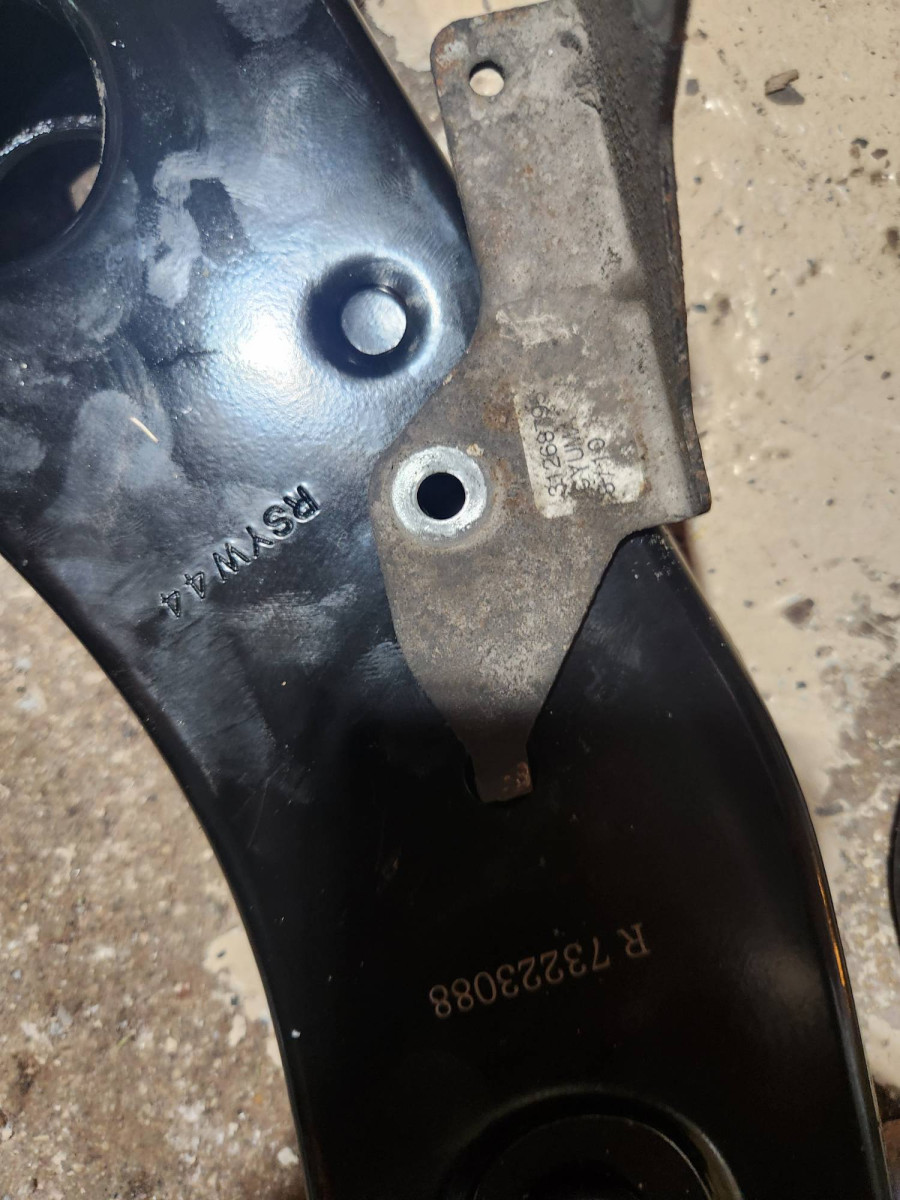

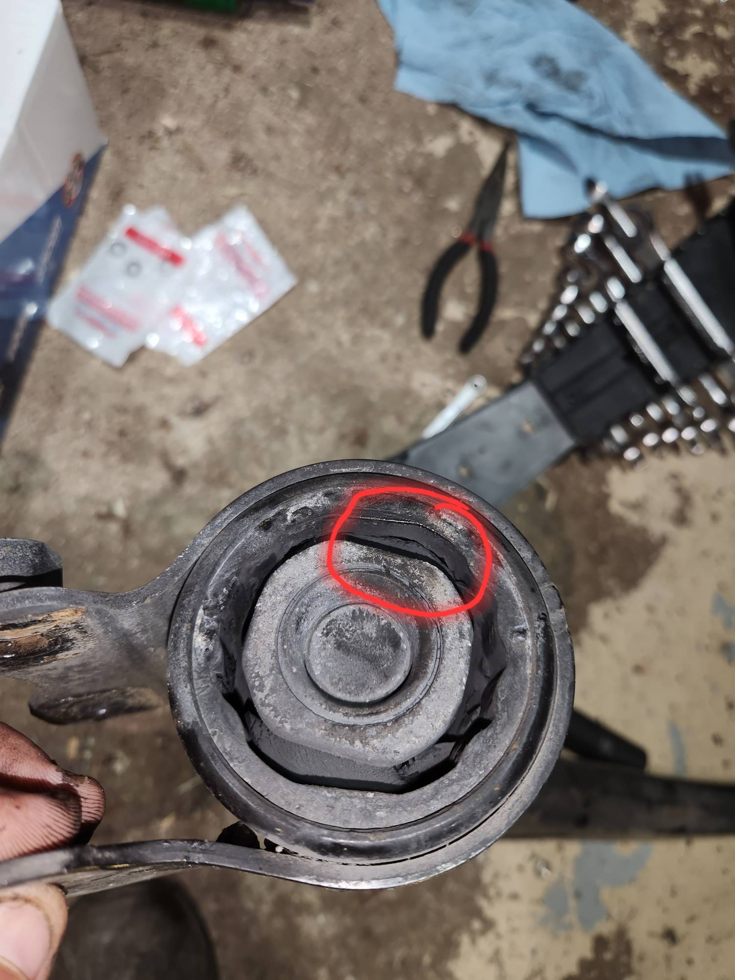

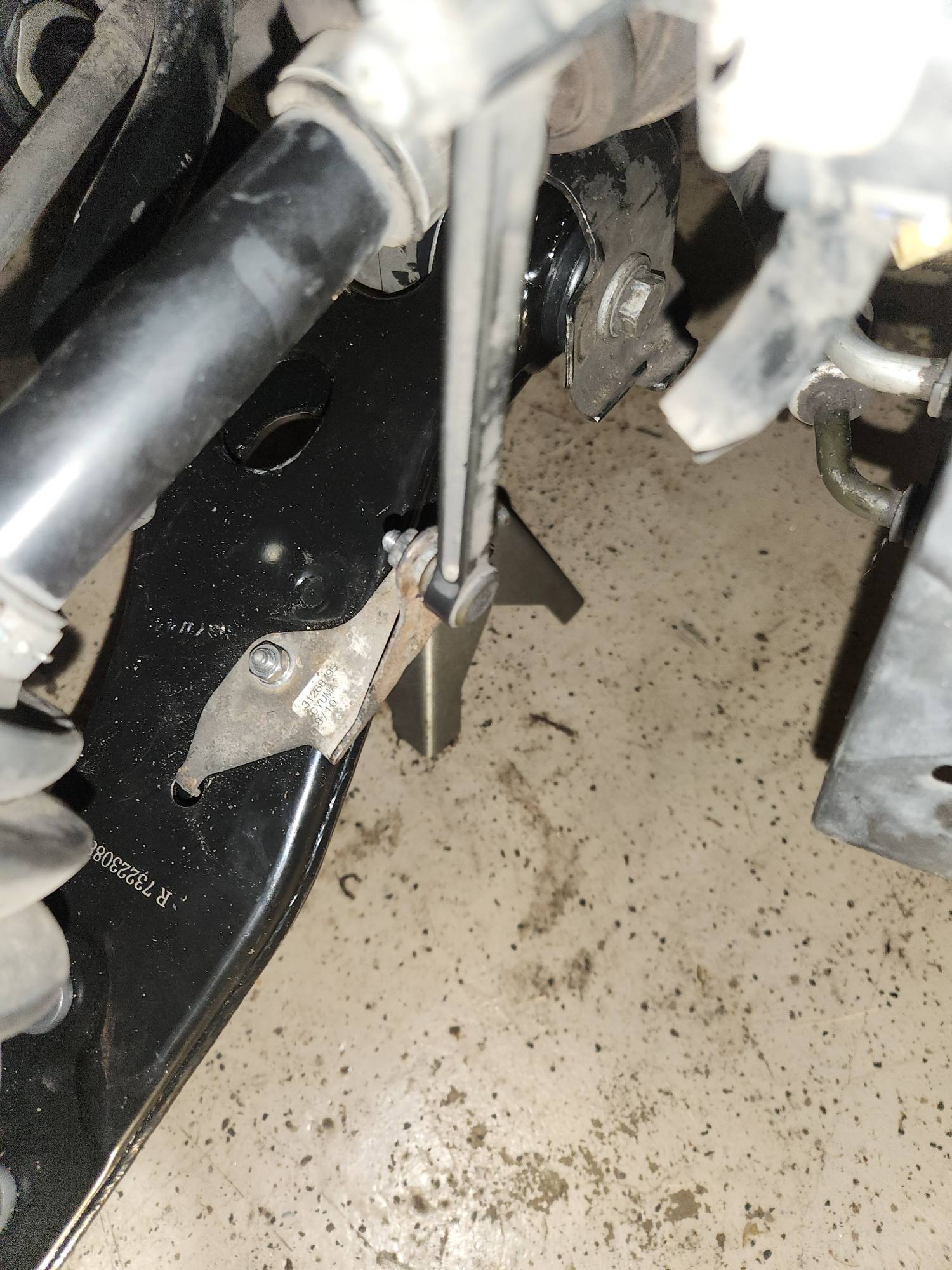

I think I figured out mine after spending way too much money. I had initially purchased aftermarket cv axles and was told that they could actually be the problem so I bought a GKN axle for the left (driver) side and had no change. Aftermarket one was probably fine. I then swapped out the right (passenger) side with an oem low mile axle BUT I also replaced my final suspension component. The lower control arms. The tear bushing on my right LCA was cracked straight through and I think that was ultimately the culprit. I did not replace with OEM on theses but kind of wish I had. I went with Moog which is good but the passenger LCA was missing the nut to mount the headlight bracket so I had to make my own. Not fun. All in all I do believe the shaking is gone and plan to do an alignment tomorrow whether it's needed or not as I have a lifetime alignment plan for my car. My motor is oddly still louder upon take off but that is a problem for another day.
