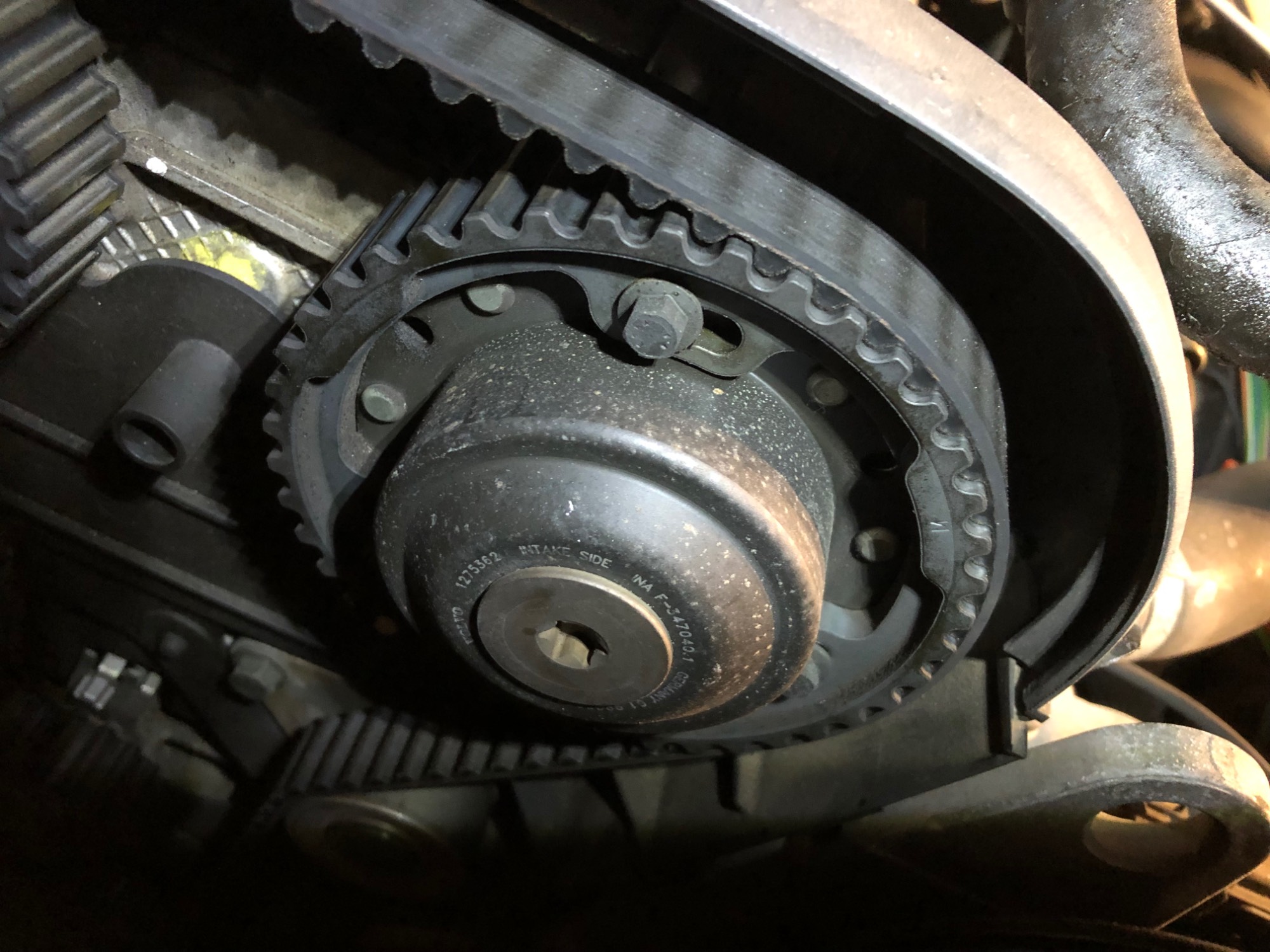

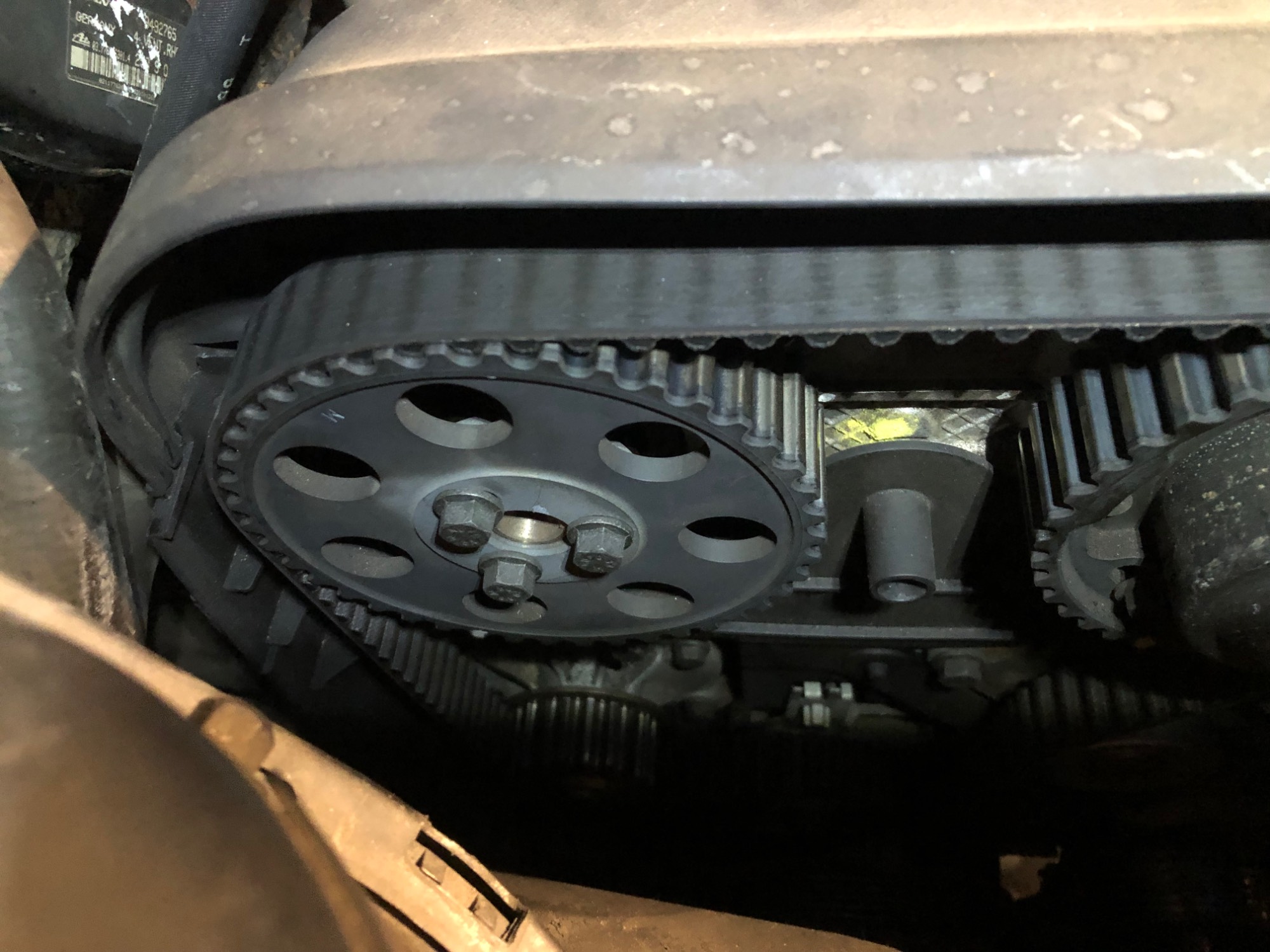

I’m working on it now and I’m stuck here. There are two markings that I can see on the sprockets, an M and a white mark. Which could it be?
I’ve uploaded photos of the sprockets, can anyone help? Thanks.

Ignore the ‘M’. Its purpose is to confuse you. The timing mark is the tiny mark, probably at or very near the white paint.
