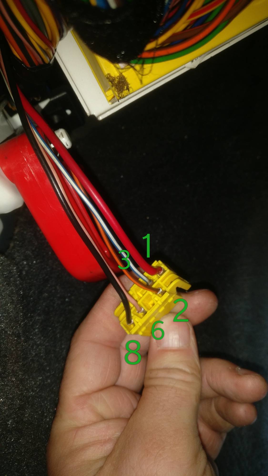

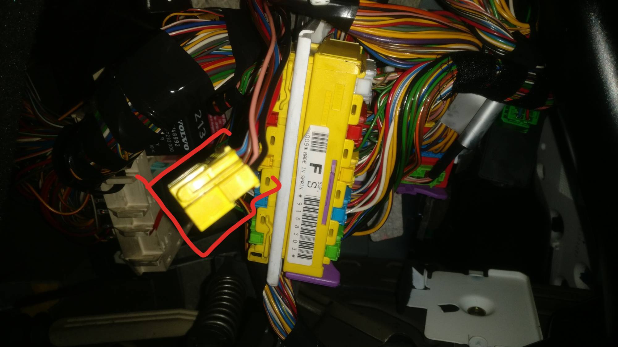

While removing the module I have noticed a cable dangling unconnected. So far I can't see where it belongs. Might be connected to the issue therefore: Anybody able to identify this cable here? It originates from a larger loom branch further up.
Thanks in advance!
Thanks in advance!

That looks like the accessory connector.

Thanks, that's it!
Just confirmed its pinout in another thread using search "accessory connector" .
My V70 has an Antenna on the roof, likely a disconnected CB aerial. Pre owner probably hooked up a tuner to that connector in the past.
