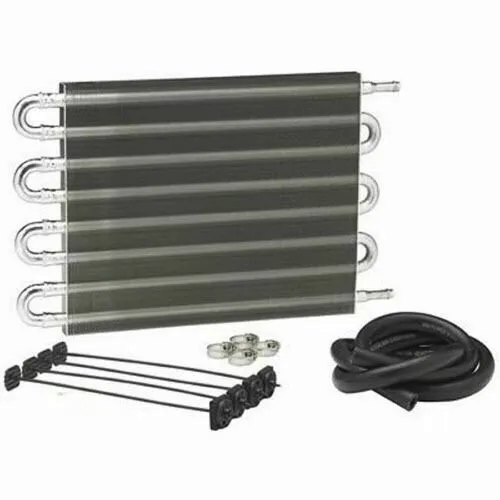

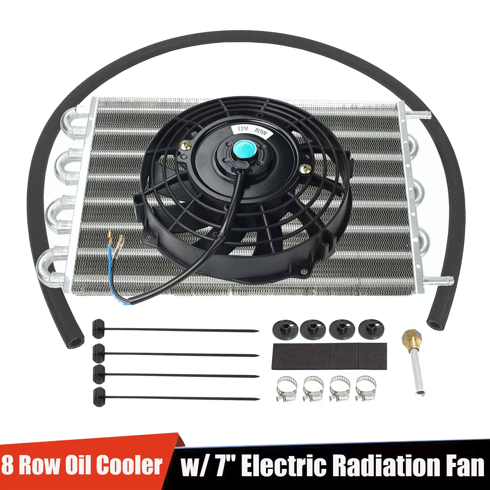

The longest car ever owned is our 03 Odyssey. Just passed 250K miles and it was purchased with 154K. The reason for a coolant change was because I replaced the radiator and did a transmission fluid bypass into a large transmission cooler. Bypass going on 5 years. I think I may have owned the van for 10 years now? Can't remember the last time I serviced the coolant in any cars owned
I've topped off during Expansion Tank changes or due to overflow from bad Caps but that's it. Most of the time just looked at the color and tried to be mindful
of compatibility
. Distill water has been the go to however.
Won't be able to comment on methods but here is excellent video info on coolants. Will watch the video again when I decide to do a drain and fill. Have 2 bottles of the Volvo stuff meaning to use on the 08 C30 for Stage 0, purchased years ago from FCP but still on the shelf.
Transmission cooler for radiator bypass. The one with the fan in the kit is new and at such a great price, like that!
