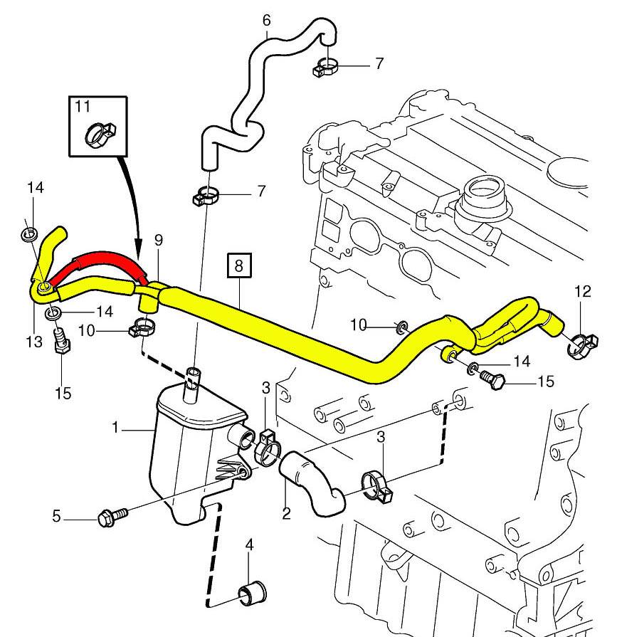

Because the glove blows up like a ballon and I'm assuming this is while the engine is just idling there is a small tube that's likely crack or plugged up, the hose or banjo bolt fitting can be plugged up, It's a small diameter hard vacuum hose going from the intake manifold to the main PCV hose, shown in red, usuall covered in foam insulator. At idle and non-boost conditions the intake manifold vacuum through this hose should keep the crankcase under a slight vacuum. At higher rpms and boost condition the vacuum is produced in the main larger hose near the turbo, the yellow hose near the #12 clamp.cmayo1 wrote: 28 Sep 2024, 15:48 Thanks, Erik. The glove tests does exactly what you expect: blows it up like a balloon. There was no sludge in the drain hole whatsoever. I have the kit for the PCV, so I'll probably just end up tackling that.
This is the hose here and can be ordered separately. The hose needs to be a hard plastic type since is a vacuum hose and I think the inner diameter is important to limit any pressure flow back to the intake manifold. This hose gets hard and brittle over time and cracks easily.

Sorry to go off-topic - did you find that graphic or add the colors yourself?

Is there really no easy way to access the PCV elements without removing the intake? I've been under that car, and there really isn't any way to get in there, but, man, for something that could just be unclogged with a pick or some sort of solution, i wish there was an easier way to do it rather than a 1-2 day project, if I'm lucky.firstv70volvo wrote: 30 Sep 2024, 12:25
I've seen that part before and was hoping not to have to order it. I bought the FCP euro kit without the cooling assembly because i knew I didn't *need* it, but I'll probably just order that part separately.
Thanks!

Saved it from some place long ago. If I could I'd change the color of the water line that heats the main PCV hose, both are currently yellow.BlackBart wrote: 30 Sep 2024, 13:41 Sorry to go off-topic - did you find that graphic or add the colors yourself?

To replace the PCV box and hoses it's necessary to remove the intake manifold. Where I wasted a lot of time was trying to get the banjo bolt started in the intake manifold (underside) without removing the PS pump and moving the alternator like CN90 mentions. I spent more than a couple of hours trying to get the banjo bolt threaded in under the manifold. Did it in under 15 seconds after PS pump and alternator were moved out of the way.cmayo1 wrote: 30 Sep 2024, 14:32Is there really no easy way to access the PCV elements without removing the intake? I've been under that car, and there really isn't any way to get in there, but, man, for something that could just be unclogged with a pick or some sort of solution, i wish there was an easier way to do it rather than a 1-2 day project, if I'm lucky.firstv70volvo wrote: 30 Sep 2024, 12:25
Thanks!
See CN90 post and I'll just add I removed the turbo to intercooler pipe over the engine and the fan shroud assembly to get to the lower alternator bolts and better access to the to the throttle body intake pipe clamp.
