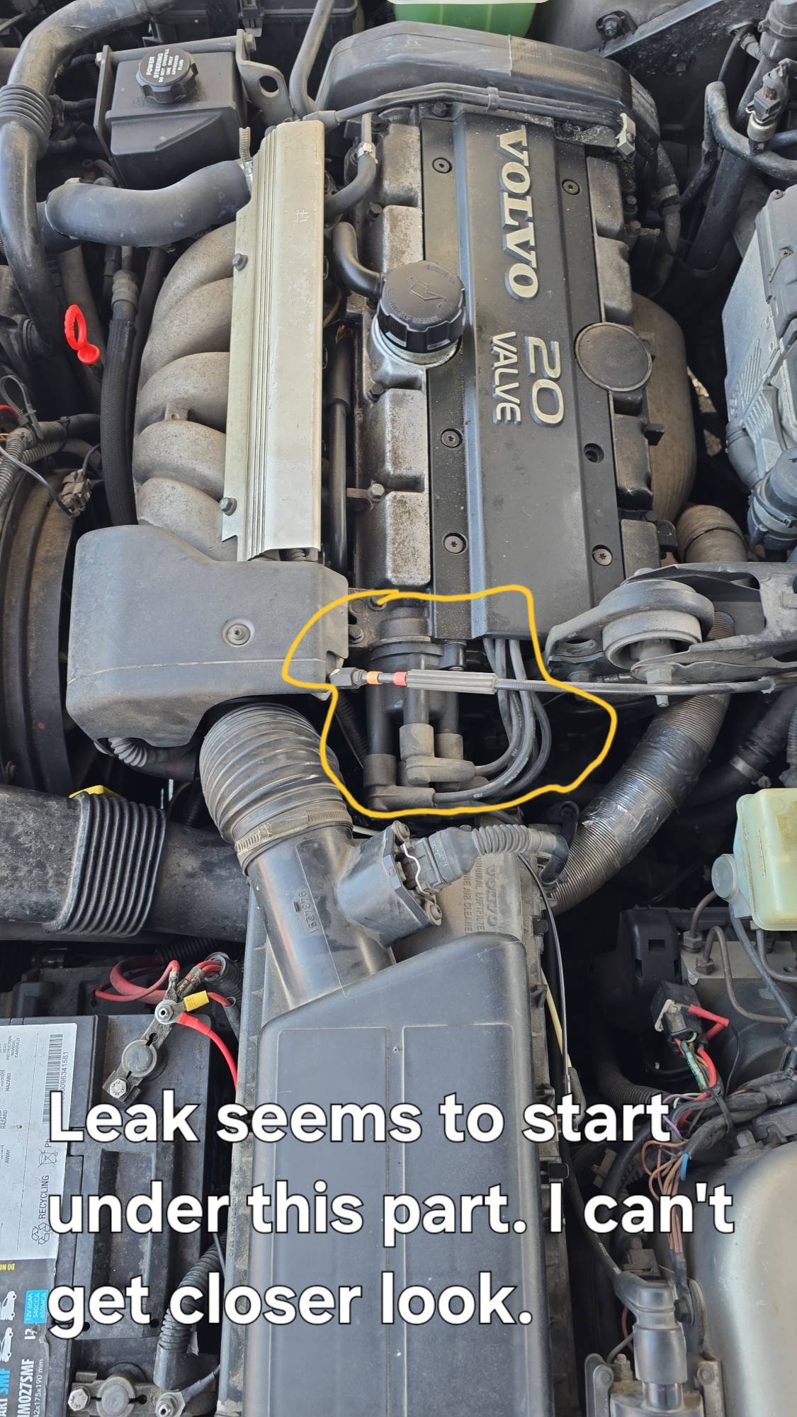

Also the area of leakage it's isolated to the area shown here. Check attached.

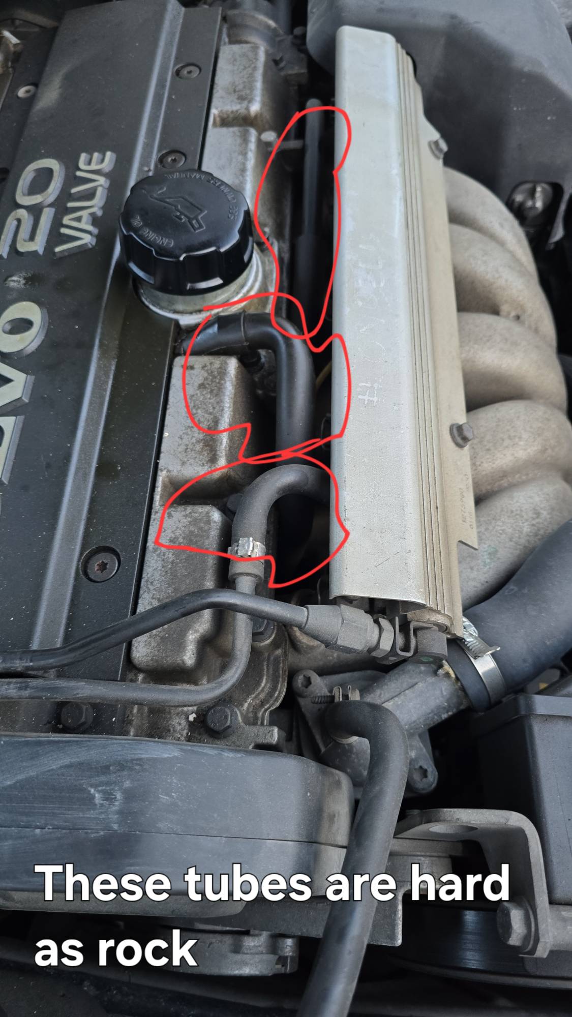

Also check attached of the tubes I noticed they are hard.

You will either have to remove the distributor cap, to see under it, or buy a mirror on a stick so you can see under the distributor.
Appreciate it is cold, it is -15C or below here with the windchill this morning. Not great for working on cars. I am lucky to have a heated garage though!
Back to your leaks. All those leak areas are classic PCV blocked. There is a chance if the cam seal has blown out, there is enough pressure relief to not cause a glove to inflate.
While you can never be 100% sure without actually seeing the car, I'm fairly certain you have a leaking cam seal and possibly a blocked oil catch tank which then leaks oil down the front of the engine.
Your transmission may be ok for now that a cam seal is likely the leak issue.

Your leak is 90% likely behind the distributor IMO.
Likely the blown seal is caused by the PCV valve as has been said. I recently serviced the PCV system and replaced that seal on my car when I bought it. It is an annoying operation with lots of hard to reach bolts to remove the intake. I would not want to do it outside in this weather.
But the seal is pretty easy to replace.
A temporary solution might be to disconnect the pipe that goes from the valve cover to the PCV catch bucket, replace it with a custom hose that you let drop down near to the bottom of the engine instead. Then you can vent overpressure below the car and not have it make a mess in the engine bay.
