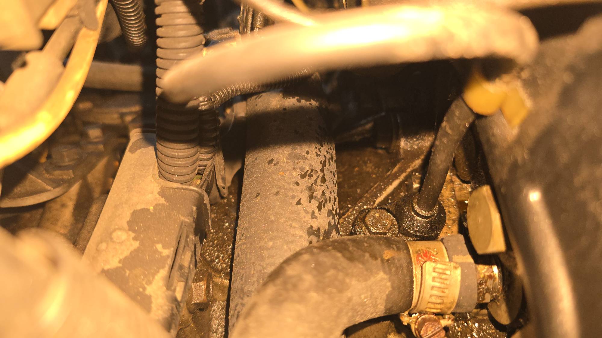

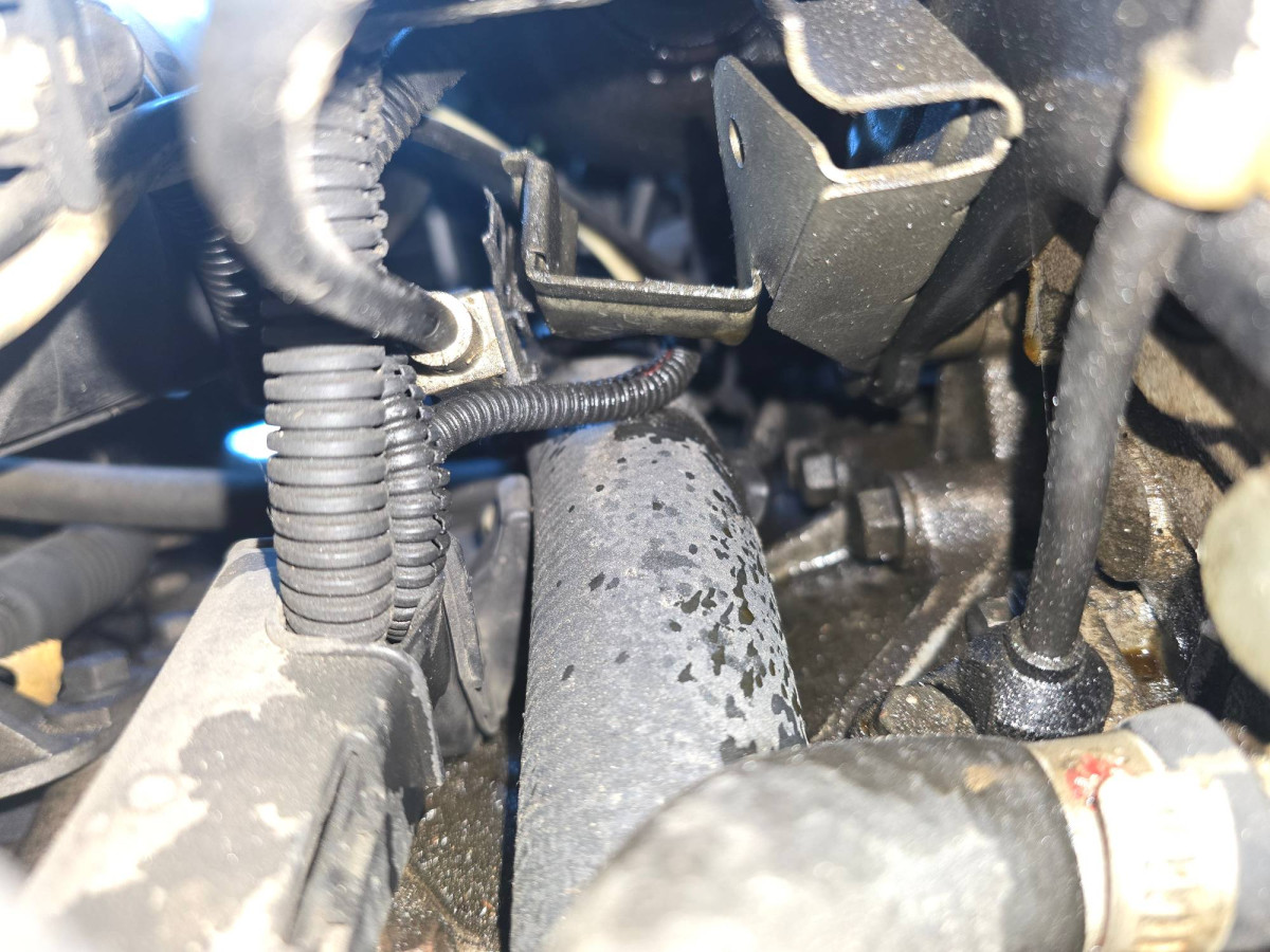

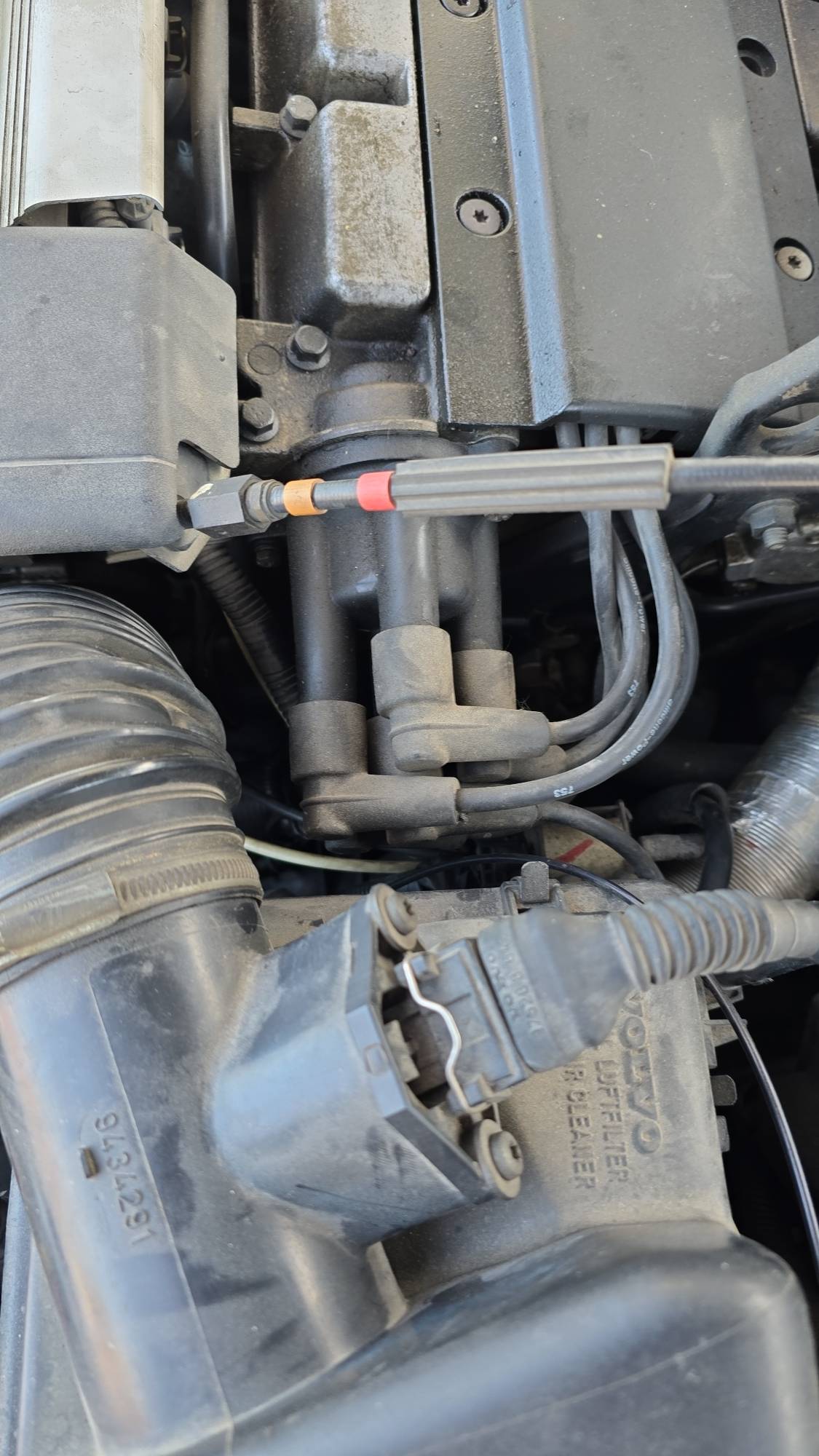

It always had a oil leak since I bought it and now I used Oil Saver from Liquid Moly and it loses while driving like 2 cups of oil. :(
Check: Image
The oil leak comes from driver side. Top part. Check: Image
Here´s a video (upside down) of oil "dripping"...
Where is it coming from?

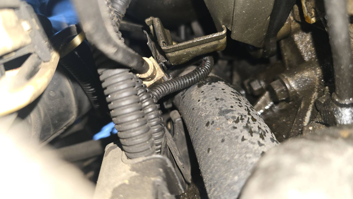

Another view;
Its recorded upside down. Liquid Moly made it worse it seems. What do you guys think?

Could be the rear main seal for the crankshaft. Can you take a picture or video further back under the car? When it is this close it is hard to see where you are pointing the camera.

scot850 wrote: 23 Nov 2024, 16:30 Could be the rear main seal for the crankshaft. Can you take a picture or video further back under the car? When it is this close it is hard to see where you are pointing the camera.

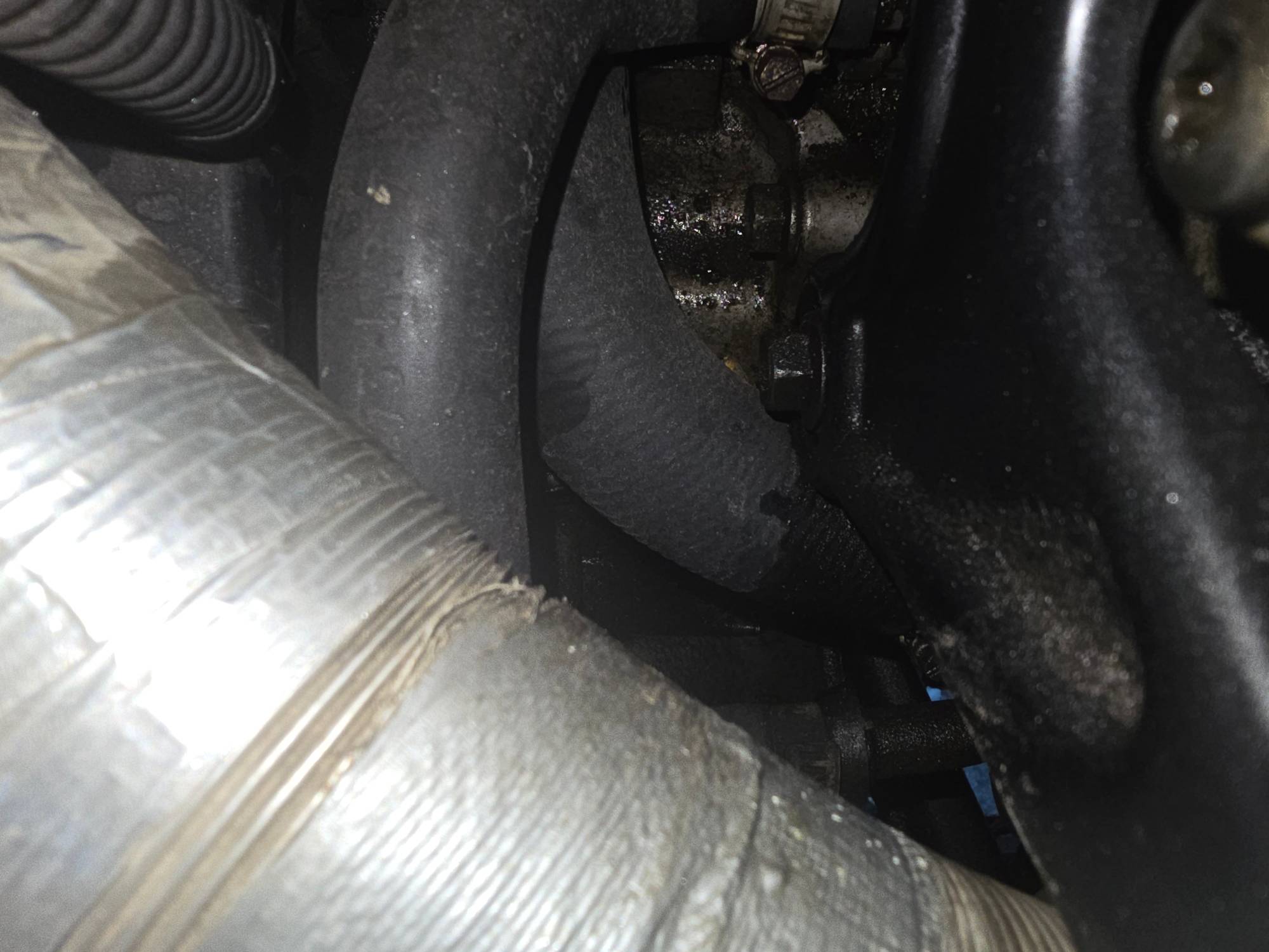

Hi I can't pic under. I would need to lift the car. I don't have one lifter available.
Check attached pictures..
Thank you for your kind help.

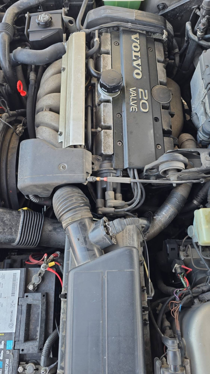

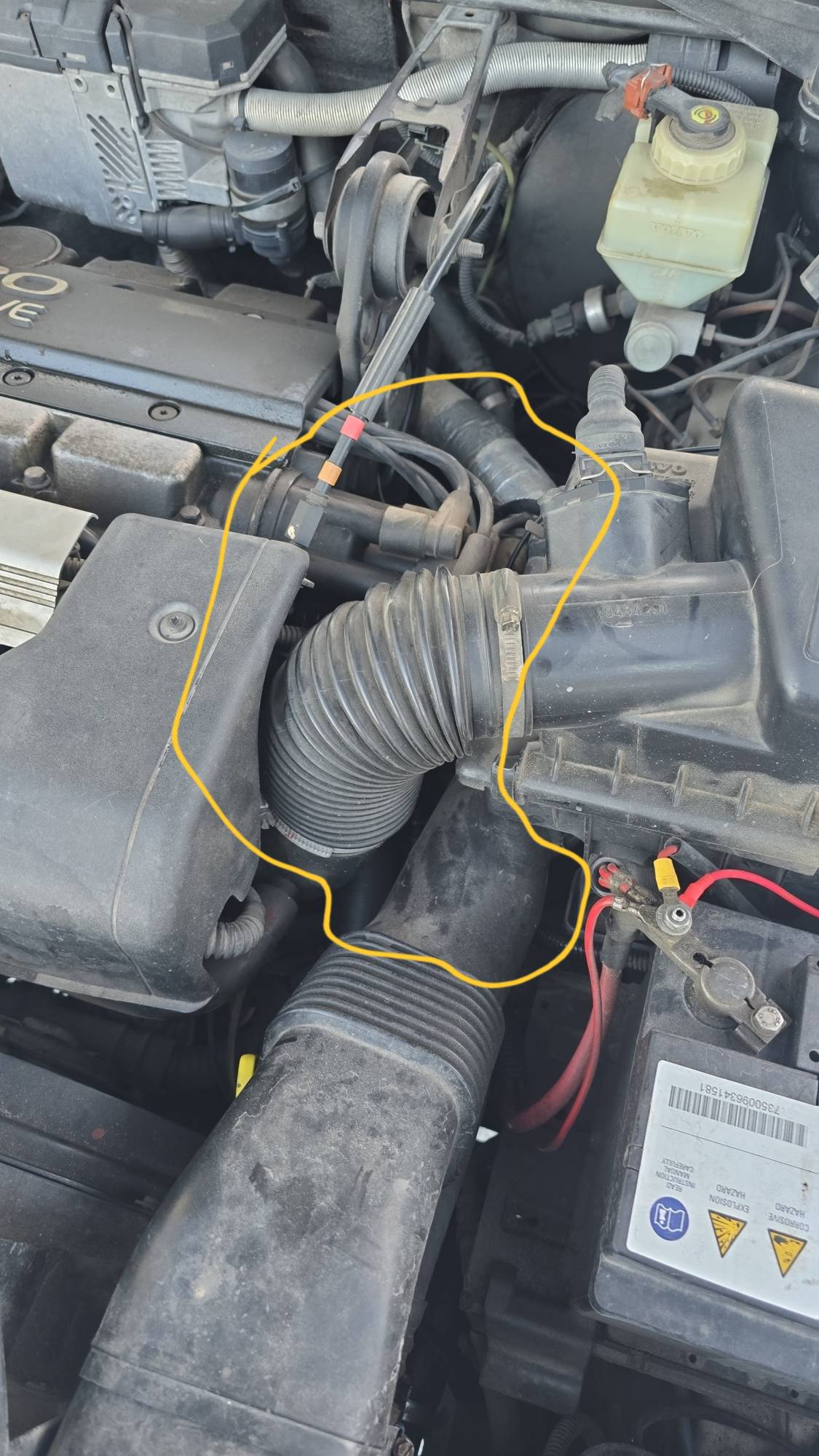

Thank you so much for your kind help and guidance. Unfortunately, I’m not very experienced when it comes to cars, so I’m unsure if the issue involves the rear camshaft seal or another component.
I spent about an hour yesterday trying to locate the source of the leak, and I was able to identify the area where it’s dripping. I’ve marked it on the attached picture for your reference. Access to the area is quite challenging due to cables and plastic obstructing the way.
I’ll perform the glove test as soon as possible to check for any crankcase pressure issues. If the glove test results indicate no pressure problem, what could be the likely cause of the leak?

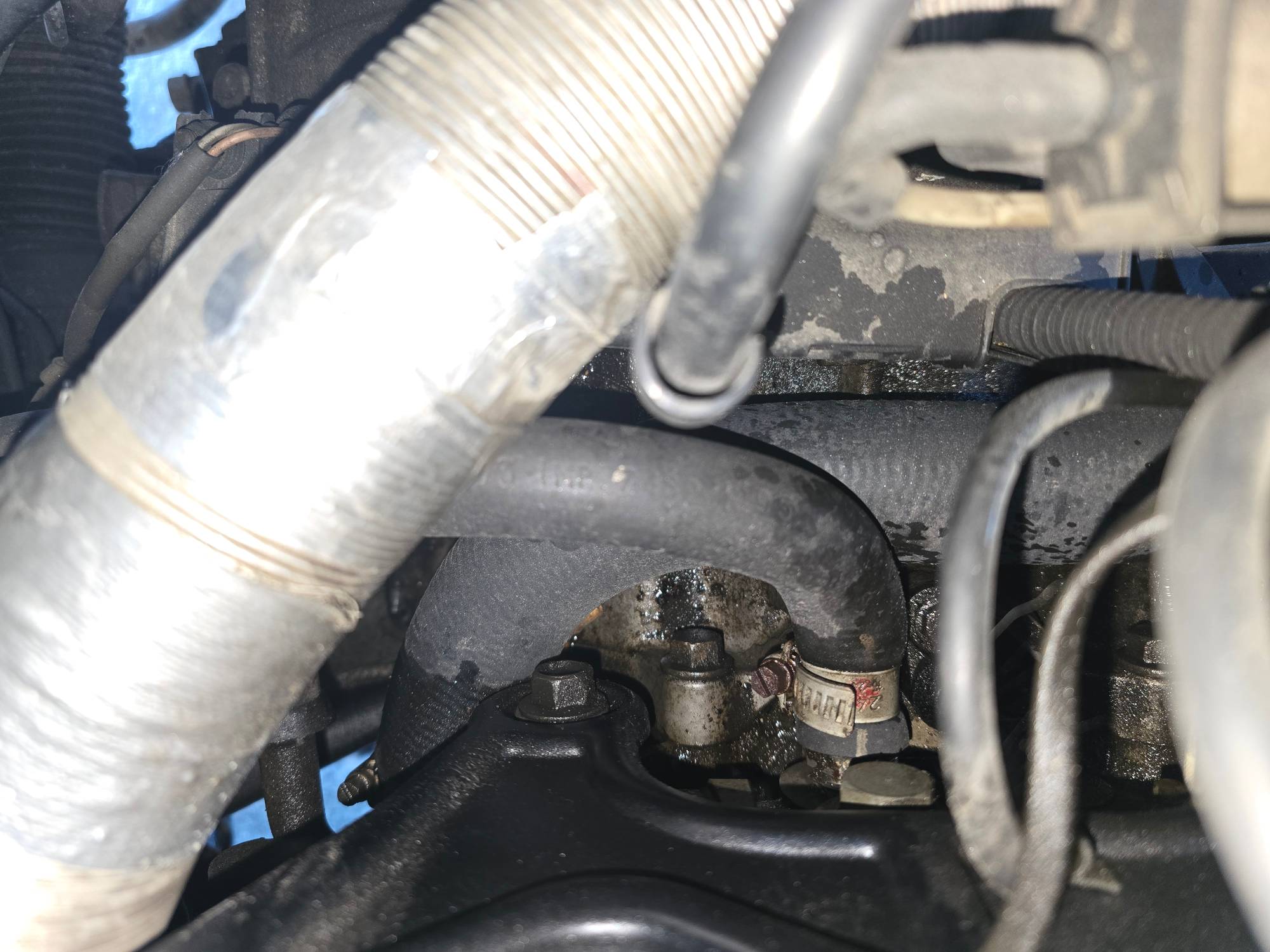

Hello,
Glove inflated... and I isolated the area further. There appears to be a persistent drip under a specific section. Please refer to the attached images for more details.
Thank you for your attention to this matter.
