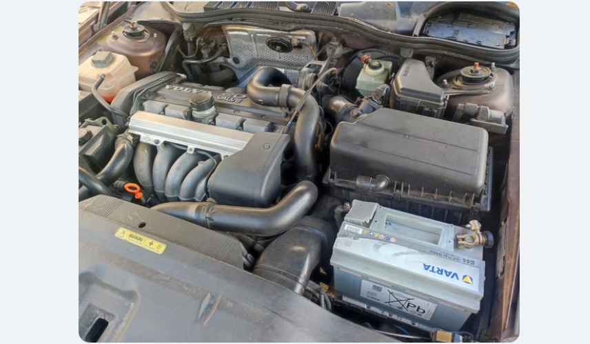

And as if I had contracted some weird addiction to a car that is clearly going to be bad for me... another 1998 V70 XC happens to be on sale in a nearby town to where I am travelling next week.
Let me give you the lowdown:
- 350,000km (217,000 miles)
- front suspension just renewed, mounts, wishbones
- brake pads all round renewed
- new battery
- new headlights (?)
- comes with winter tyres and set of rims
- detailed service history (oil and filters every year)
- new abs control unit
Current owner has been driving it for four years, he's just bough a discovery that better suits his needs. He has every single receipt of items renewed and replaced.
He has sent me some verrrrrry detailed videos as I required a close look at the rear mounts and general state of things under the car. The engine bay appears to be in remarkably good condition, with no oxidisation on the exhaust manifold. I think the state of it is pretty incredibly underneath compared to what I have seen on sale in salty Britain.
Anyway. I am being silly, right? Would anyone with a keen interest enjoy to look at some fun videos of the underside of this car? I suspect he will come down a touch on his asking price as the ad has been live for a while, but at 3000 EUR / 4500 CAD / 2500 GBP
For context: This is the land where a 940 in reasonable condition (infinitely repairable, hardy car) will cost about 5,000 EUR. A runaround fiat panda 4x4 (2005) in good shape is around the same price. For comparison, in the UK I recently bought and sold a runaround fiat panda for around 1000 EUR.
I am unable to find a modern V70 AWD within my budget or within visiting distance, with less than half a million miles.

Couple of pointers on the car you are looking at:
1) Coolant level and colour - My Volvo mechanic friend says you should not use red coolant in these engines. It can damage the internals of the engine and gaskets. The level is low. Check for boil off residue around the header tank cap (in case it has a head gasket issue) and check the underside of the carpets for damp from a leaking heater core. The carpets are rubber backed so touching the top may give no indication the core is leaking. There could also be other coolant pipe leaks. I can't recall if the heater core on a RHD car is on the passenger side as on LHD cars.
2) Headlights lose their silvering over time and having had then replaced is a bonus.
