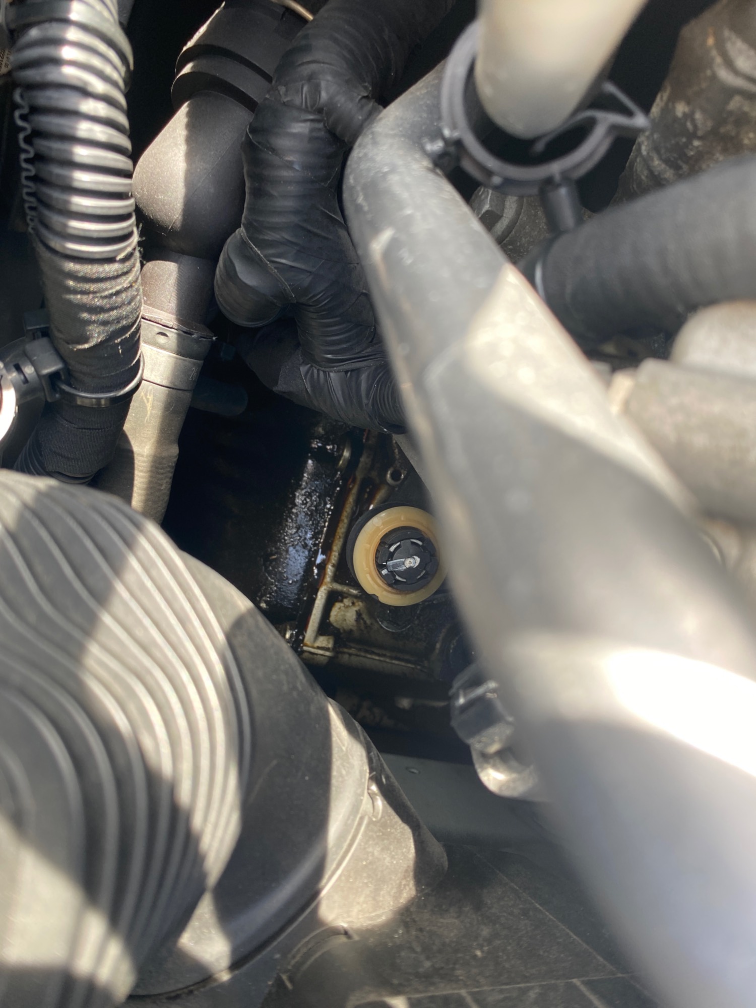

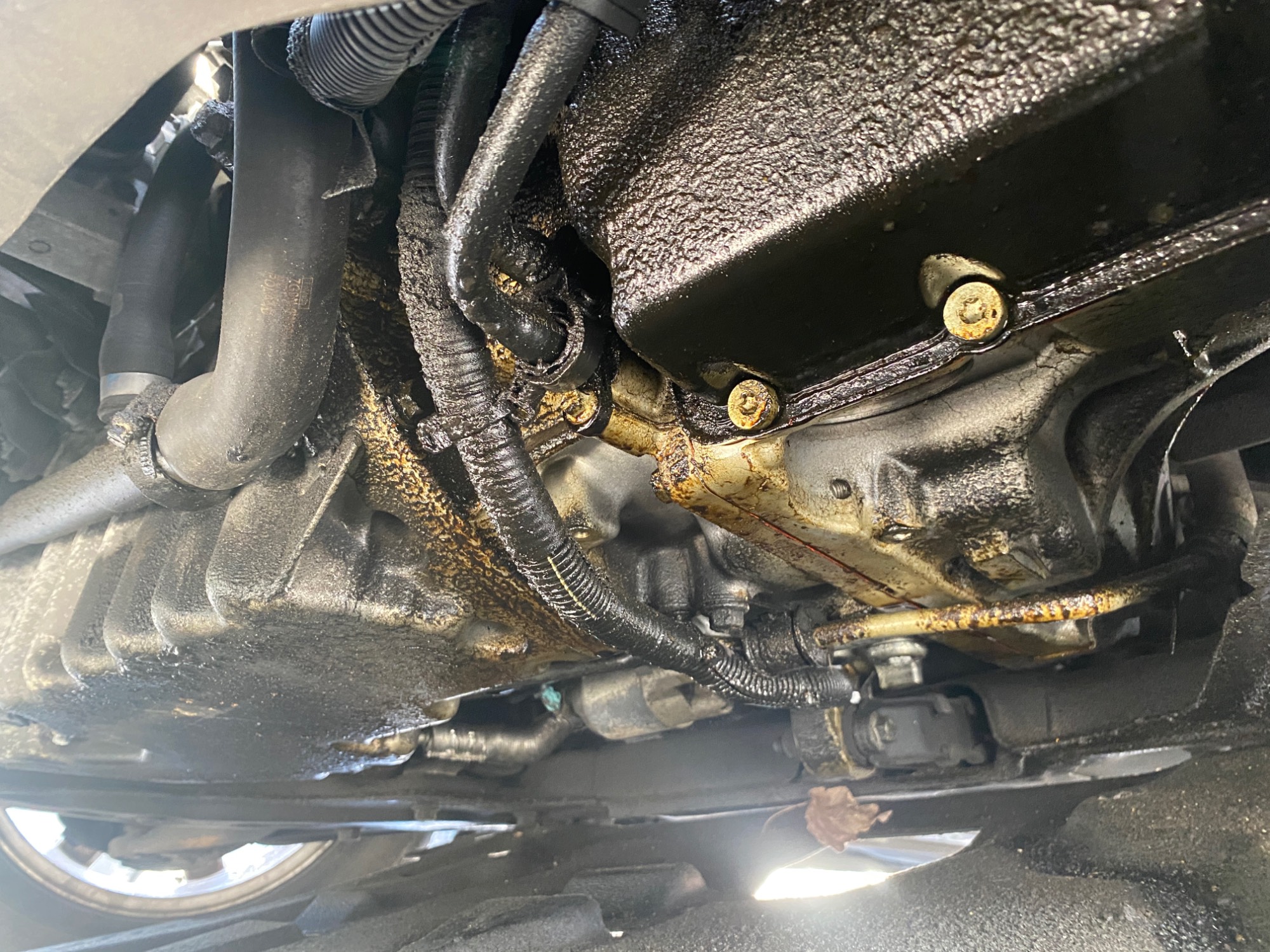

2. Ther is oil on top of the transmission and all under the underside of the motor. My guess (after researching) is that it is the vacuum pump seal. Thoughts?

Can you share a photo?Bluegrassxc70 wrote: ↑06 Mar 2023, 04:17
Vacuum pump is a serviceable item; Repair Kit. Vacuum Pump. Part Number: 31401556

Here are some pics (not great but all I could get).
This is a non turbo 3.2 motor.
