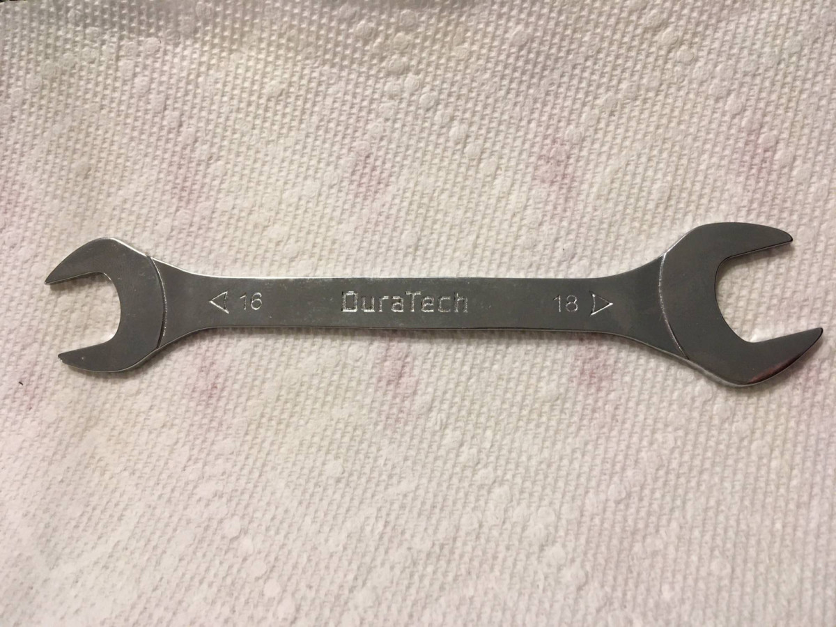

I ordered a super thin 16x18 mm open end (Duratech) from Amazon for < $8.cn90 wrote: 03 Feb 2025, 15:52 This is a photo from my 1998 BMW 528i end link....you can see the thin 16-mm wrench there...
https://www.amazon.com/dp/B09G6HQW7L?re ... title&th=1

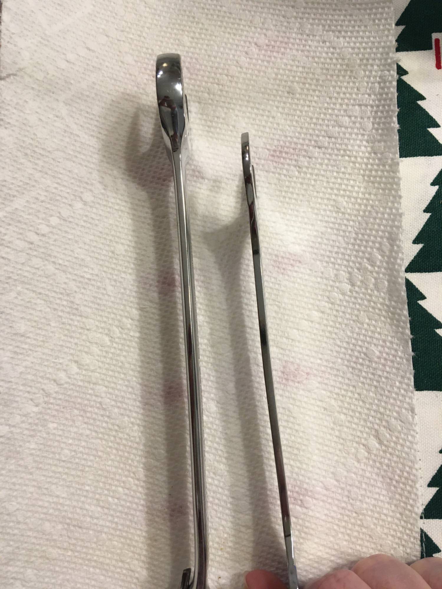

I purchased a thin open end wrench to help hold the inner nut to allow me to remove the sway bar end link (aftermarket). My standard wrench was about 9 mm at the head while the new was is 3 mm. I purchased the thin wrench (chrome) from Amazon for $8. Bicycle "cone" wrenches are another thin wrench option. Fingers crossed!
Comparison of standard & thin wrenches

Keep in mind if you're replacing the links with new ones you can get more medieval with the removal method, vice grips for counter hold and impact wrench or angle grinder to cut of the old ones as erikv11 mentioned. Nice to have the thin wrench on hand but if the nut and threads are in bad shape the thin wrenches don't always hold.BobbyC777 wrote: 05 Feb 2025, 22:16 I purchased a thin open end wrench to help hold the inner nut to allow me to remove the sway bar end link (aftermarket). My standard wrench was about 9 mm at the head while the new was is 3 mm. I purchased the thin wrench (chrome) from Amazon for $8. Bicycle "cone" wrenches are another thin wrench option. Fingers crossed!
