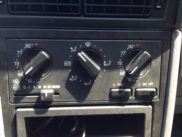

Why it's in F and not in C?
1st problem is...that ecc is NOT for '92.
That's why i asked for a picture of whole dashboard.
This is how early ecc for early cars from '91-early '94 looks: Ecc from the picture you posted is from late '94-'97.

The same one in C for '91-early '94 should look like the one from the picture i posted.
Those are early ecc units for early cars.
