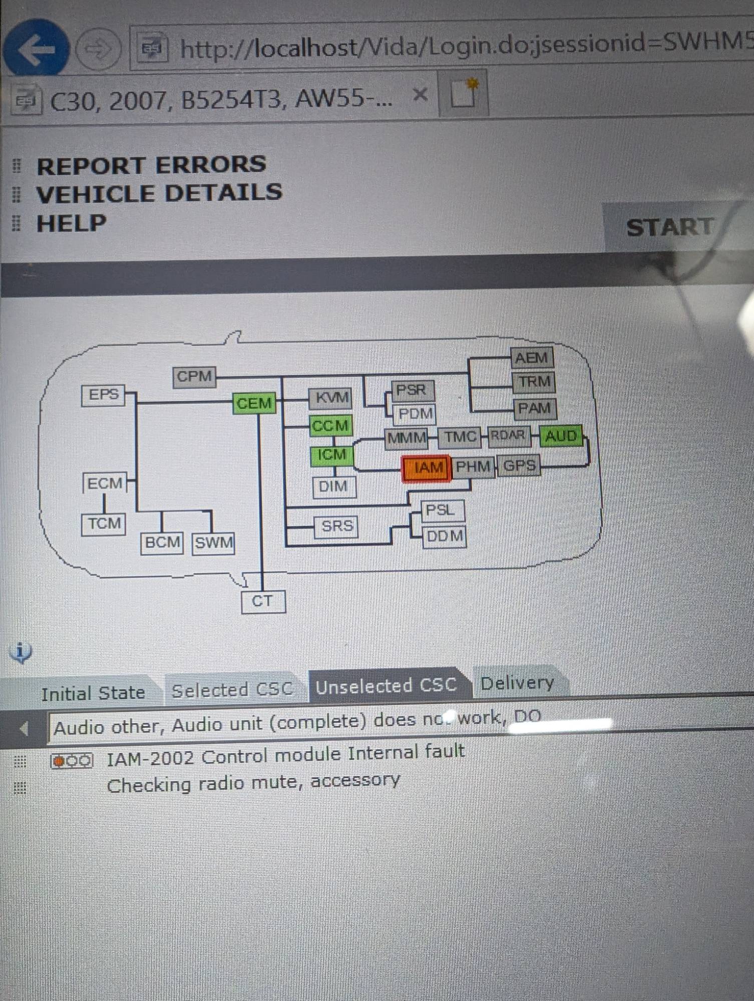

Actually the P1 wiring diagrams (stupid acronyms aside) are way easier to follow than P2 versions. Vida does help as it lays out the various modules in kind of a family tree or hierarchy, so you can get some idea of what sends signals where. While not 100% foolproof, it certainly helps a novice on these systems.
Below is the Vida module layout for the P1/C30. As those that have experience of the system, you will know green means the system sees no issues with that module, yellow as I understand it can mean a possible issue, or older stored issue, and red means a warning fault needing addressed, as I view it:
When there are no issues and you go into the diagnostics section the system ignores those module so they are white in this picture. In this case the IAM fault is with the radio unit (CD error).
However, the point of all this is that all the codes so far (with exception of the IAM/radio) have been in the tree from the CEM going left.
For this my logic is if the CEM was compromised by the sunroof leaking, then all the systems potentially could show issues. However, so far the EPS (power steering) has shown no issues. The TCM has no issues. The only items having issues are engine items (ETM/ECM/TCV/intake air leak). This would suggest that possibly the ECM is the common issue there. However, for the first time when at the dealer the car now showed a BCM error. While it is possible (need to look at the wiring diagram as per Vova's suggestion) that the only common thread is the CEM is the issue. The wiring diagram may need further investigation to see if there is a relationship between the ECM and the BCM. I know this is going to make my head hurt. Maybe I should just go back old school and buy this:
