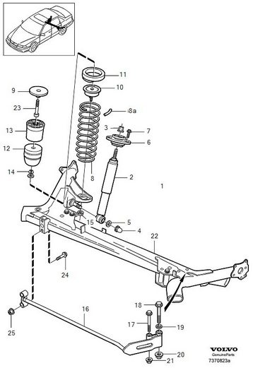

Would you mind looking up torque rating for the 99 XC rear suspension ? I already have the IPD version of Nivomat substitute that I bought 2 years ago. Just didn't have any time to work.

I can do that, I'll get a list and some diagrams to you tonight.

Here's the torque specs for the rear suspension of a 1999 V70XC.
Since it makes references to the types of bolts and not so much the actual components, I included diagrams of the rear suspension and their parts list:
If it doesn't specify, usually a quick web search for "Volvo [part number]" will tell you what type of bolt/nut it is (M8, M12, etc.)

They don’t connect to the shock or spring, they attach to a part that hangs down inside the coils of the spring. In the PDF diagram of the spring, strut, and sway bar, it’s part #9 in the diagram (p/n: 9475852, labelled “buffer”).
It’s tricky to get a good photo of them, but I just snapped these of what it looks like on Saskia (left side, so mirrored for the right):
