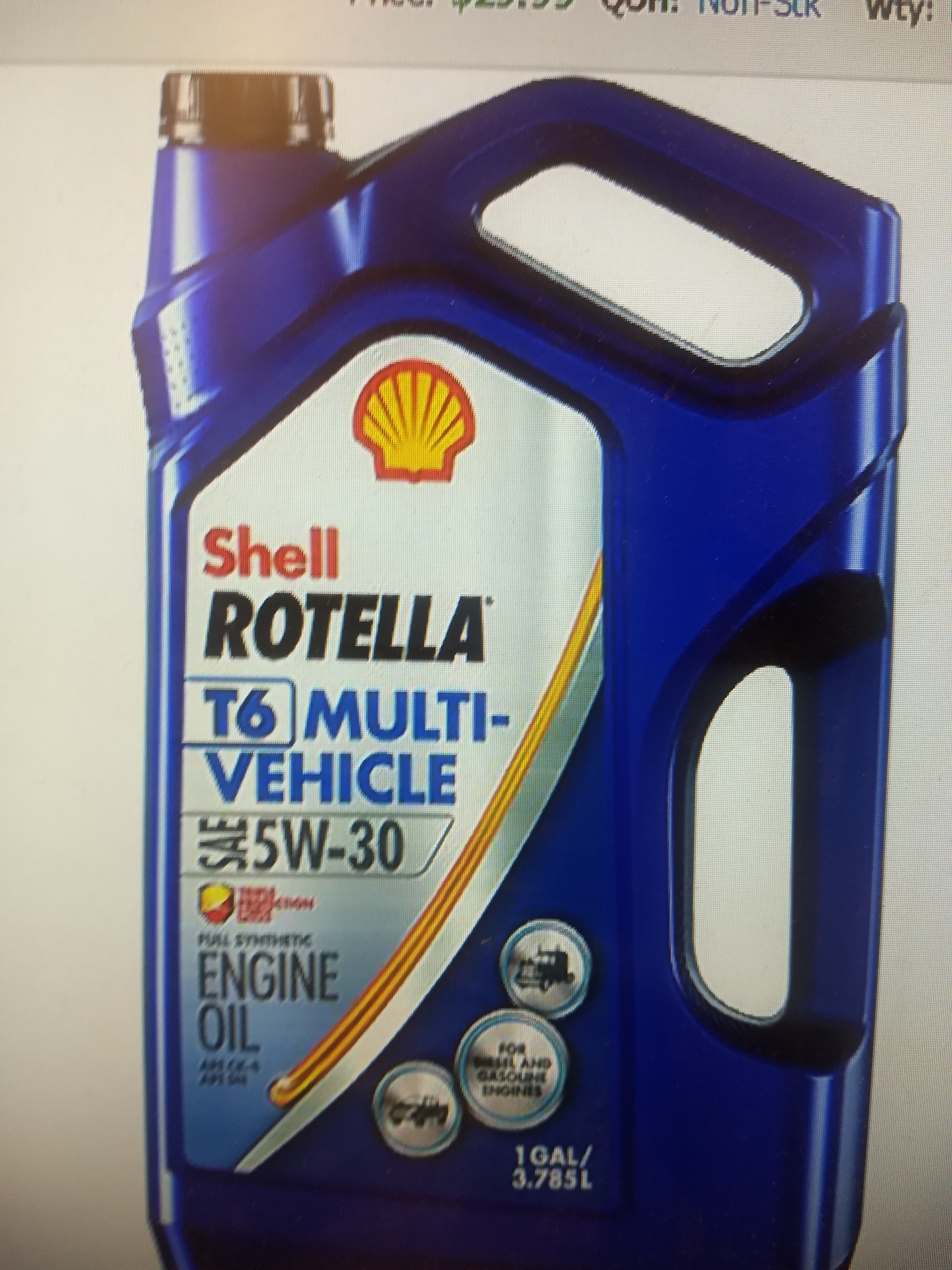

Post by alpha318 »
I know I'm a few years late, but I have a curve ball for you all.
How do you all feel about Rotella T6?
A parts store around here recommends this in their parts list..

Post by Navservice »
I used Shell Rotella T6 from Walmart in my old (somewhat missed) 2001 Subaru Forester. The guy I bought it from (my brother) used nothing else. Walmart balked at putting it in at oil changes, I always had to sign a waiver. But they acknowledged how sweet the engine sounded at idle, this with 191,000 miles. Alas, due to less than optimal stability at high speeds, I wrecked it and have bought a Volvo V40 to replace it with. IIRC, the Rotella T6 I bought was 10-40W.

Post by wizechatmgr »
alpha318 wrote: 31 Jan 2020, 18:55 I know I'm a few years late, but I have a curve ball for you all.
I've used this in everything including a splash lube based lawn mower. I've never had a failure that was caused by lubrication. There has always been a different factor.
Frankly I think lots of oils are just fine. People often forget or choose not to change their oil and filter - then complain about the oil. Now a days, provided the oil pump and passages (o-rings in the pan?) are good, and your level & pressure is good, I think you'll rarely find an engine with lube based issues.
