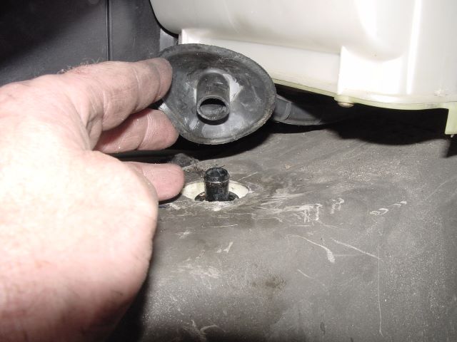

Remove the lower dash panel and pull back the carpet around the console. Remove the stiffener behind the carpet and then look for a rubber tube that goes to a nipple on the floorboard. It is centered just below the heater core.
Remove the tube from the nipple and clean it out with a piece of wire or, my favorite, weed eater string. Don't get anywhere near the evaporator with drain cleaner.
Be prepared to quickly plug the hose back onto the nipple as you will have a fair amount of water coming out of the tube once you clear the clog.

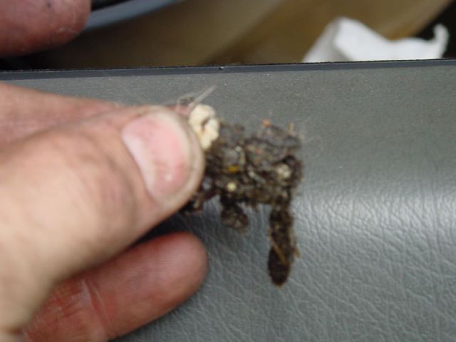

Well, in two shakes of a lambs tail I got another 750 ml of water out and this creature! :o

Here is where the pipe is located,

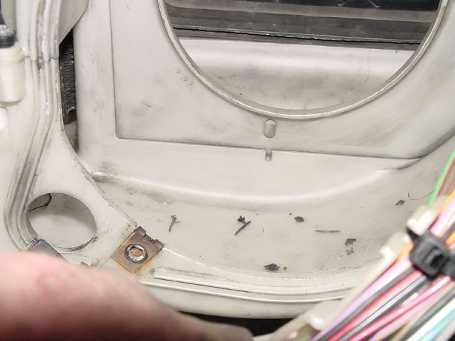

I apologize for taking so long to get photos up. It took me a while to find them and it looks like the problem was solved. Here is one photo from my car-Hose was black not white.

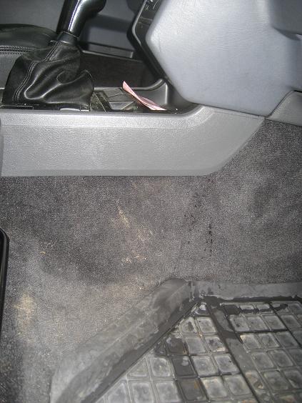

I'm thinking I have the evaporator problem. The photo shows where water is dripping on the left side of the right (passenger) foot well; it's also dripping on the right side.
The AC works fine. But the defroster is working hard and not making much of a difference. We're carrying a "manual defroster" which is basically a kitchen dish towel for when it fails totally. Typically, the defroster will kick in and clear the bottom portion or most of the windshield, then it will actually make the problem worse. We turn the AC on when running the defroster.

I'm betting on your heater core being bad. It can be replaced without removing the entire dash. There are several writeups either here or Bay 13 that goes through the procedure to change it.
