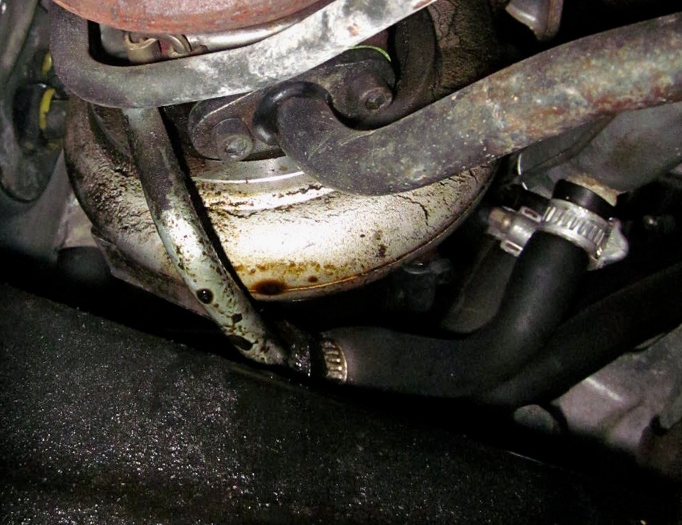

I recently replaced my turbo coolant inlet hose (on a '97 855 GLT at ~148k miles) after inspecting it per Tailor's advice above, and it was getting a little soft and puffy at the connection to the metal tube that connects to the turbo housing. There always seems to be a lot of oil around the turbo, which probably accelerates the degradation of the rubber, plus that is probably the one of the hotter spots.

The picture below shows the state of the original hose, covered in oil at the top and somewhat hard to access: To remove the lower hose clamp I found there was an angle from the top of the engine that, with a 7mm socket and a 1' 9" extension (the longest I've ever had occasion to use), I could reach and loosen.

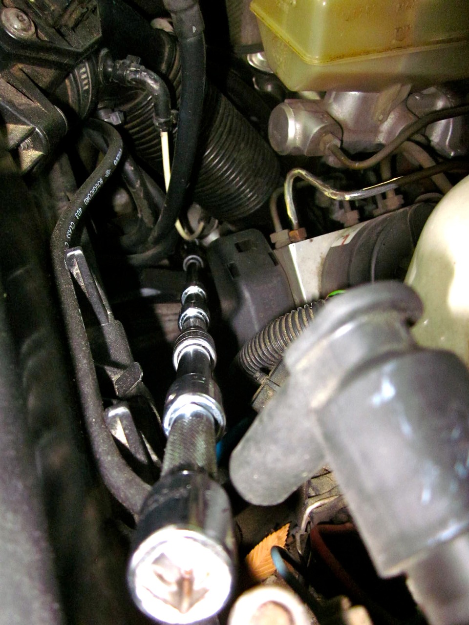

The picture below shows the extension going down to the hose clamp before I attached the ratchet and loosened it. Once I got the lower hose clamp a little loose, I got under the car and spun it around so I could finish loosening it with a 7mm ball driver. To get the old hose off the bottom nipple I had to gently slice the old hose with a knife taking care not to nick the nipple. I cleaned up the deposits on the nipple with a brass brush.

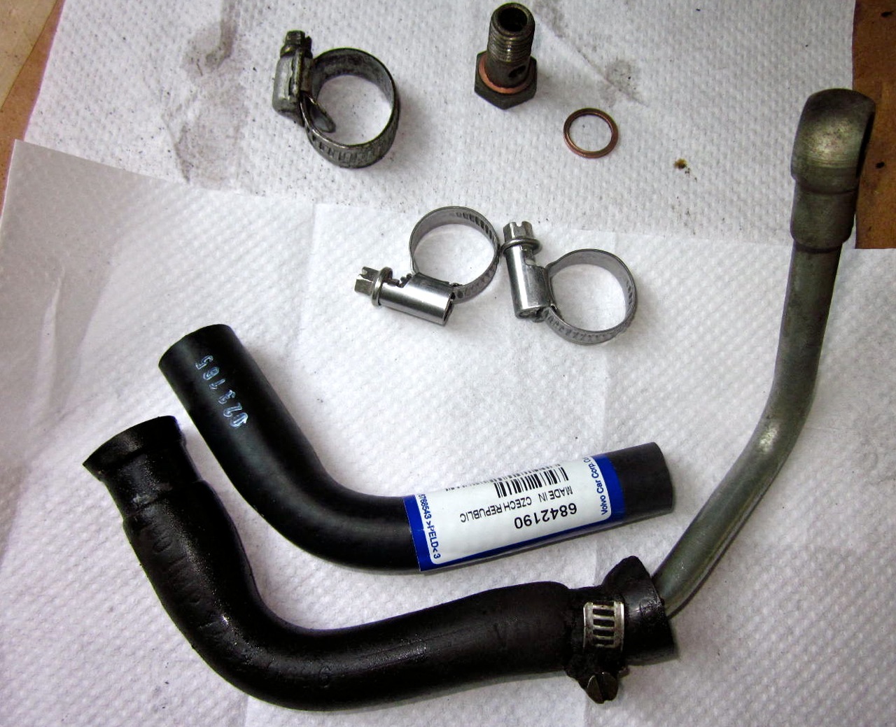

As Tailor said there are two copper washers on the banjo bolt you have to keep track of. Once you get the tube and hose out of the car, you can remove the upper hose clamp, get the old hose off and clean everything up. I made a mental note of the angle (and took the picture below) showing how the tube fit to the hose so that I could put the new hose on at close to the right angle. The old copper washers had a little green corrosion and some compression marks but they didn't look too bad so I reused them. I cleaned up the banjo bolt hole and threads and the tube, and then installed the new hose. I needed to orient the hose clamps so the nuts faced me downwards -- that made it easier to tighten them up when I was under the car. I loosely attached the banjo bolt at the top and attached the hose at the bottom nipple. I found I needed a little liquid dishwashing soap on the tip of the nipple to get the hose to go on. Then I tightened everything up, refilled the coolant, burped the system of air and refilled about 4 times, checked for leaks, and it's all good!
