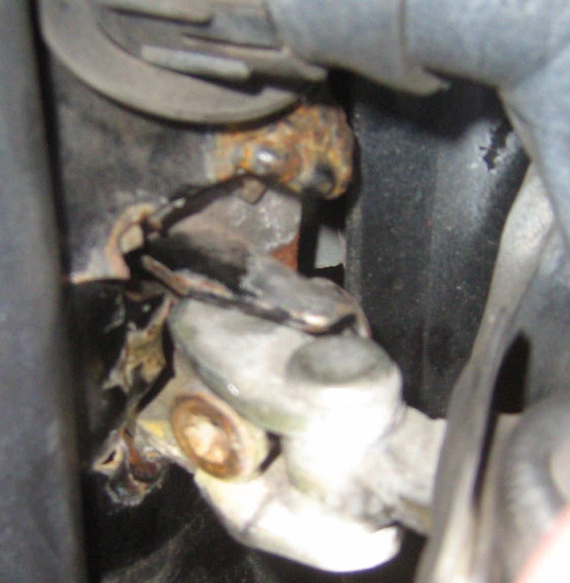

holler1
Posts: 756
Joined: 25 Jun 2008, 21:32
Year and Model:
Location: West Virginia
Post by holler1 »
This is what happens to the weld around the check mount if you leave it too long (as I did).

wheelsup
Posts: 1299
Joined: 28 Jun 2005, 20:30
Year and Model:
Location: Raleigh, NC
Has thanked: 16 times
Been thanked: 22 times
Post by wheelsup »
Yeah that picture is why I took the door check off because I could see where it's going. With it off the metal won't fatigue any more and I have a hope of fixing it myself with drilling it possibly down the road.
