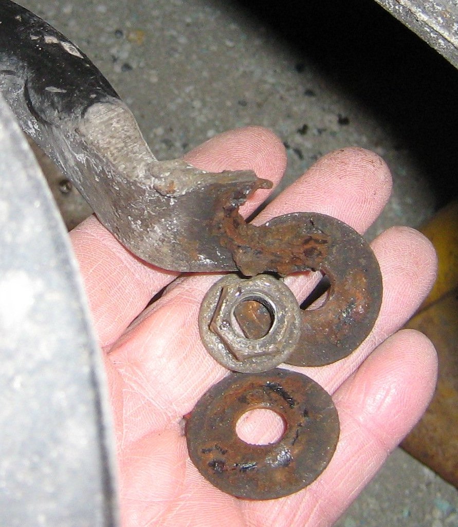

I decided to replace the sway bar end link I couldn't get loose when I replaced the struts in Aug. I got it off and the end of the sway bar is broken and rusted, apparently was barely holding on. Here's a picture.
volvo v70 sway bar end.jpg (182.12 KiB) Viewed 1249 times
The broken section was concealed because whoever did this job put two large washers on either side of it before tightening up the end link. There were some small parts of the broken section between the washers. I had seen the washers earlier but didn't realize the bar was in such bad shape. I don't know when this was done but suspect it was after my wife sideswiped a guard rail a few years ago and we got it worked on at a body shop. I think it's possible this could have been causing the popping noise I've been hearing. I did a little more checking on the steering rack and it seems tight. I was hearing a small clunk when twisting the drive wheels but that seems to be from hitting the steering lock. I tried that with the key on and got no clunk, and the steering wheel moves with any motion of the drive wheel. I took a look at the strut mounts on both sides (without loosening them) and the spring seat to strut mount spacing looks OK at least from below.
In any case, I need to replace the sway bar. I looked at the IPD bar set and that is $448 for the AWD (front and back). Haven't found an OEM bar yet but I expect that will be a lot cheaper, about $170 if I looked at the right one (AWD is apparently a larger diameter than FWD). Or I might be able to find one from parting outs, eBay, Erievovo, etc. A couple of questions.
1. How dangerous is it to drive w/o endlink hooked up on one side?
2. How much better is the IPD than stock? I installed Bilstein touring struts so they should be compatible.

1. you can drive it while it's disconnected, but not permanently, you should fix it asap, it will have a lot of body roll so don't get sporty...be carefull. you'll need to deal with the loose end link... just take it all the way off.
2. Ipd sways are an improvement if you want a more sporty feel in the corners. but if you don't care about that, a stock one out of a wrecked car would be the way to go. these guys rock. call them with your credit card in hand and you'll have a sway bar on your porch in a couple days.

Thanks, Larry. I did remove the end link on the bad side but left the one on the other side. I'll take a day or two to decide which sway bar to get. I thought I could drive it "gently" but thanks for the confirmation.
