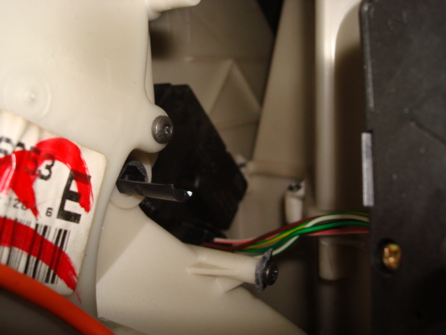

I think you understand it right...it is normally closed (no air to the floor), so set your ECC to no air on the floor and then tie the split part up (not with open to the floor).
EDIT: I looked at your pictures again. Now as I understand it, you can repair the piece and then slip the motor in, so no worries. Just tie it up and you should be good to go. If the motor is off, then fiddle with it until the controls do what it's suppose to do and then button everything back up after that. Sorry for the confusion- I was under the impression that you couldn't install the motor with the shaft fixed.

Regarding the repair, I did measure the split shaft, and it is exactly 10mm on the outside. So what I intended to do was to glue the broken half back in place using epoxy, and then have it surrounded by a solid piece of metal (with a few drops of epoxy, too). Maybe it is not the easiest DIY way to do the repair, but I feel like it is the most robust way to fix it.
I'll post pictures of it afterwards.
I would be glad to help the repair database!
The repair is done!
Looking in the shop for a suitable piece of scrap metal (I was going to machine one), I came across the perfect item for this purpose: a bronze bushes. It has the exact required dimensions without any machining (inner: 10mm, outer: 16mm, length: 20mm).
It is such a perfect fit that I just had to insert it around the split shaft (just a little bit of pressure was needed), and the repair was done!
Then it was just a matter of remounting the motor (following MIJ advice to properly align the motor with the "idle" shaft position first, eg all air to the windshield (selector at 12 o'clock)) and the glove box. I also cleared the DTC for the ECC. I'll check in a few days if they're gone for good.
The bronze bushes is such a perfect fit for the repair that I would advise anyone to do it this way. I cannot think of an easier process either. It is a standard dimensions bushes that should be easy to find, at least in any "metric" country.

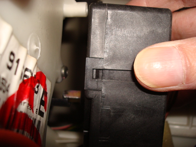

On a side note, here is how the clips for the glove box lid look like. Knowing how it is built makes it easier to figure out how to apply pressure with a small screwdriver, at least for me. A previous owner already had tried to unclip them, and only managed to scratch the plastic...
