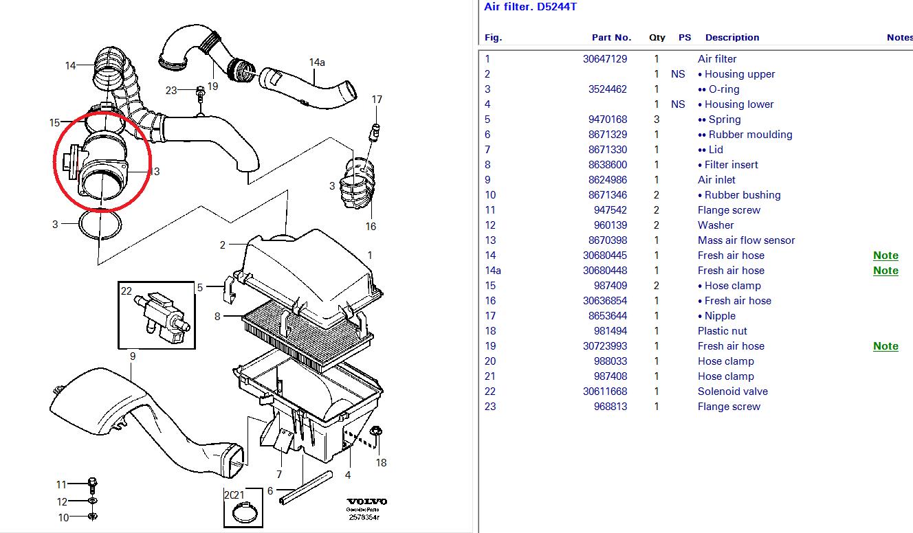

I wouldn't buy new coils yet, as the odds are about 1 billion to 1 against four or five of them failing at the same time. I think the problem is much more likely to be the MAF sensor. I'll see if I can find some diagrams showing where it is.

The MAF (Mass Air Flow) sensor measures the amount of air going into the engine so that the Engine Control Unit can supply the correct amount of fuel through the fuel injectors.
I don't have a diagram for the 2006 model year, but I do for 2005. Maybe it's the same. Item #13 is the MAF sensor.

I turns out the IAT is integrated into the MAF. Here's a quick tutorial on how to clean up the MAF connector and hopefully solve that problem: http://volvospeed.com/Repair/maf_secure.php
