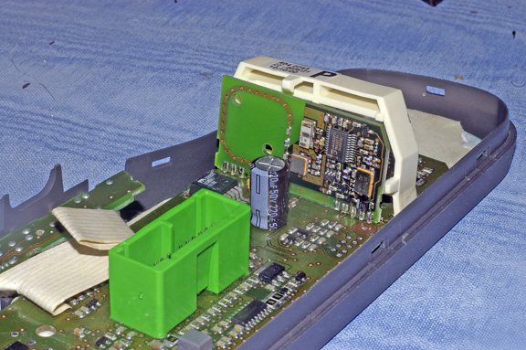

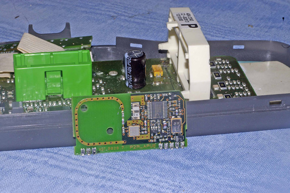

I had the "crystal" problem and the symptoms were that my remote worked better in cooler weather, when hot it became intermittent but it could also be the other way around since it's likely a change in frequency over temperature that's causing the problem. Same symptoms with both key fobs because it's the receiver in the car that's the problem. The crystal device is on a vertical circuit board (see photo) in the rear view mirror and the one good thing about this is the small circuit board can be replaced without the need for programming the UEM at the dealer. The downside it is not an easy DIY job due to the soldering skills needed to remove and replace the circuit board but it can be done. You do need a used mirror for the donor board and and as I recall it doesn't have to be an auto dimming mirror either. Xemodex probably does this same repair.
I remember taking my car to the dealer for this problem and they couldn't even narrow it down to the CEM or UEM, which are both expensive items to replace, plus programming.
