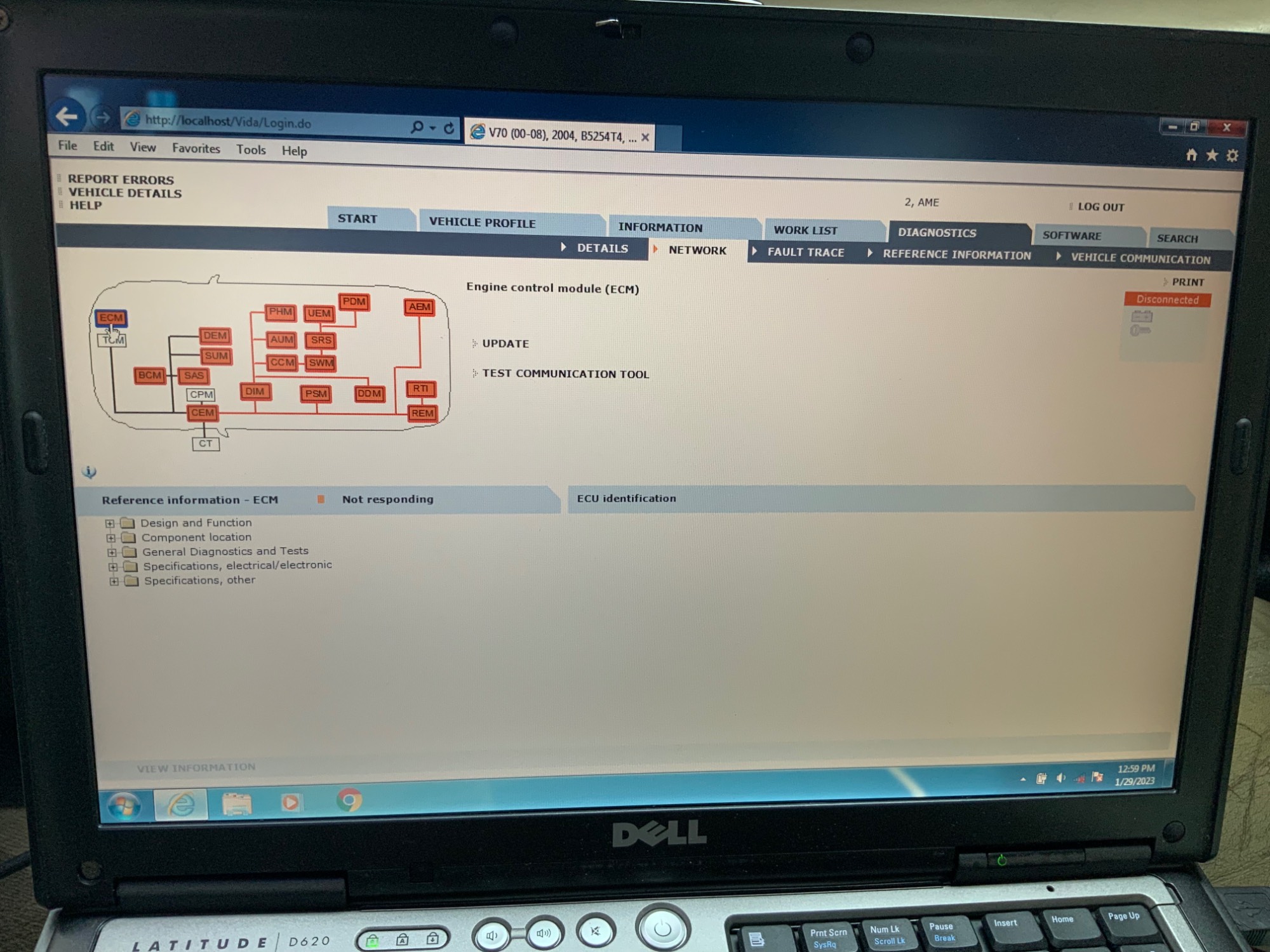

I'm thinking the key programming was lost so I get out my VIDA to check. But VIDA cannot connect to the car. I get the following message:
Is it possible that the CEM went bad or is the immobilizer preventing connection? How can I program my keys if the VIDA can't connect? Does anyone know how to fix this? I'm lost, please help.

My VIDA/Dice displays exactly as OP. I have my VIN stored so I was able to get past that page. Nearly all modules are red, and there is a red “disconnected” near the key and battery symbols, even though the OBD2 is connected and the key is in position 2.
