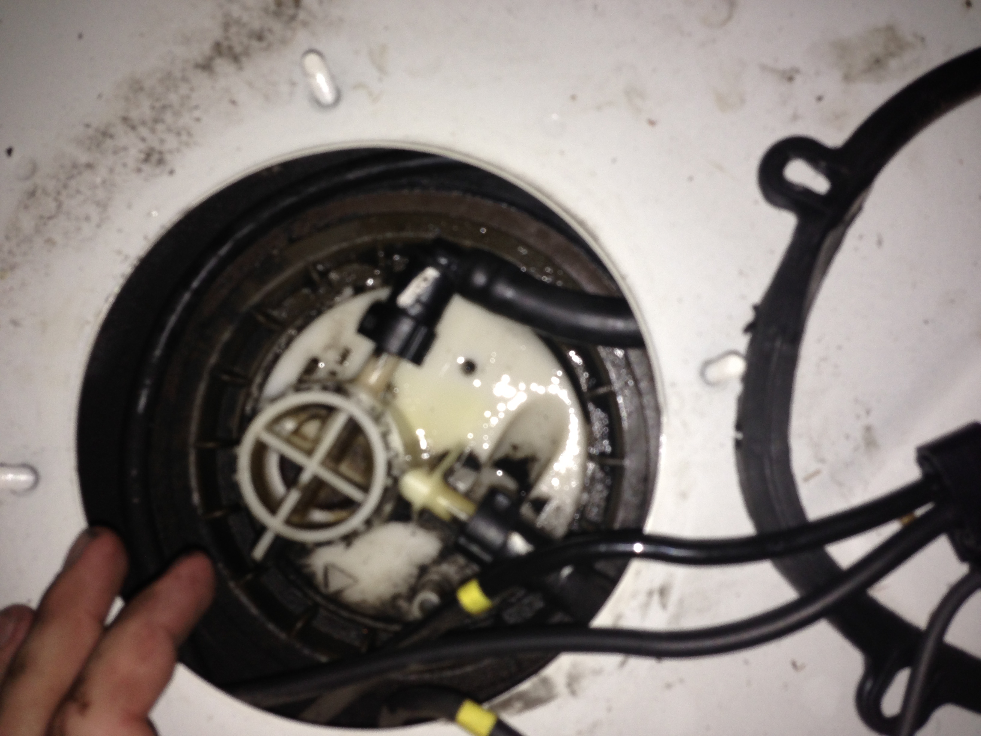

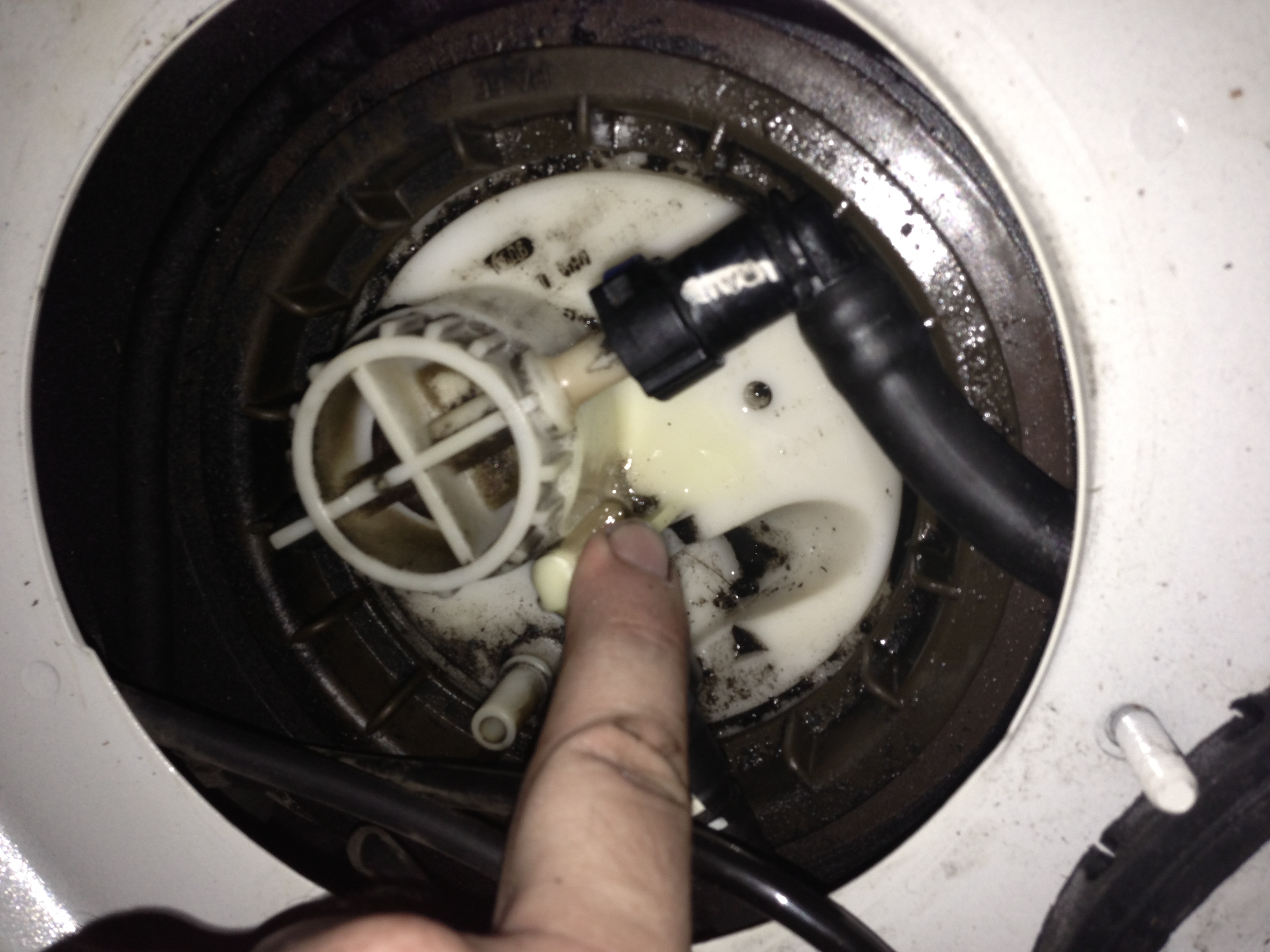

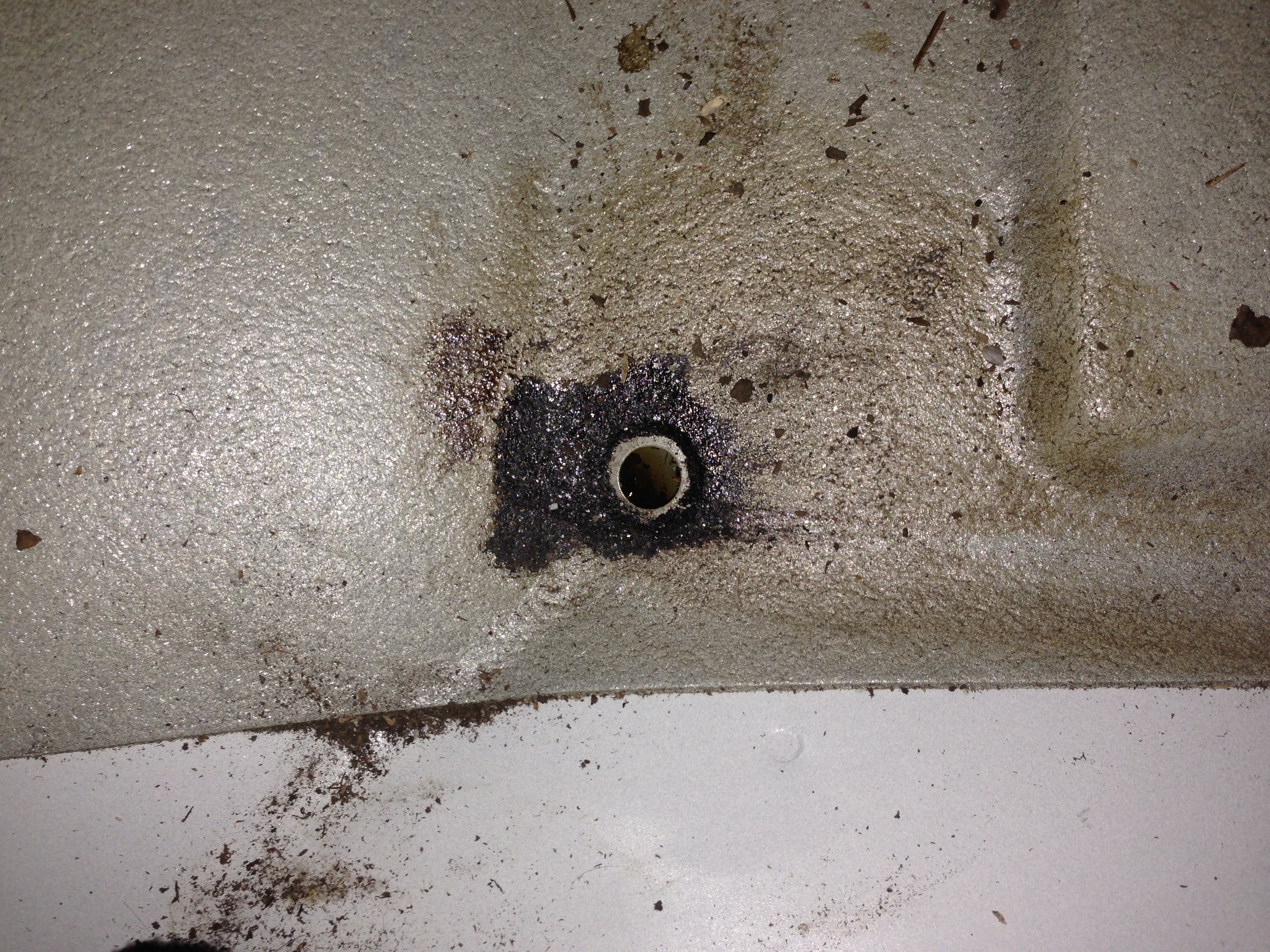

Hey guys. I just bought my first Volvo. A 2000 S80 with 120xxx miles for $1300. I thought I was getting a pretty sweet deal considering the condition is pretty great and it has no mechanical issues. Other then the smell of gasoline in the car.
After I purchased it and got it home I changed the fuel filter thinking that was the problem. After I changed the filter I must have knocked the hose that was connected to the pump and made it leak even worse. I did some research and found out about the fuel pump recall. So I went ahead and took out the back seat and sure enough the pump is leaking. I am going to post some photos but I have a real question that hopefully someone knows the answer too.
Volvonick
- Posts: 9
- Joined: 31 Aug 2013, 18:33
- Year and Model: s80 2.9 2000
- Location: United States

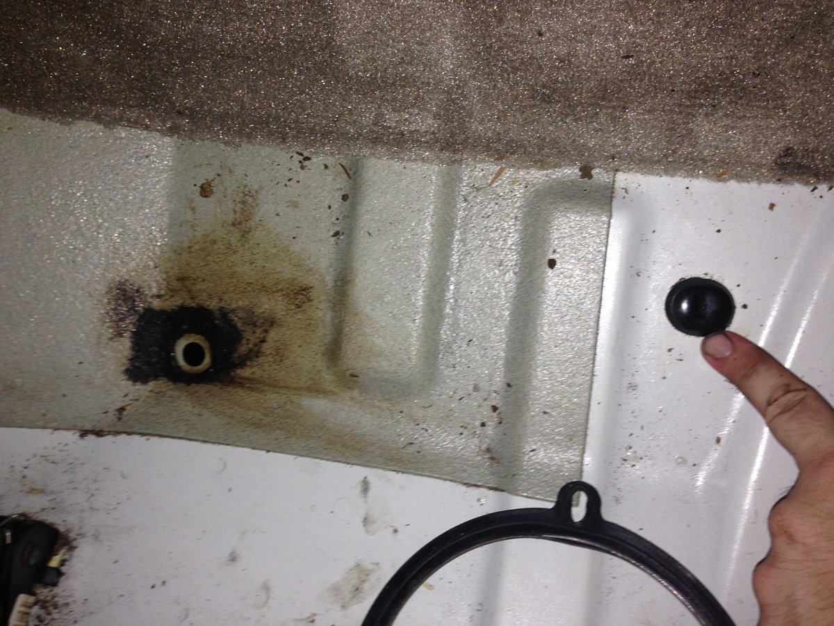

So here is my question. I already ordered the fuel pump and I am just waiting on that to come in. My question is in the first photo. The gunk covered hole that I am assuming goes into that gas tank. When I lifted up the seats it was just as you see it in the photo. Should I plug this before I put it back together or is this a breather hole? Also if anyone has any tips or heads up before I remove the pump please let me know.

It's your fuel pump housing that is leaking....not the fuel pump itself.The fuel pump housing needs to be replaced.
I have seen this on '01 V70...it had the same leak like you have.
