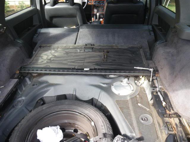

3. Remove the floor board to open up the area to access the top of the fuel pump and sender.

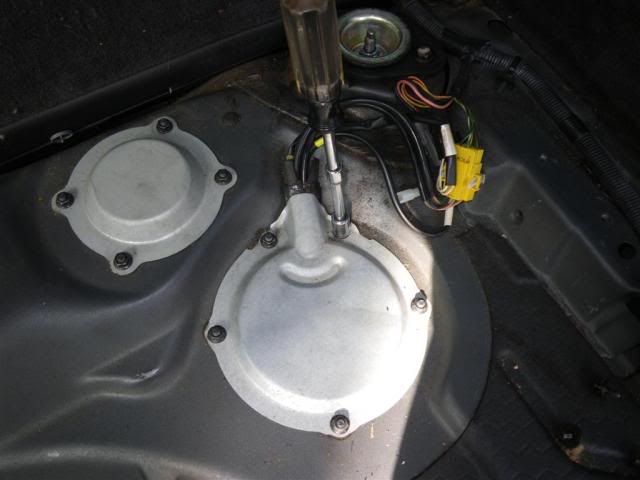

4. Unbolt the cover over the fuel pump and sender. Unhook the electrical connectors so they can go through the hole when dropping the tank.

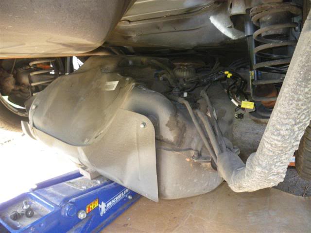

6. Line up a floor jack to support the gas tank when you unbolt the supports. There are 3 bolts that hold up the metal band supports. Unbolt them and use your floor jack to slowly lower the tank while guiding the fuel filler tube as you slowly lower the tank. Move the metal bands out of the way and lower the tank. Make sure your electrical connectors come through the holes without getting hung up.

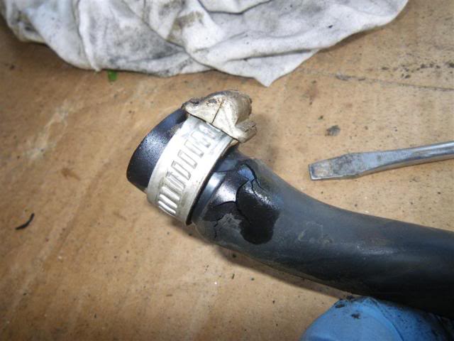

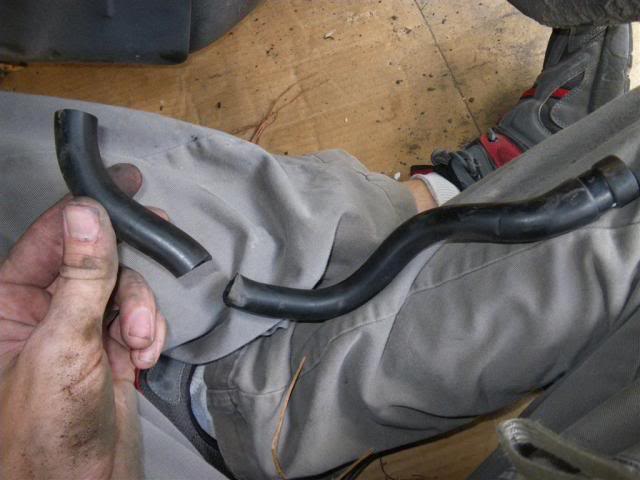

IMGP4197Large.JPGIMGP4197Large.JPG (51.22 KiB) Viewed 10058 timesIMGP4199Large.JPGIMGP4199Large.JPG (38.6 KiB) Viewed 10058 times8. The Cracked hose. It just poured fuel out when the tank got full.
IMGP4200Large.JPGIMGP4200Large.JPG (44.21 KiB) Viewed 10058 timesIMGP4203Large.JPGIMGP4203Large.JPG (40.35 KiB) Viewed 10058 times

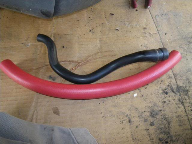

9. This is where I noticed my hose was different than the volvospeed.com post. I had a molded rubber hose that had ends with different sizes. I got some 3/4 inch fuel hose that would fit on the tank vent hole end. I cut out a good section of the original hose and slid the 3/4 hose over this, used a little JB Weld to seal the end, added a hose clamp and put ‘er back in place. So far this has worked. However I noticed I cannot use the fuel pump at full speed due to fuel backing up.
