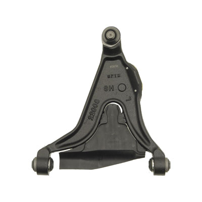

I know the earlier 850's had a replaceable ball joint, mounted via a line of three bolts. Later models have the ball joint pressed into the casting. Is that latter version easily replaceable as well? Do you know where to buy the joint only?[/quote]
Most parts stores should be able to source the ball joint with the bolts separately. I know Oreilly and Autozone both carry ones for mine.
The ones with the pressed in ball joint, the ball joint is not replaceable seperately that I know of. In the case of the pressed in ones you have to replace the whole arm.
