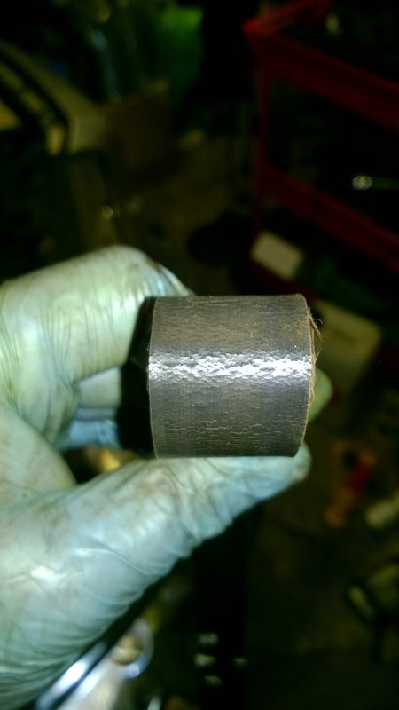

I used the ‘can’t get it wrong’ technique of marking the pulleys and the old belt and then transferred the marks to the new belt. I fitted the new tensioner and idler, however when I fitted the new belt the camshaft pulleys wouldn’t align. After a bit of how on earth can this happen, I put the old belt back on it was then I found that the exhaust pulley had rotated one tooth out. Sorted this and bolted it all together and set the tension, all good. Then I had a good fight getting the aux belt on whilst trying to move the auto tensioner out of the way. Job all done and it was only 11:30pm and I had to get up at 5am the next morning. Looks like the old belt was the original
