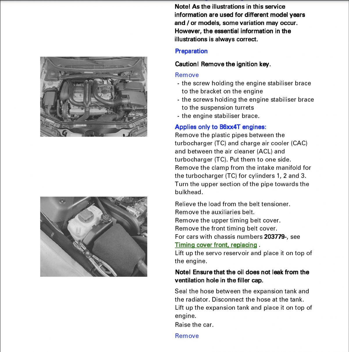

I am half way into removing everything for my 2008 Volvo S-80 3.2 yet need to get some sort of Repair Manual to help me with the remaining questions I have. Maybe a PDF online of this year, make and model. I can’t seem to even get the Serpentine Belt off without having to remove so much more, A/C compressor bracket & Power Steers Unit I think ?
Has anyone done this job and have any advice for me. I am looking forward to taking on this project but need to make sure that I do it correctly. Also, are there special tool(s) needed ? Thanks for the replies.
